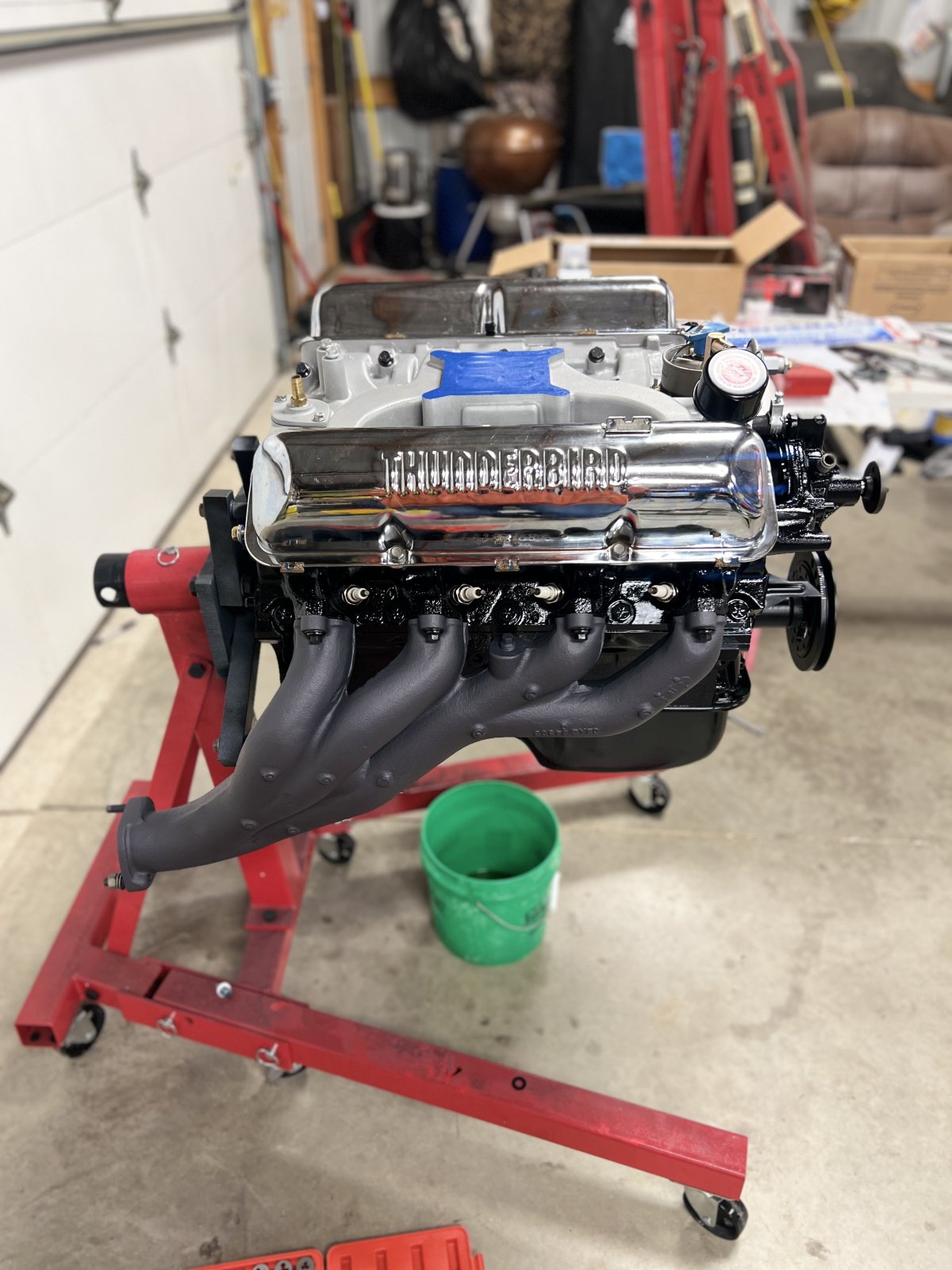

    So I’ve been searching the internet for a few days too no end on some info about Autolite carburetors…. I’m looking to put an autolite 4100 but stumped on the correct one. 64 galaxie 390 z code 4 speed top loader. I have a c4af dj that I picked up but I feel it came off a mustang! As far as I’ve found the carb part # was on the mustang with a 289 and the galaxie 390. What’s would the difference be between the two? Any info for a young pup would be greatly helpful because I’m driving myself nuts. Thanks in advance

    I have a Holley street advenger on it now. Just wanting something more original. The Venturi is a 1.12

    I thought that the 289 carburetors had 1.08 inch venturis. This is a 1.12 carburetor.
    Blownsmlblok likes this.
  13. 289 engines (except for HP) did use the 1.08 venturi carbs. That carb was also used on special model larger motors. The 1.12 pictured (C4AF) is a 64 manual shift carb. The 64 Galaxie also had a spacer plate under it with heater hose connections.

    Ok cool then it should work out. I got it stripped down and waiting on jets and the rebuild kit. The spacer I have has the pcv hookup on the back side towards the firewall. I also have an early 60s aluminum intake on it now also a set of the cast longtubes.

    Blownsmlblok, are those C-5 cast iron exhaust manifolds? I tried to bring the picture up, but it blurs out on me!

    C3AE

  24. I can't remember if the spacer had the pcv port in the center of the back or not. The heater hose connections were on the passenger corner front and back of the spacer. I have always had a fondness of the 64. and had 9 of them over the years. Nice looking FE.

    Engine is looking great . They don’t get any better !
