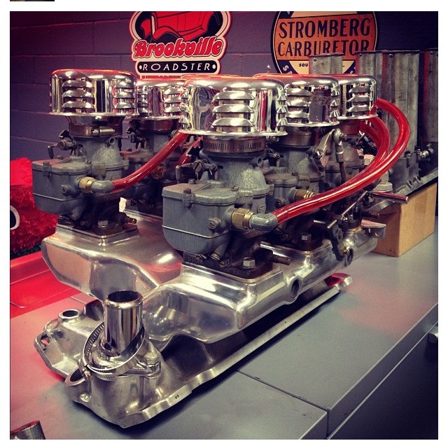

  16. very jealous!! love the intake and carb setup

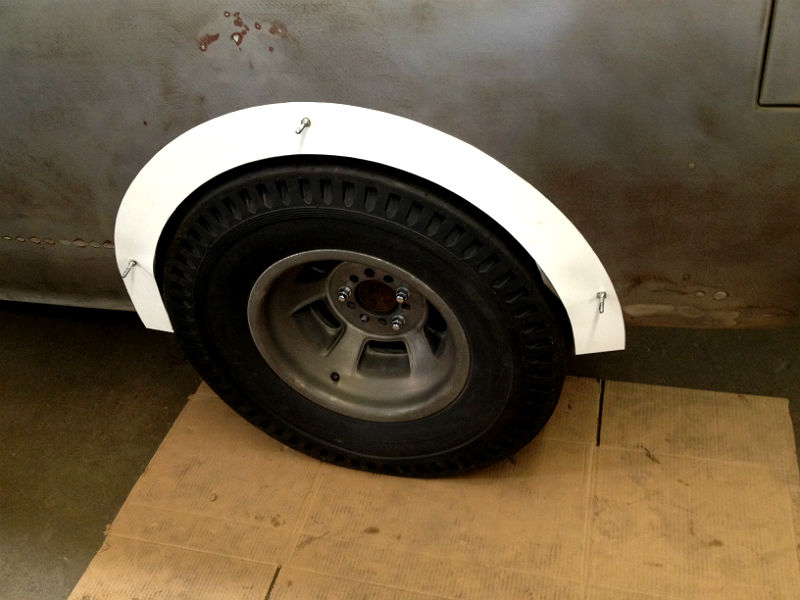

    Tried out some wheel well edges the other day. Here is a brief process.

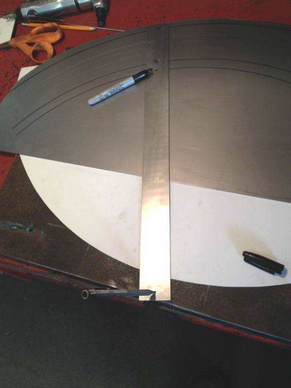

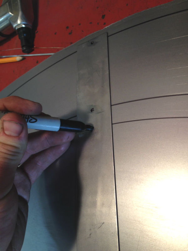

    Made a paper template by laying out the radius on some paper and cutting it out. The i used magnets to hold it on the car to see if it is awesome or not.
    Used my handy radius maker that i used to make template on paper. basically i have this piece of 1/2 plate i use for welding. I drilled a pilot hole as a pivot point. Then took a piece of scrap and measured my radius which was 15.5" made pivot hole and marker hole, I also made a hole for the inside flange material which is 3/4" Then I made another hole which is the extra 3" of material.. Got it? No? Here's a picture
    You can use this method to make circles, pizza slices, pie charts, overhead pictures of pie, 2d drawings of planets... etc

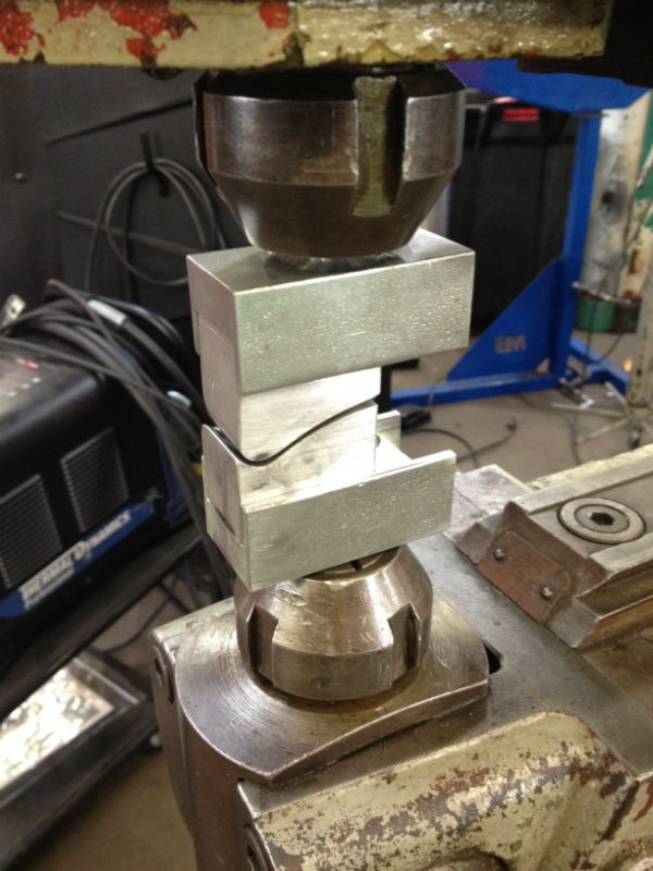

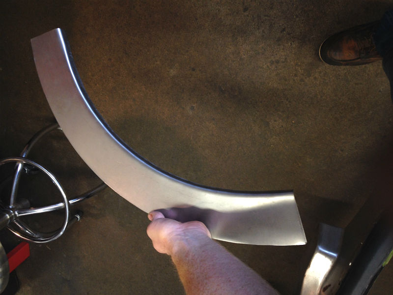

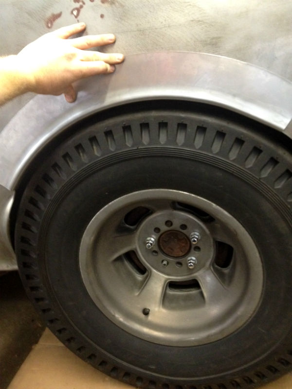

    Then I ran this through our Lazze Bead roller using the dies setup for "tipping" which after a few passes made a 90" flange. It's a 2 hand job and we are a busy shop so no pictures of that but here is the flange.
    Then I used out pull max and this die that Jesse Miller and I made out of aluminum. Normally with this die holder you would use Delrin, but we had aluminum... Now there are a few things I would have done different making this die which I am not going to geek out on now.. but it worked great.

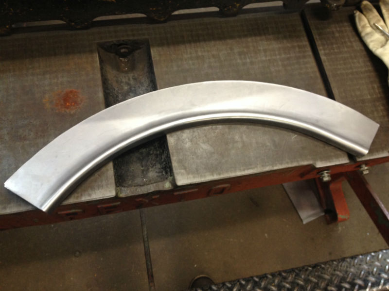

    Now lets check her out.
    Needs some tuning up but its bitchen:D I am making it in a few pieces because the lowers have to roll in to match the conture of the quarter..
    Sorry for the slow posting, I have to transfer pics from my phone to a PC then resize and post so I will get to this when I can, as often as I can.
    Kail
  27. Very nice work! Thanks for taking the time to post this all up for us to drool over.
  28. powrshftr
    Joined: Mar 29, 2013
    Posts: 4,543
    powrshftr
    That is some REALLY nice work and attention to detail right there!
    Scott
  29. AHotRod
    Joined: Jul 27, 2001
    Posts: 12,217
    AHotRod
    Those wheel edges look really good.
