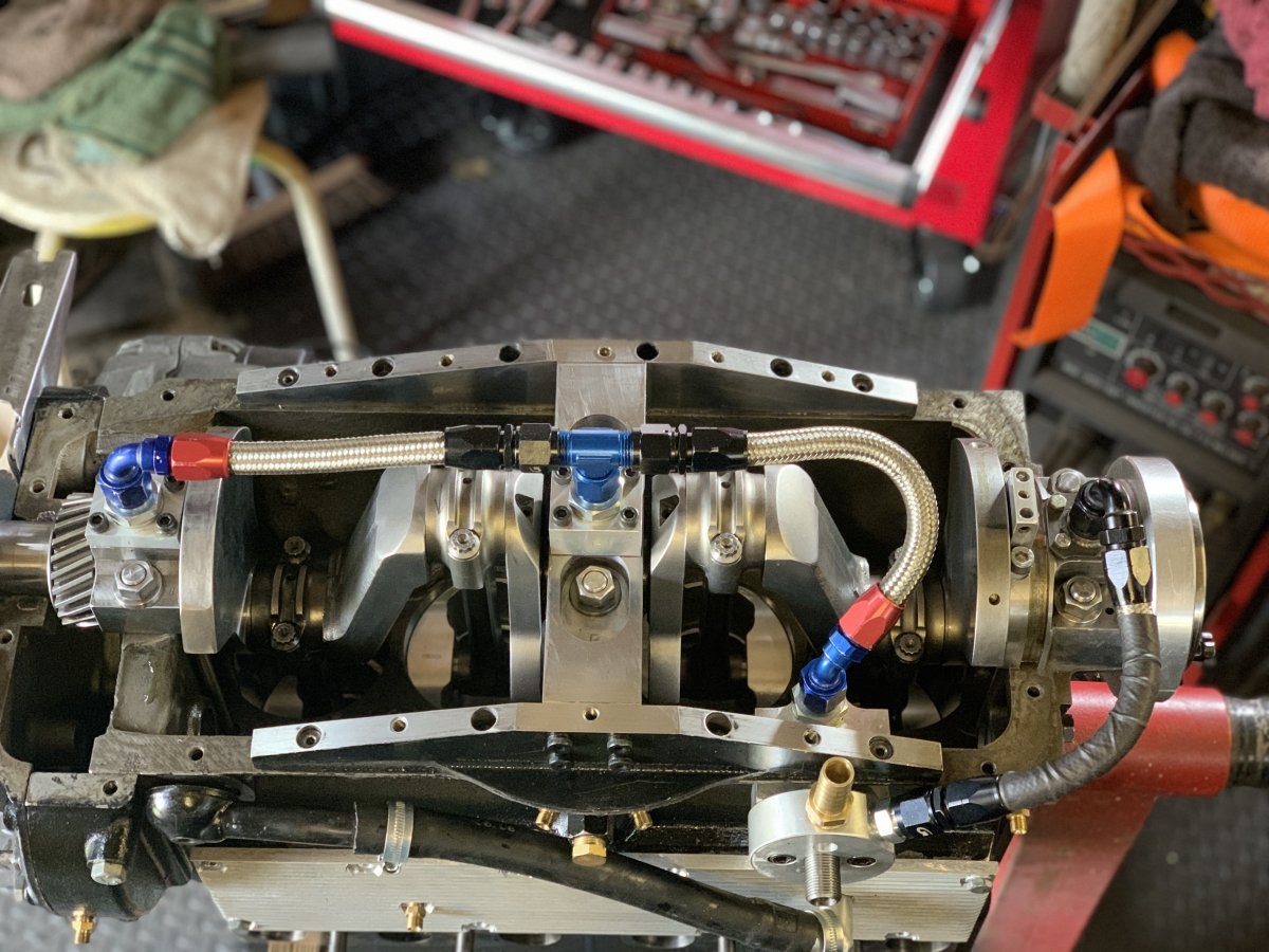

  3. Do my eyes deceive, or does that girdle add to the stroke of the engine? How Big IS that "Banger"?
    I've got near 13 to 1 with a graphite/steel head gasket! But it's on a Miller/CRAGAR OHV! I tried a sandwiched copper gasket I got from Dan Price. It didn't last more than a couple of hours! Though it was torqued too much. A "Doofus" ignored my admonition; and gave it 70 foot/pounds! I had told 50. nor more than 57 ft/ibs.! Solid copper (which I couldn't find) would have held that much force!
  4. An ideal head gasket would be outta the same material and way that Cometic makes theirs! But, alas we have to do with what we CAN get! I've got Cometics on a '70 "Jimmy SBC 360 with a converted Detroit V670 supercharger and haven't blown a gasket since.
  5. John,
    no the girdle sets the crank in the stock location, vintage rules do not allow moving it more than .125 from stock location. The model "A" "B" motor was never made to handle any compression, the deck is weak and thin.
    I run copper orings and solid copper gaskets or no gasket. tork to 55 ft/lbs and use ARP studs.
    Pete's center main support is pretty cool, I am just not convinced the crank isn't the weak link.
    John

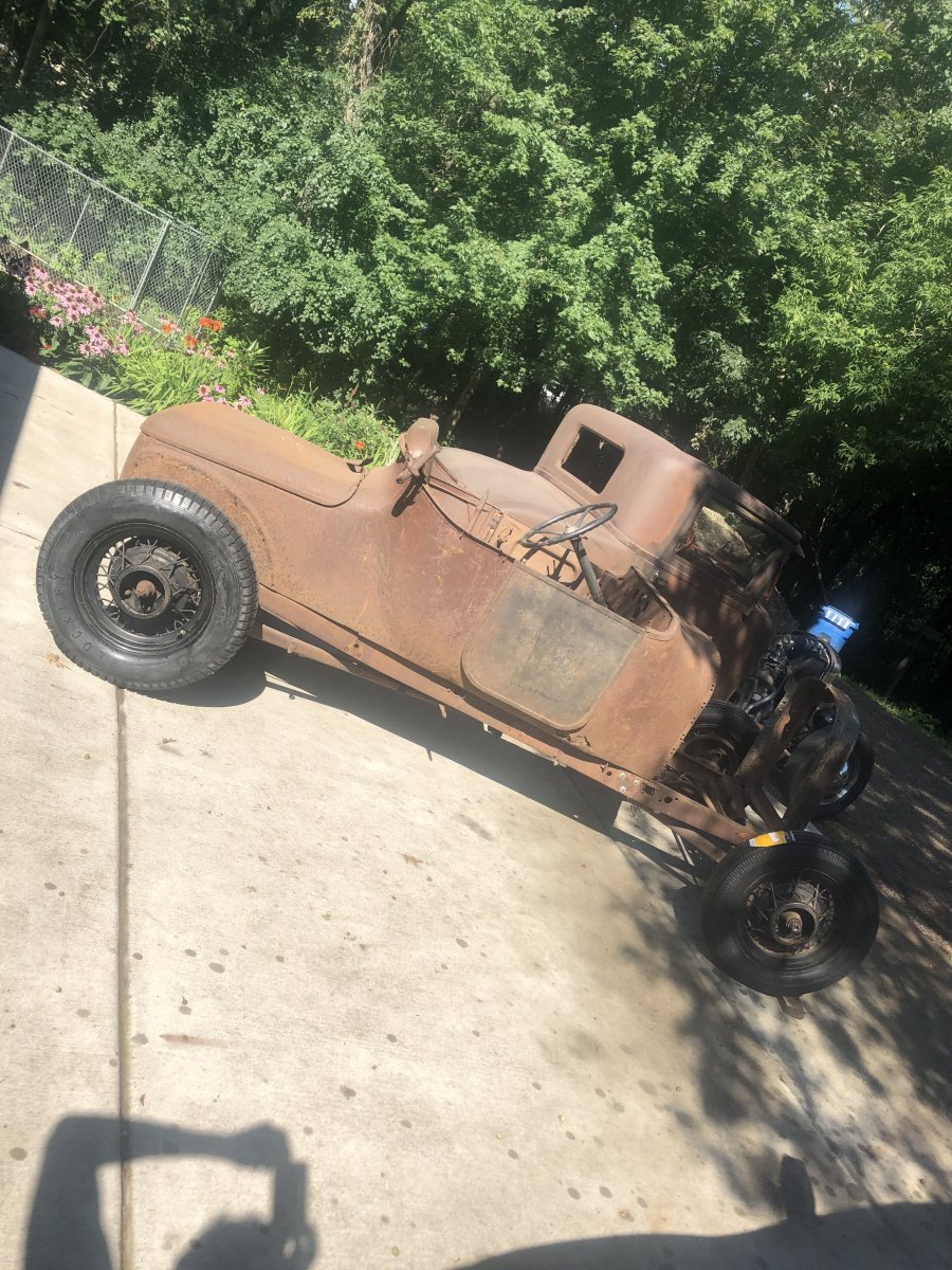

  6. burl
    Joined: Nov 28, 2007
    Posts: 843
    burl
    from Minnesota
    Checking in for the month started making some progress on my db roadster db roadster.jpg

    rottenleonard
    Where does the crank come from? Are you fabricating it? or is it from another application?
  11. Crank is billet build from SCAT or Velasco
    It is not for the faint hearted
    J
    Crazydaddyo likes this.
  12. Yup! After my post I figured it out. I agree! That center main; and in fact the whole girdle is unique! With all that; that motor will rev up really quick with the less parasitic drag of two more mains! However the harmonics that manifest themselves near the rear main of a four-banger's crank are still to be dealt with! "Been there; Done that!"

  14. John,
    yes Crower made the crank for the Donovan motors, very nice pieces.
    The problem, as I see it is that the 3 bearing layout (bearings) leads to the failure, small diameter and long.
    With the limited mods allowed in the block another solution must be found.
    The "C" cranks break off the flywheel flange without the welded seal modification.
    Some people have had really good luck with the harmonic balancers, not so much here, if it works use it.
    I really like seeing the innovation and solutions that people come up with, especially when the machining is done properly. Well done, Pete.

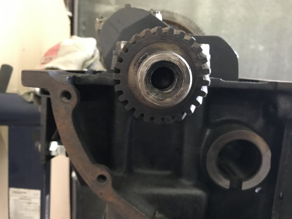

  20. Mikko_
    Joined: Aug 3, 2018
    Posts: 455
    Mikko_
    from Sweden
    I'm about to install the camshaft in my B-engine, I have located a dimple on the camshaft timing gear but can't find a matching mark on the crankshaft.
    Any ideas on how to get it right?
  21. Mikko,
    I think the gear is installed backwards, look on the other side.
    But, the timing mark is the tooth that is directly in line with the key in the gear.
    Because the gear is helical, the face of the tooth is the one on the right hand side.
    The helical tooth in the center of the gear, follow it to face.
    John
    Mikko_ and winduptoy like this.
