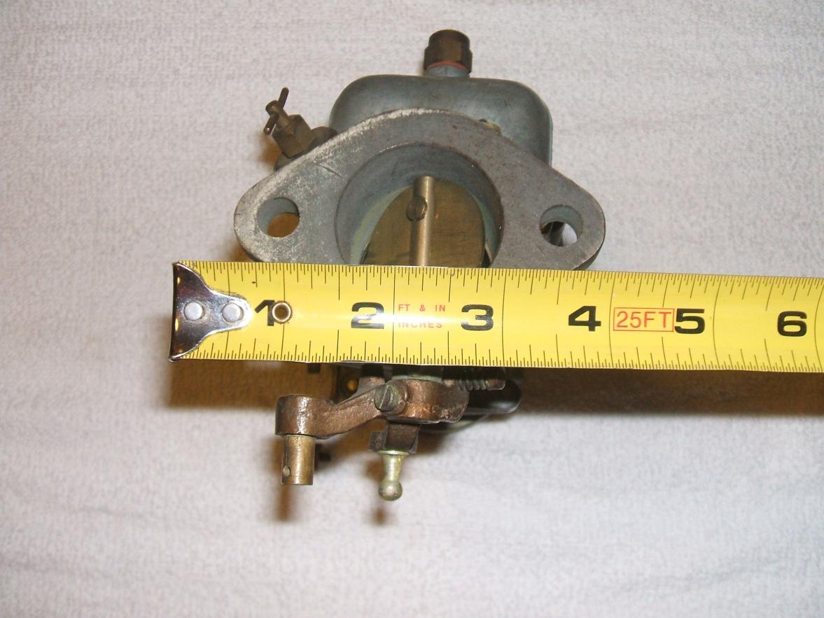

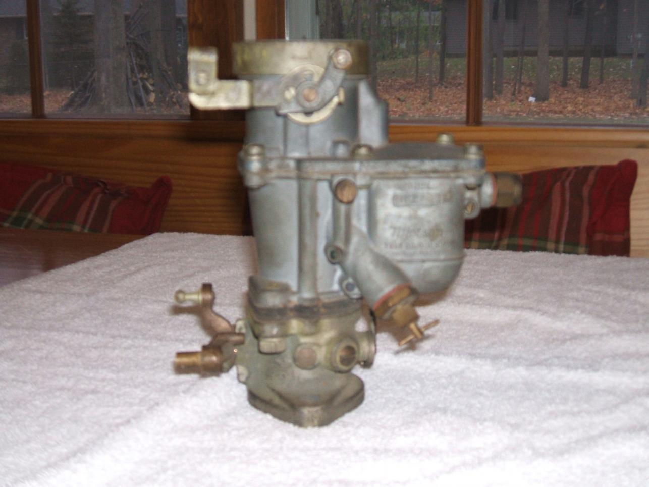

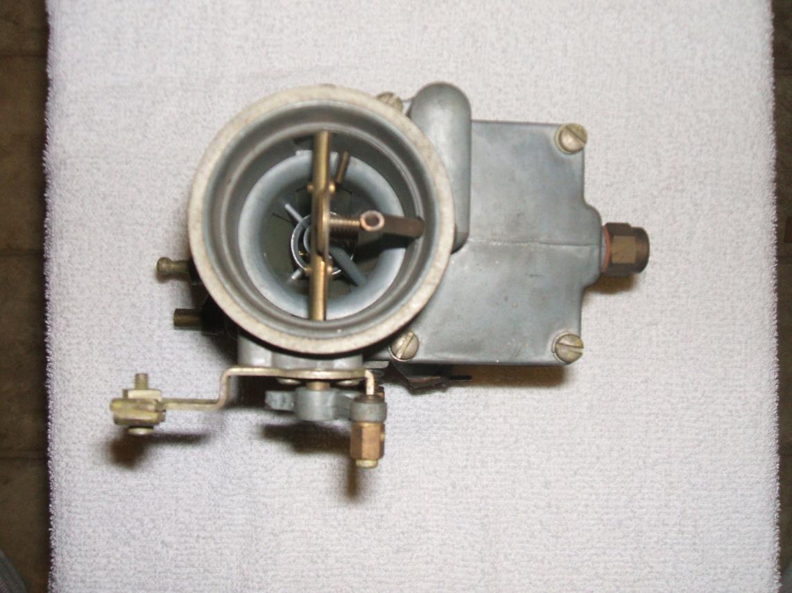

    I was at a auction this last weekend and bought a box of junk for ten bucks. In the box was this Tillotson Carb Model UR2 The bottom part has the part number 05382 I don't believe that this carb has ever been on a engine. Any body know what engine this goes on?? Any help would be greatly appreciated. Thanks much, Hickory

    Looks like tillptson makes carbs for Ski-Doos, Arctic Cats, weed wackers, etc....
    I'd bet money its built for a 2-stroke motor, but damn it looks cool. Is it a CV style carb? I love those things!!!!
  3. Clark
    Joined: Jan 14, 2001
    Posts: 5,130
    Clark
    I'm pretty sure it's an aftermarket replacement for your typical 1 barrel carb. They made a version to replace 97's and other ford 3 bolt carbs too....very cool!

    thats no 2 stroke carb look at he size of the ball the throttle would hook to it looks more tractor just a large down draft carb

    Looks just like the (aftermarket) replacement carb for early Chevy. A buddy had one on his '50 (replaced either a Carter or a Rochster). He liked it because it had an adjustable main jet.
  6. Tillotsons are great carbs I have 6 sidedrafts on mine. I think the replacement idea is right. it is definatley not the 2 stroke variety

    This carb, along with the Model A ones, represents about the last T carb made for cars. It was actually available for quite a number of 6-cyl applications.

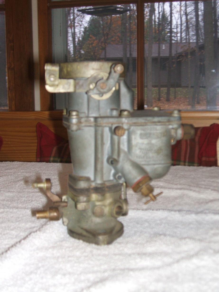

    Would this be good for a Ford Falcon inline 6? Heres a couple more.

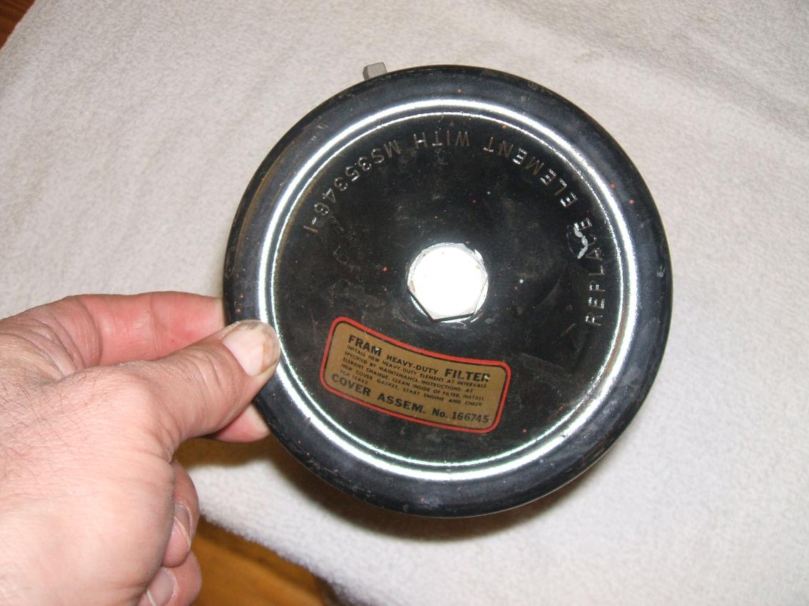

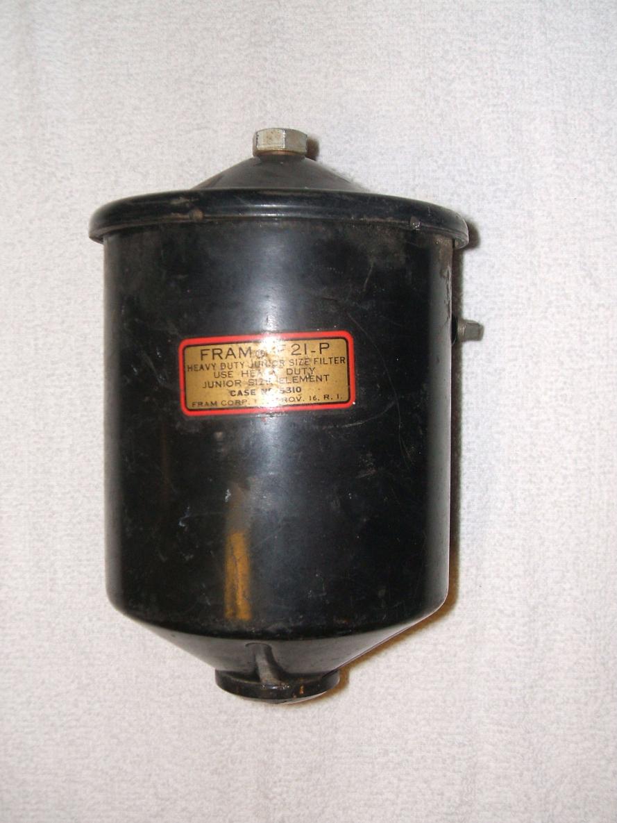

    This was also in the same box. It says, Fram F21-P I have seen these on a couple of cars with flat heads? Is this something I could use on a Rod? Any help would be greatly appreciated. Thanks, Hickory

    That's an oil filter, looks like the one used on early gm. It's not a great filter, but they look cool. If it was in the same box, it tells me the carb was probably for the same car, cool find.

    I suspect that will go on a Falcon with adaptation of linkage as needed, probably a simple spacer as the studs are probably wider spaced...
    Probably a good choice UNLESS you need parts. I don't think that carb had any OEM use, though I may be wrong...I have a Tillotson catalog somewhere.
    I would disassemble it VERY carefully, soaking gaskets in oil first. Gaskets might be reusable, and at least need to come off intact enough to be copied. With luck, you might be able to take it apart, clean, and reassemble without needing any unobtainables.

    This is a brand spanking new carb. I'm sure it's never been installed. Same goes for they oil filter. I may put a inline Ford in my T-bucket. Maybe it would look good on that?

    But, just because it looks new I suggest you check out the innerds. Just this year I put on a "new rebuilt" on a motor and cranked it up. I shut the motor down because it was running real rich. When I looked into the carb fuel was spraying down into the hot intake manifold. Big cloud of fuel vapor, could have been a BIG fire....................When I took the top off I found the float bowl was clear full and the needle valve seat gasket was missing and seat wasnt tightened down.
