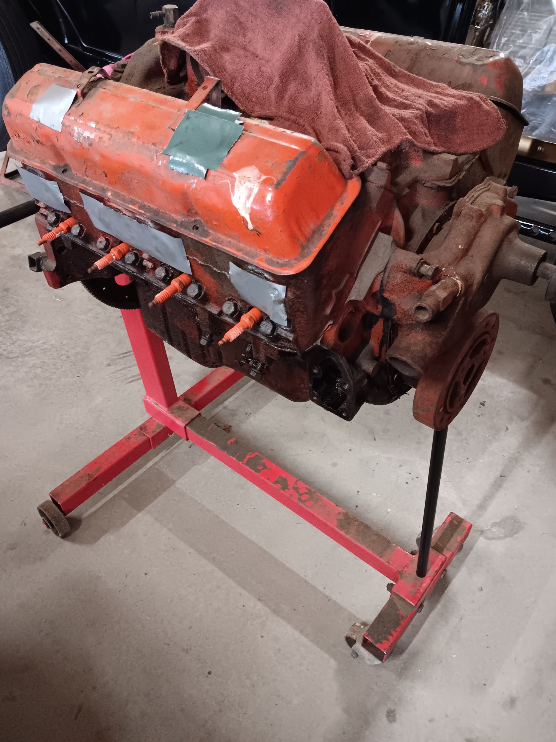

    I had picked up a 66 283 just before the medical delay so I have been doing small stuff like cleaning small parts and just about everything that does not require any lifting over the 10 lb. limit. It had been freshened up prior to an accident which totaled the vehicle. Very clean on the inside and no ridge in the cylinders to speak of. Put a new double roller on it and a newer oil pan since the original was not repairable. Got to tack the oil pickup on and will button this up with the help of my neighbor to do all the heavy lifting and crap I can't do. Have no plans for it at the moment. Just felt the 283's are getting scarce so I will keep it in storage for another day and it gives me something to do while under the watchful eye of you know who:rolleyes:.
