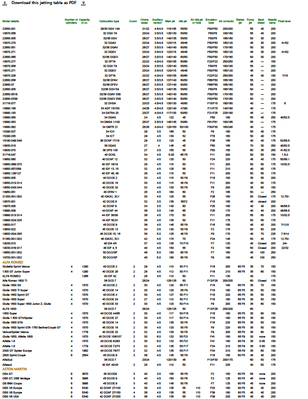

  20. Use this chart to compare cubic inches to your engine to find a starting point then use your sparkplug readings to make changes if needed. Whoops, this is just the first page, there are 6 more that will not load......

    Is there a way you can find a part on that PDF near 3300 cc or 200ci? When i look at the jets for the 32/36 DGV its much smaller all the way around than what I currently have.
