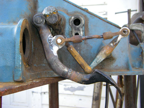

    Just a wee little update here for me...

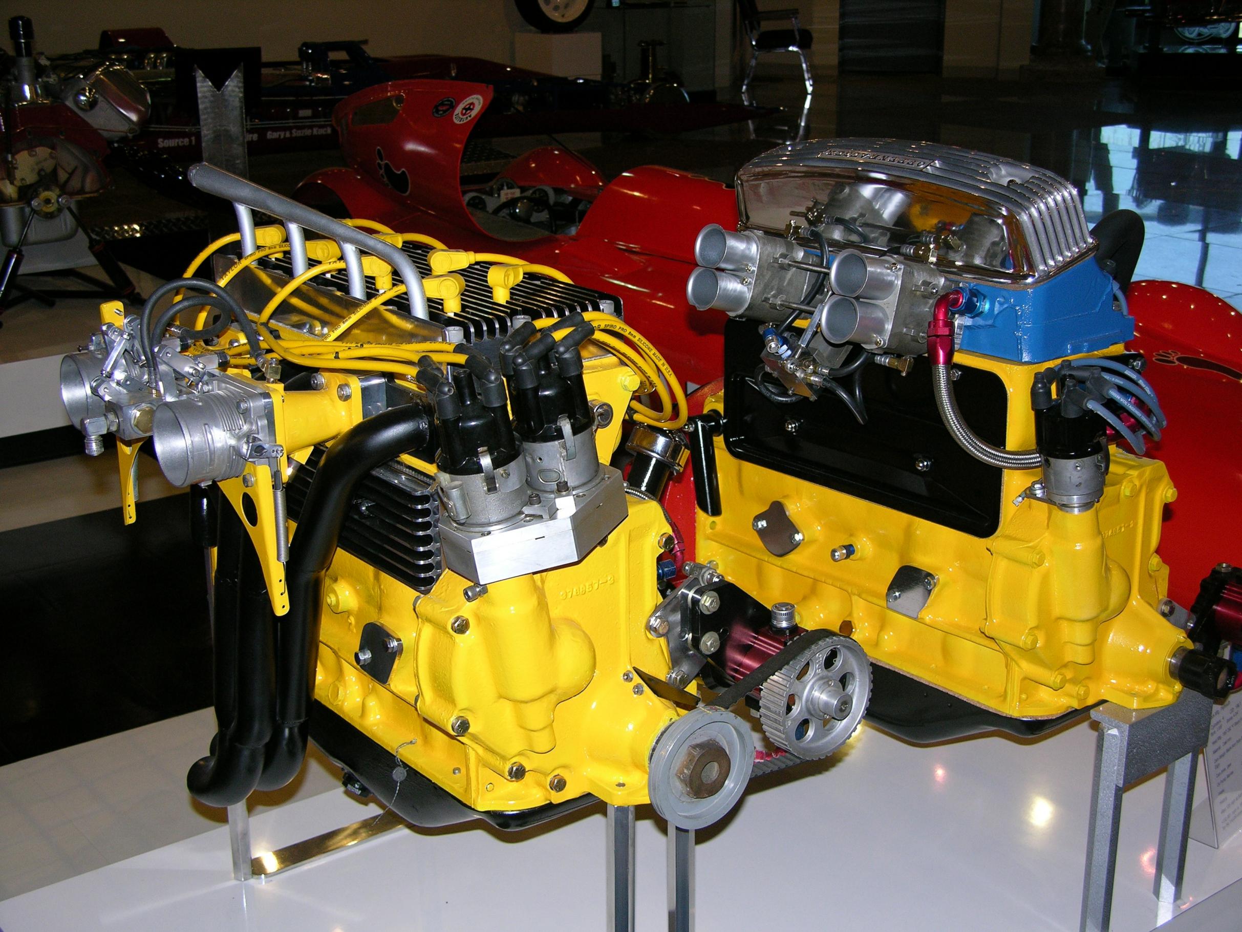

  5. V4F

  6. Dirtynails

    That will interesting...what is it supposed to do once it pulls on the last link?

    You know that I'm lovin' your project, but I just couldn't help myself when I saw your linkage:

    I'm trying for a "Hi-Low" gear setup,.... more work to be done though,.. obviously....
    feel free to throw some insight in on doing a proper "hi-low" setup. I'm in the kindergarden of some of the Model T trans stuff!!!
    Oh and the pedal coming down is not actually going to activate "reverse" it will simply be utilizing the hole left by the reverse pedal as a pivoting area. I've gone off of some notes I read and a few photos from a fellow who did a hi-low setup on a sprint car. Of course I may just not be understanding it correctly,... anything's possible!!

    The last link in the train is stopping the pedal moving. if you want it to move ,the last shaft lever must be at right angles. Try fabbing a disc with holes that will fit on the last shaft. you can then 'index' the lever to get the best motion from the pedal.

  20. CoalTownKid
    Joined: Mar 12, 2005
    Posts: 2,024
    CoalTownKid
    Oh I see where you're talking about,... there is some slop/play in this setup and the pedal came to rest at the point where you see it in the photo. Sorry, I didn't notice that when I took the photo. Its just a hog's head not hooked up or anything,... something to use to work on before doing it for good, etc.
    Yes, that arm will actually sit either straight down, or straight back (facing the rear, either one at a right angle, as needed to get movement out of it correctly. I figure to get the best motion with the least amount of fabbing (for now) I'm going to use stock clevis' so they can be adjusted to get a better amount of movement,... however, the disc with several holes is a good idea and solution. We'll see,... I'll keep that in mind when I get back to the trans this weekened.

    You guys still going to let me play: The 1 1/2 Stromberg is going on the wall, have to use the 1 3/4 Miller. The head is actually cross flow, the intake port runs through this side then across the other side. This was Wiedleys way of dealing with the bad gas of the time.
    this came in a care package (there are 2 of 'em)
