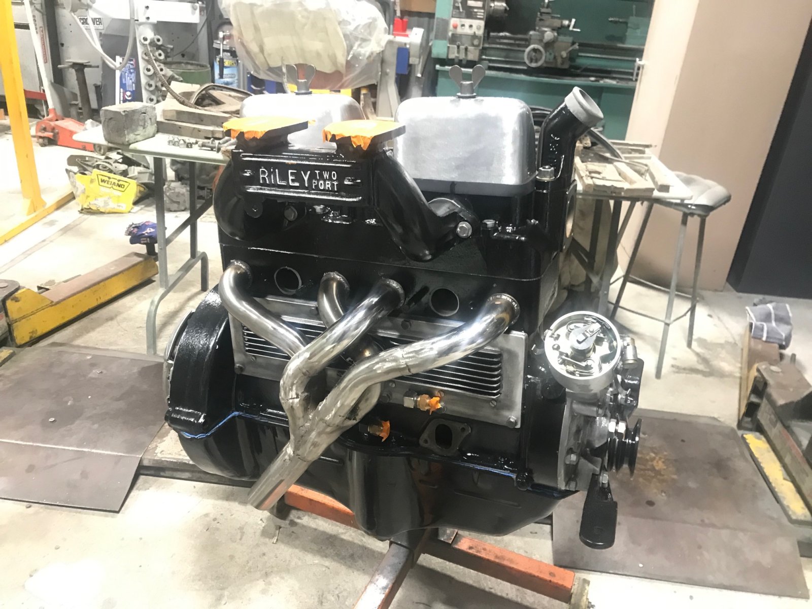

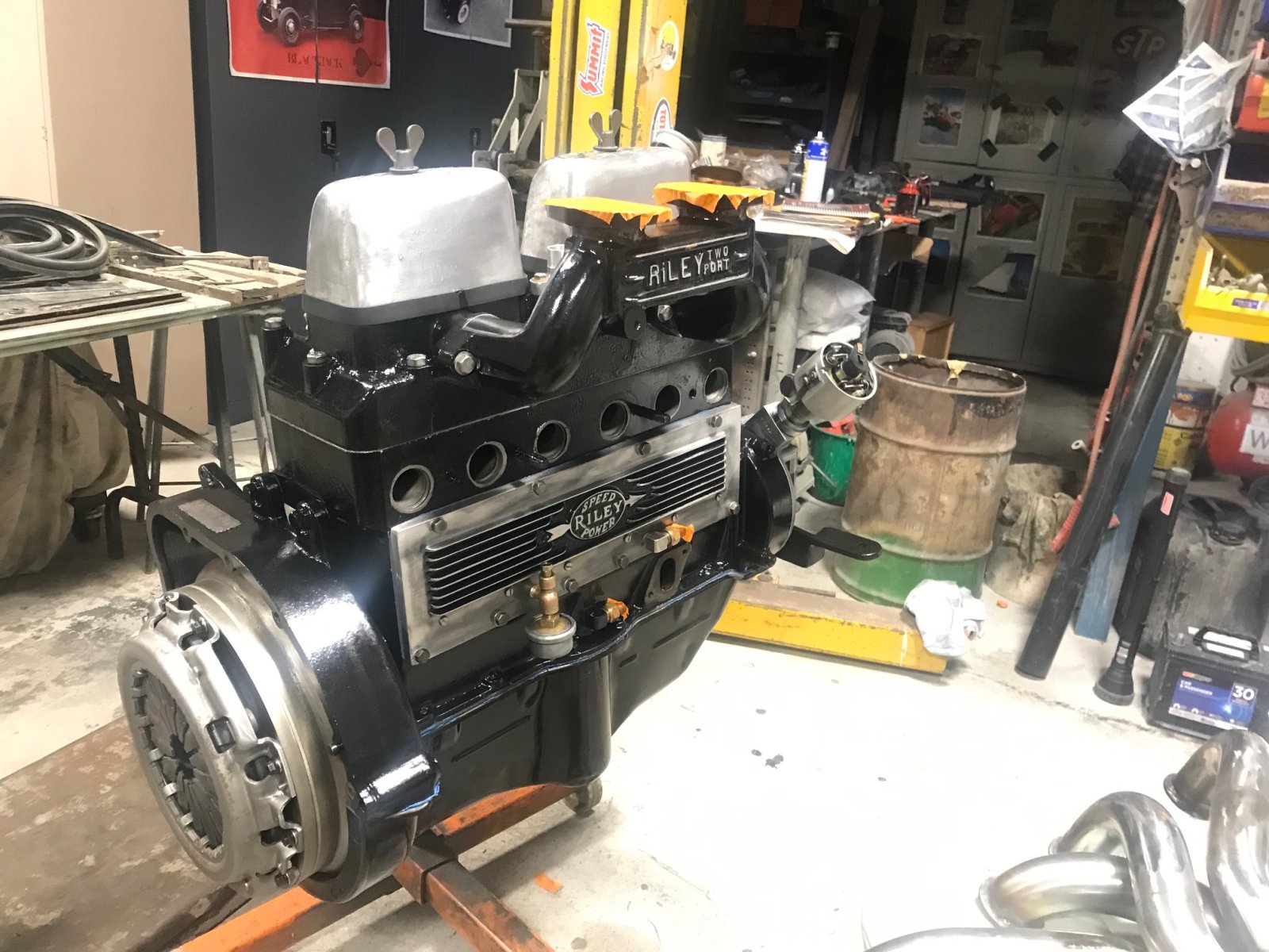

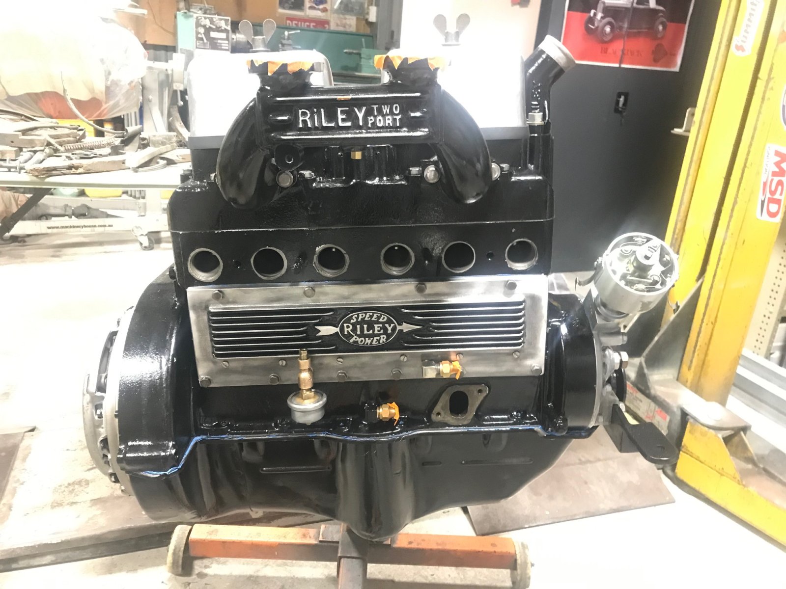

    After many years , mostly doing other stuff, I am on the home stretch. Another 12 months and it should be complete enough for test runs, Doing final assembly on the engine now.
    IMG_1338.jpg IMG_1339.jpg IMG_1451.jpg IMG_1453.jpg IMG_1455.jpg IMG_1456.jpg
    Engine all together and ready to install in the chassis

    I love seeing a Banger in a 33/4, what's the story on the Engine? Not a Jenkins by chance?

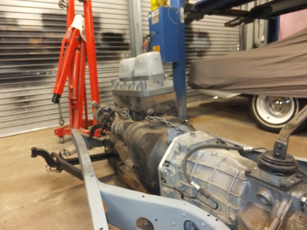

    The engine is original to the car, so it is a 33' B engine with full counter weighted crank, the head is a YAPP Riley 2 port overhead conversion, I have modified the block for full pressure oil, had the crank drilled to pressure the rod bearings and modified for insert rod and main bearings. I have adapted a Tremec TR6060 6 speed to a BB bellhousing.
    image below is from a few years ago
    40 Olds, Stovebolt, 282doorUK and 5 others like this.

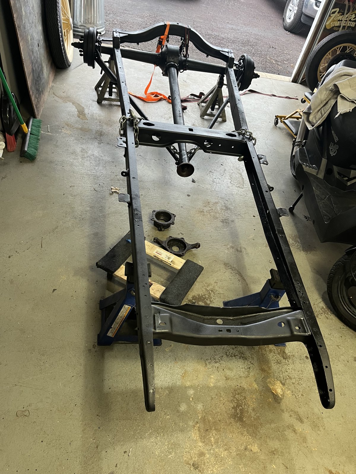

    Started throwing a car together after too much other stuff has gotten in the way.
    A frame stepped in the rear, T spring, B motor with Brierley head, 39 trans with clings adapter 32 wheels, 27 T coupe. Should be fun.
    Waiting on a 36 axle to be dropped. But OKie Joe just had surgery so it might be a few weeks.
    Going to keep mech. brakes with 32s up front. Works pretty well.

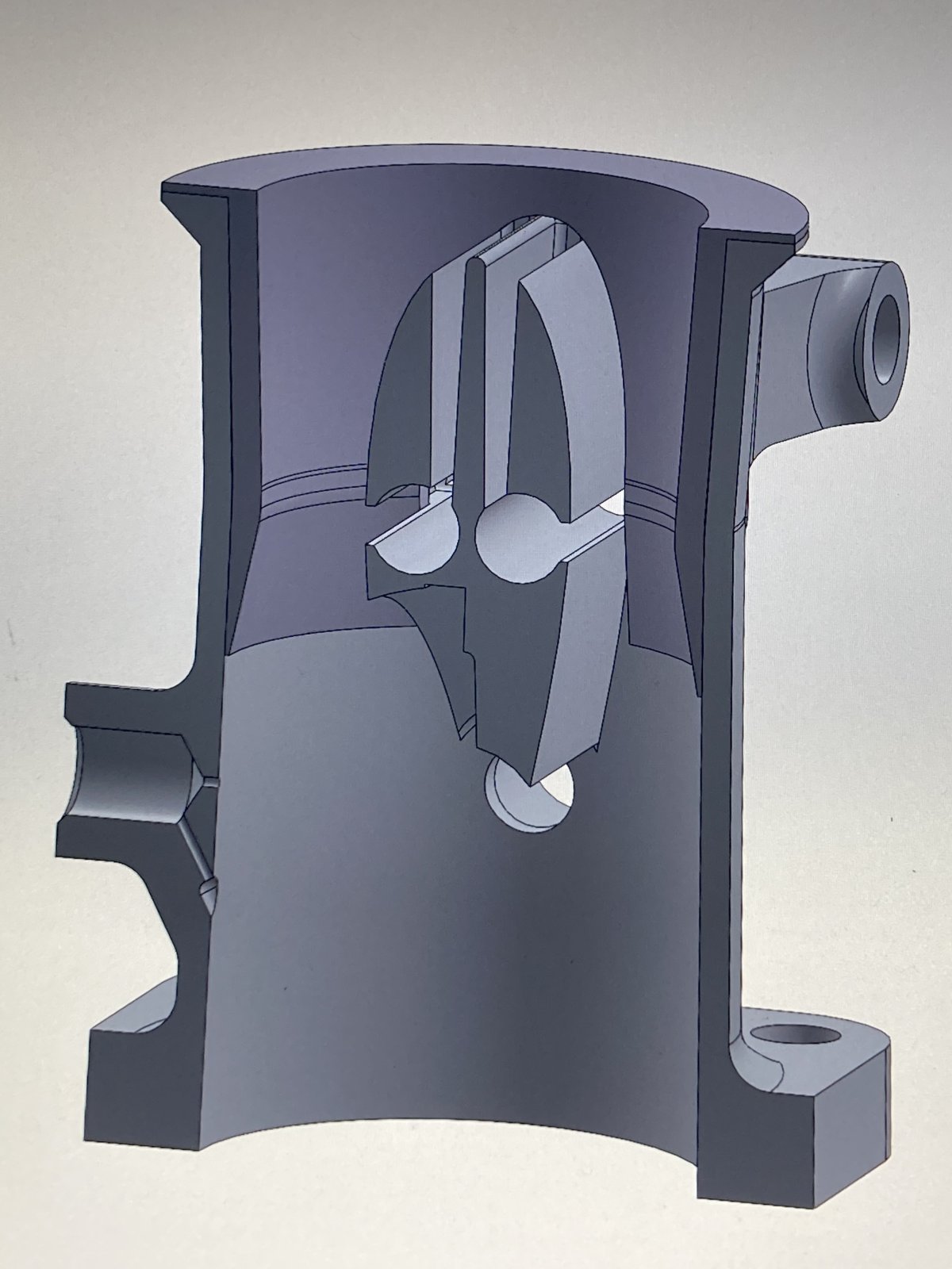

    Wuch y’all thinka my latest scheme to build a sleeve to reduce the B throttle barrel down to either A or AA (haven’t decided yet). It will disrupt the venturi to butterfly proportions, but hopefully will work OK. Now to order up that new manifold…

    @walls that looks like a really neat project, like the approach, & looking forward to seeing your approach to the brake actuator's
    @Kevin Pharis I'm not sure what I'm looking at regarding the butterfly & I'm interested in seeing how much difference there is in spite of the proportion's being out. I have lots to learn about Carburetor's
