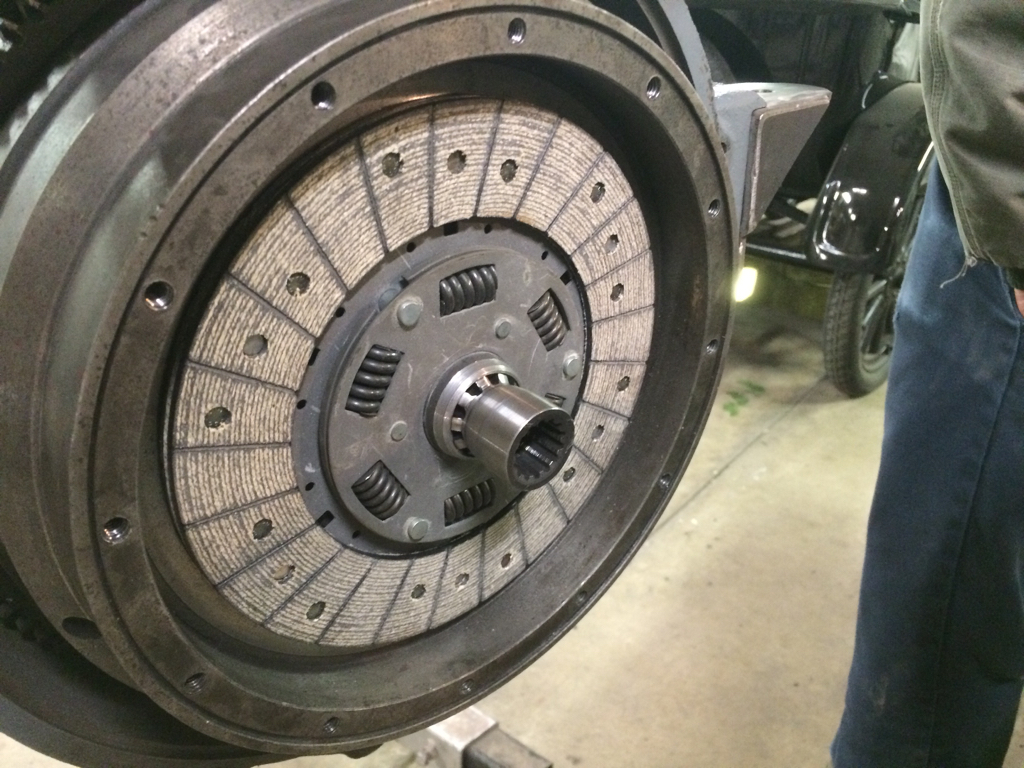

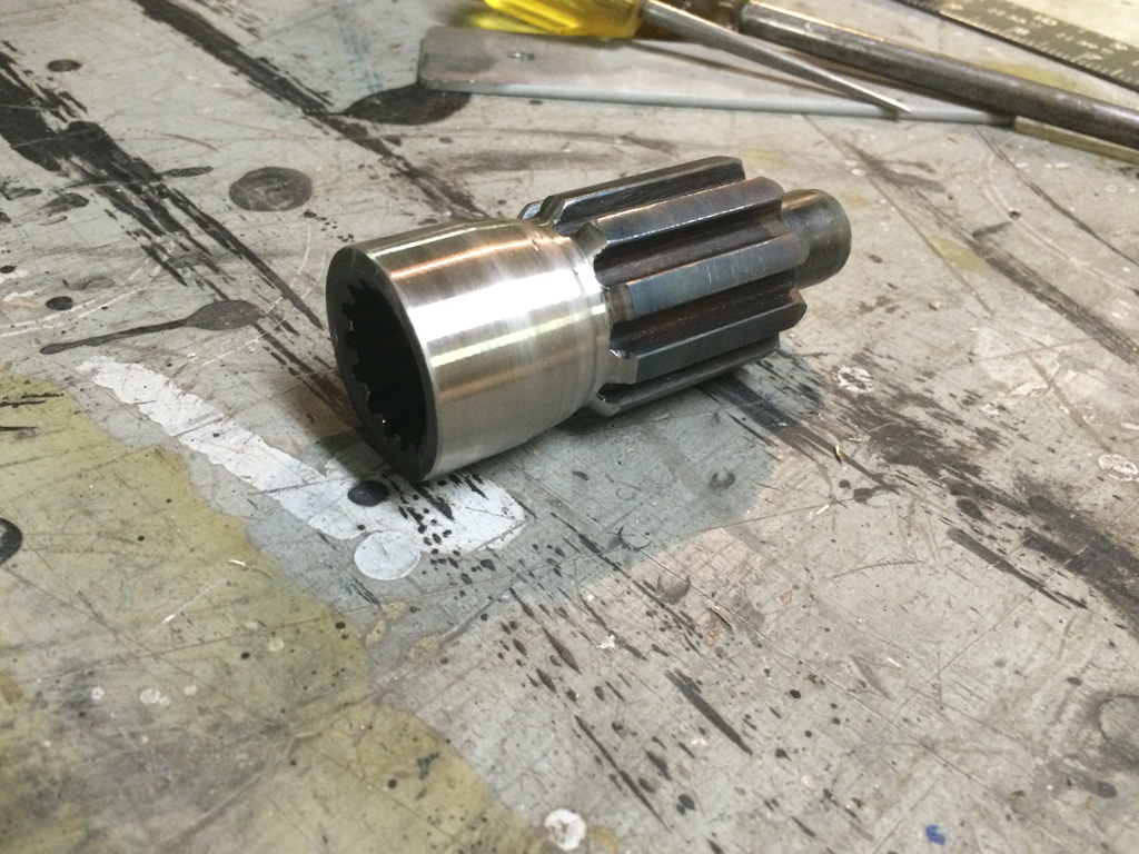

  5. Binger
    Joined: Apr 28, 2008
    Posts: 1,734
    Binger
    from wyoming
    @noboD I hope to have the bugs out of the thing to get it up to the Hotrod Hillclimb in September. I don't think I will make the trip to see them run on the salt this year. I hope to make it to watch next year. I decided to not build the car into LSR race car. I thought I would get more enjoyment out of it if it was a street car and also save me a significant amount of money on the build. Please stop through Cheyoming on your way through.
    @V4F It seems the Clutch Disc is the Hardest part of the T-5 conversion. I had a machinist friend help me build an adapter so I can run a stock clutch disc. I will see how well it works here in a few months when I get the car all together. Here is some pictures of what I had made. I feel there is a market for a good T-5 conversion for a stock A bell housing. There are open drive line conversions available but a conversion from the motor to the trans are not. I am not sure if there is a adapter for a 4WD trans to torque tube available any more either. I was lucky enough to get one of those from Crazydaddyo.

  15. @V4F It seems the Clutch Disc is the Hardest part of the T-5 conversion. I had a machinist friend help me build an adapter so I can run a stock clutch disc. I will see how well it works here in a few months when I get the car all together. Here is some pictures of what I had made. I feel there is a market for a good T-5 conversion for a stock A bell housing. There are open drive line conversions available but a conversion from the motor to the trans are not. I am not sure if there is a adapter for a 4WD trans to torque tube available any more either. I was lucky enough to get one of those from Crazydaddyo.
    View attachment 3193754 View attachment 3193755 [/QUOTE]
    Now that is very cool!
    What are the details?
    Mated up, welded and turned down?
    Seems cutting external and broaching internal splines would skyrocket costs. Very nice, regardless!
  16. Binger
    Posts: 1,734
    Binger
    from wyoming
    Seems cutting external and broaching internal splines would skyrocket costs. Very nice, regardless![/QUOTE]
    I used a center section out of a new Speedway T-5 disc that was turned down and sacrificed an input shaft from a stock transmission. They were mated up welded and turned down. My only hope is that it is strong enough. I don't have the car together yet to try it out. hoping by July

    I used a center section out of a new Speedway T-5 disc that was turned down and sacrificed an input shaft from a stock transmission. They were mated up welded and turned down. My only hope is that it is strong enough. I don't have the car together yet to try it out. hoping by July[/QUOTE]
    OR you could just but a Macsspeed bellhousing ( Graeme McNeill) . The bellhousing has the wishbone mount cast into the bottom just like original, and it has the pedal mount for original pedals. It is also delivered with a new clutch release shaft and fork which works for both left and right hand drive ( shaft comes undrilled so you can drill and pin it to suit your own setup.
    He makes two different T5 to Model A bellhousings , for Ford or GM gearboxes with a 6.5" input shaft.
    The T5 trans bolts on directly with no adapter plate, no machining and can use the original Ford pressure plate or a T5 one Graeme sells a T5 original clutch disc with modifications on the flywheel side which clears the flywheel bolts . The pilot bearing is replaced with a sintered bronze bush (GM part) but the bellhousing places the input shaft in the correct place for the 6.5 " input shaft so no special extended shaft/clutch disc is needed the longer input shafts can have a short piece sliced off the front . The original Model A release bearing carrier is bored and bushed to fit the T5 bearing carrier used with the Ford pressure plate or if you want to use a diaphragm clutch Graeme also has a newly cast bearing carrier which mates the round face bearing to the Ford release fork and fits directly to the T5.
    http://www.macsspeed.com/index.php/.../model-a-b-ford-adaptor-lh-or-rh-drive-detail
    http://www.macsspeed.com/index.php/...um-castings/model-a-b-gearbox-adapters-detail
    OK they are made in New Zealand, but the exchange rate means the price is right, even with freight to the US they are less than the NZ $ price.
