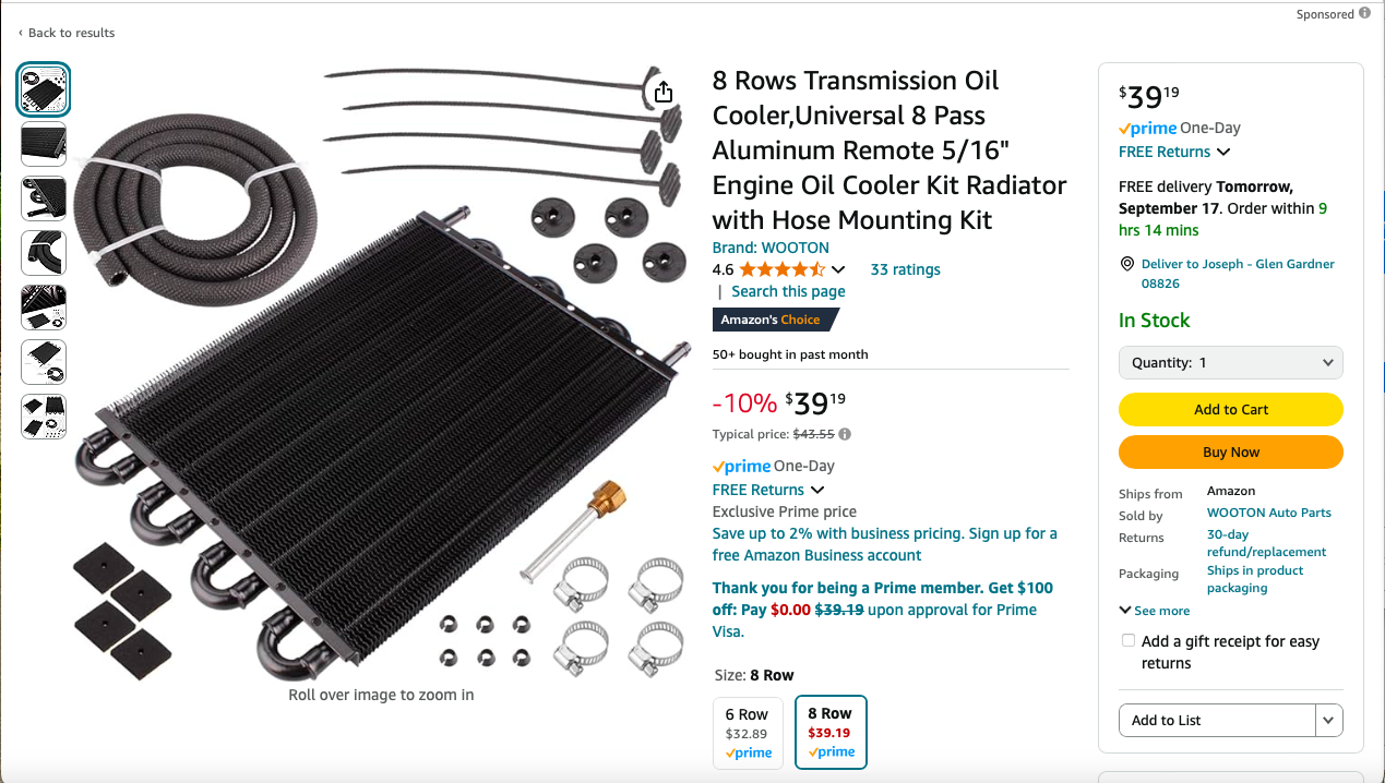

    Respectfully, no way is a finned pan a cheaper or better option than an actual transmission cooler or heat exchanger.
    For $40 and free Prime shipping, you've got most of the job completed. All you need now are just 2 sticks of NiCu tubing from the local auto parts store and a couple brass plumbing fittings from the hardware store and you're golden.
    As for the finned pan, there are several points to address. The internet, including the HAMB, is rife with articles showing that they don't do much of anything. In fact, it is arguable that any reduction in heat in the fluid is more attributable to the increased fluid capacity rather than any cooling effect by the finned pan itself. The transmission pan is not in an area where there is going to be optimal air flow to provide a cooling effect, of whatever that may be, and will provide no cooling at low/idle speed. A cooler, either on the radiator or in the radiator, is going to get some air flow simply due to the engine's fan, if not from air entering the grill at speed.
    The pan also doesn't negate the cost of lines and fittings (to a point), because even if you ran an AOD with no cooler at all, you'd still need to loop the inlet and outlet. The lines are a send and return, you can't just plug them or you'll burn the trans up.

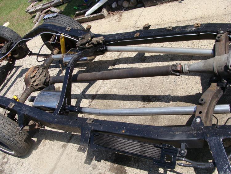

  14. IMG_2299.JPG IMG_2299.JPG For your application, it may only require the radiator cooler. If you are going to tow something, add a cooler. On my '29 AA I'm using a Champion aluminum radiator with a cooler in the lower tank, then running it to a large Mishimoto 13-row stacked cooler located just inside the passenger-side frame rail because I'm building the 351/AOD to tackle any towing. It has a 1960 F-350 dually rear axle so I thought I should be serious about ensuring that the transmission won't overheat. Am I overdoing it? Not my concern, nor am I concerned about cooking the trans fluid. EVER. And in my overhead console, I've got three gauges: a trans temp gauge, an engine temp gauge, and a tachometer. So there.

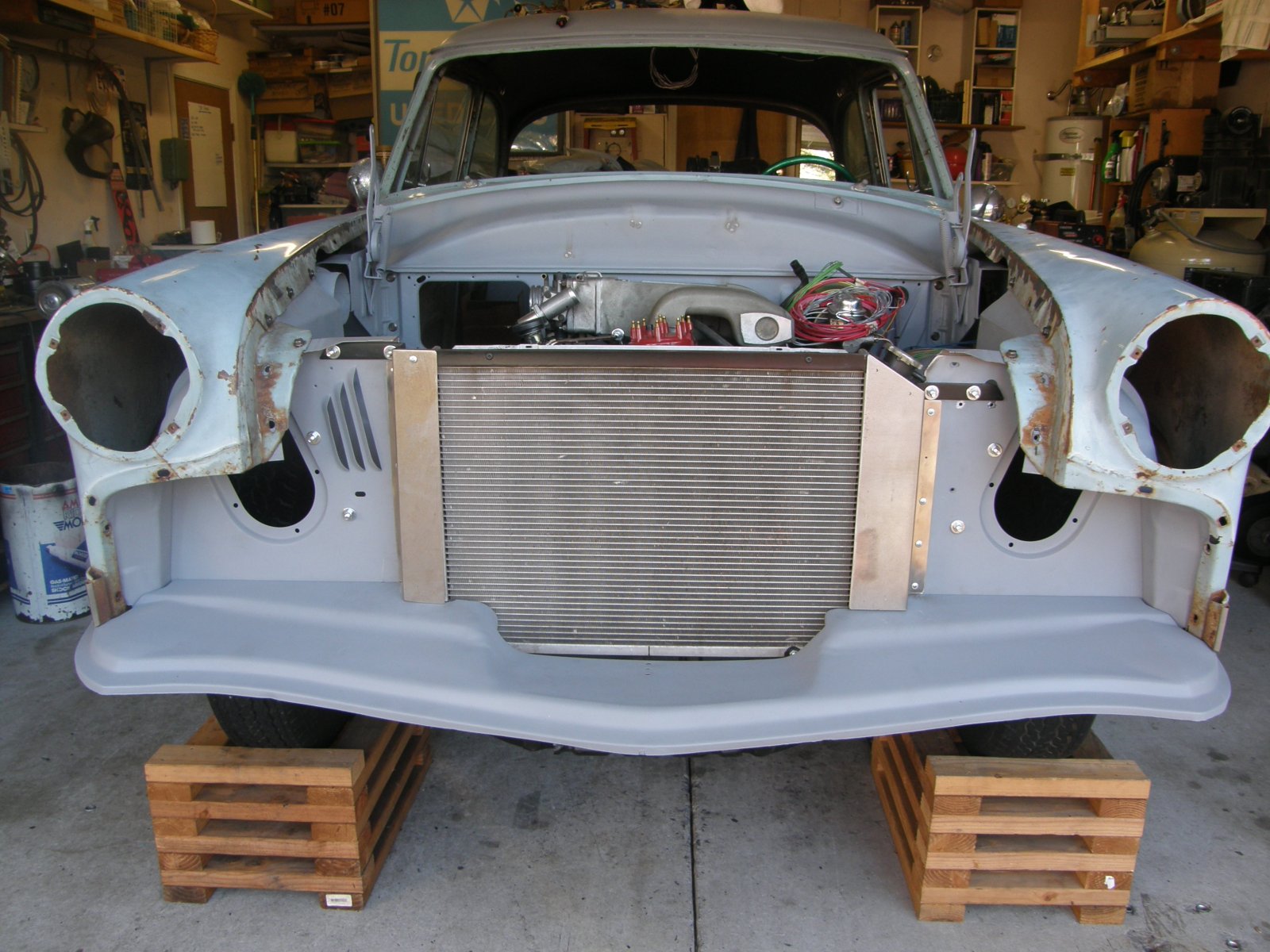

    I took the 5.0/AOD and factory radiator out of a '93 Mustang and it all fit well in my '54 Customline. I did have to move the rad 2" forward but the factory trans lines bolted right up. No trans cooling issues at all.

    I’d like to see more details of how you fit a mustang radiator in your ‘54. I’ve got a new foxbody radiator on the shelf that would really help cooling.

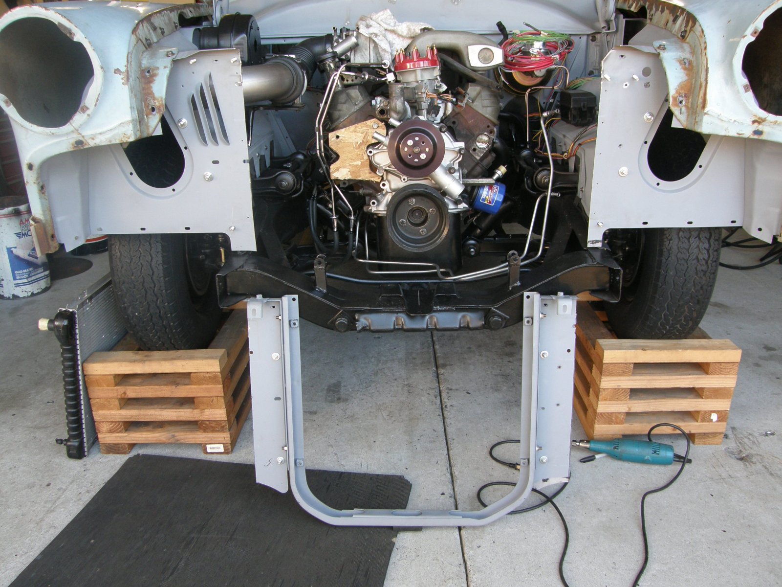

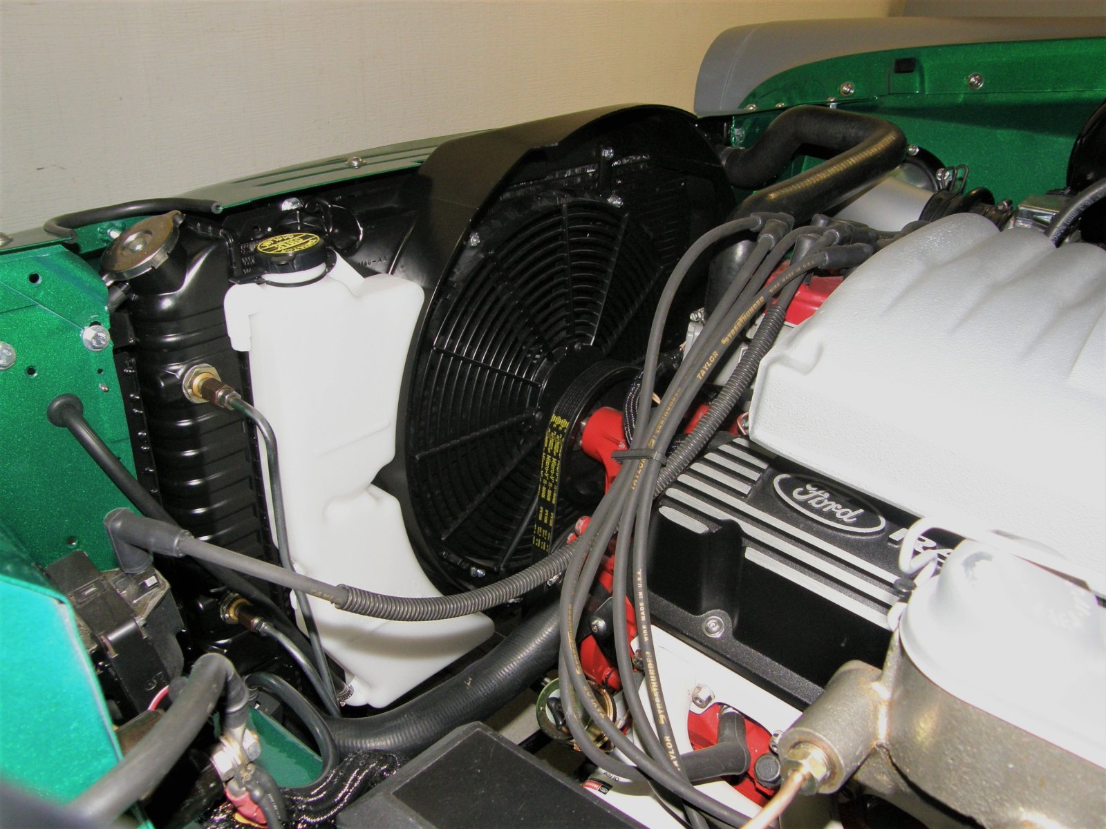

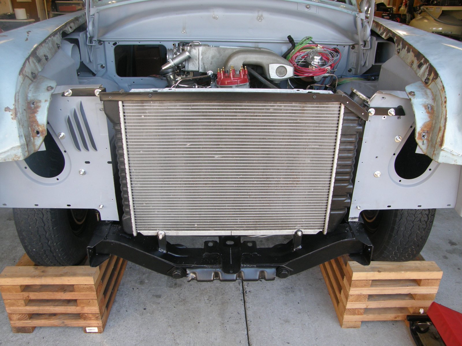

  22. evintho
    Joined: May 28, 2007
    Posts: 2,545
    evintho

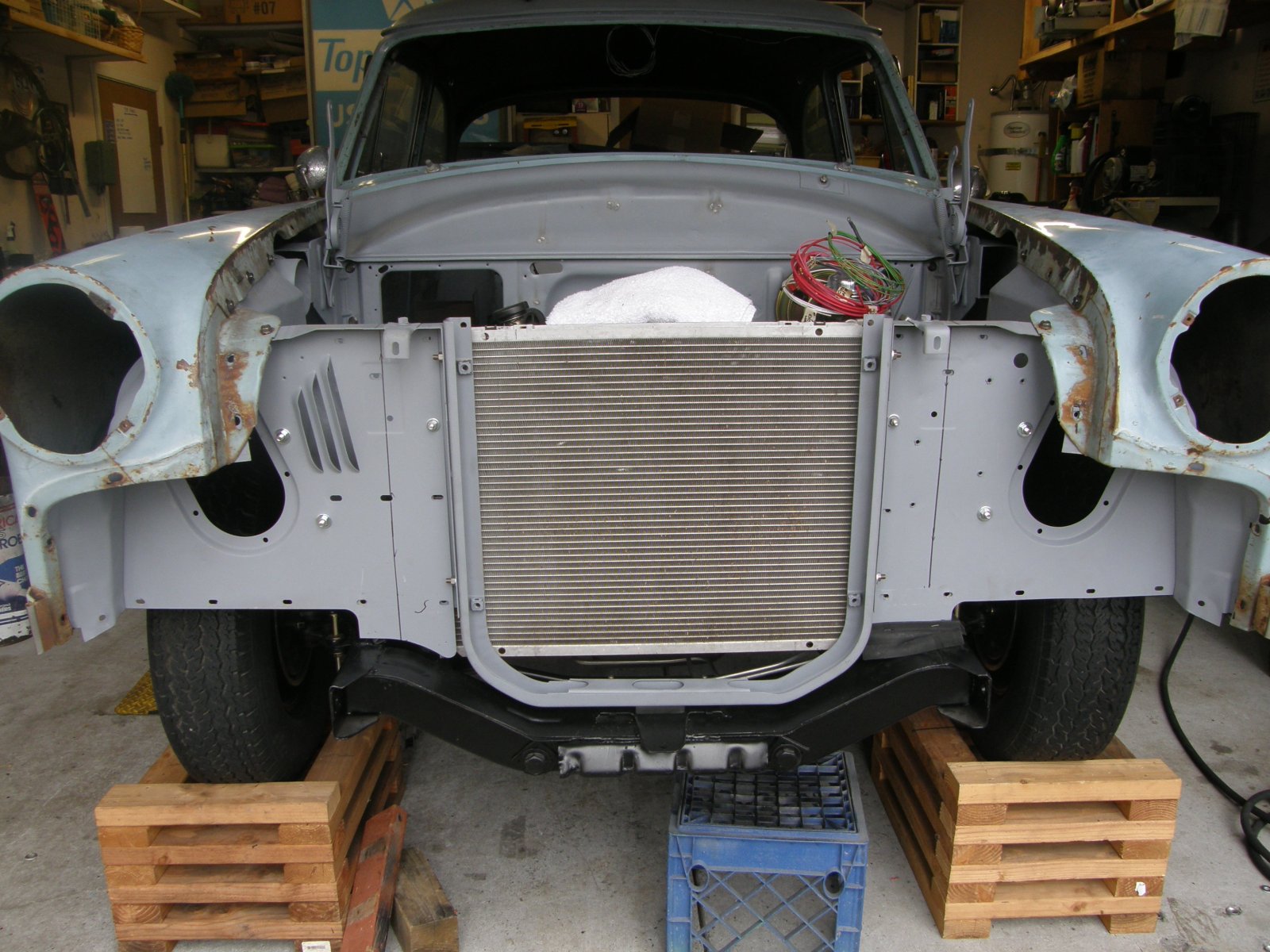

    Sure, it required a little bit of surgery and fab work but wasn't too difficult.
    I determined the width of the rad and what needed to be cut........
    Sliced and diced.........

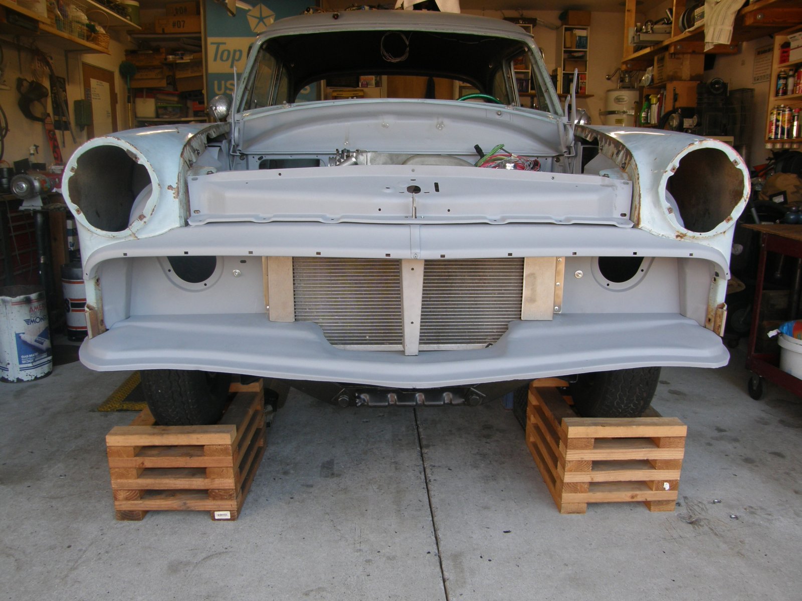

    Welded lower mounting tabs to the crossmember and made a crossbar out of 1" flatbar to tie in the top to the remaining core support. I later added in 1" square tubing for more ridigity. No pics of that.
    Made some tank covers out of sheet metal and notched the front pan for clearance.........
    Once it's blacked out and the bumper and grill are installed it's absolutely unnoticeable!

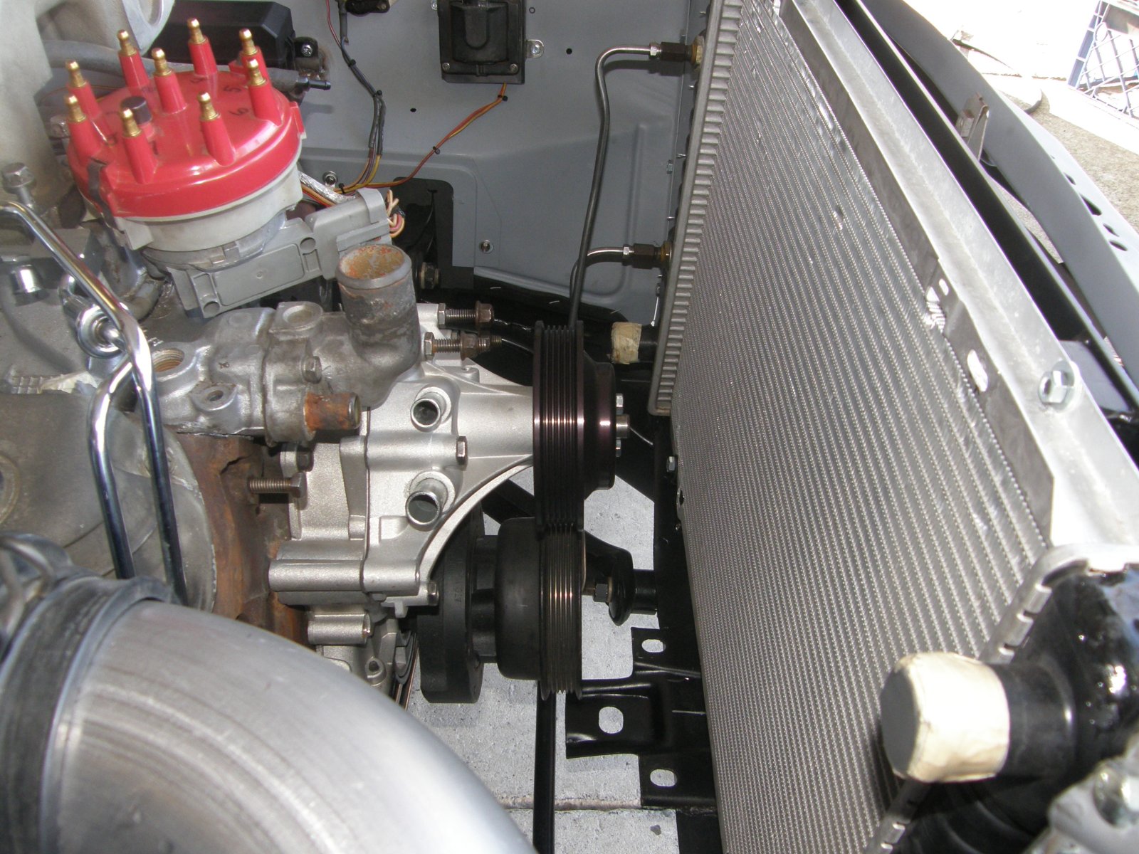

    Here's the clearance with a shorty water pump. Still not enough clearance for the factory clutch fan so I went with a 3k cfm electric fan. But as stated, no trans cooling issues at all......or engine cooling for that matter! Sits at 195* in traffic on a hundred degree day!

    @evintho Thank you for sharing you methods with us. It does look real nice. However, unless I am misinterpreting what I see, the structural strength of the original ‘ U ‘ shaped core support has not been restored. The so- called core support does much more than than hold the radiator in place.
    The core support…1) carries the forward weight of the front fenders which are otherwise only attached at the cowl/door pillar. 2) maintains vertical alignment of the front fenders. 3) provides a secure anchor point for the hood latch assembly and supports the forward hood weight as well.
    If you study the front end assembly of any non-unitized car or truck built since the late ‘30s,
    they all have a sturdy support structure in that area. Usually a ‘ U ‘ shaped pressed channel of at least 180* , sometimes 360*, of coverage to carry the radiator, coolant weight and the structural loads I referenced above. The later the model year, the more ‘bridge like’ the support structure.
    Just my thoughts, offered for consideration. Airplane engineering requires ‘just enough’ strength to carry the intended load capacity. Too much strength and it is too heavy to either carry the desired load, or get off the ground, or both. I realized many years ago that if I designed an airplane it would be a Do-Do bird….:(
