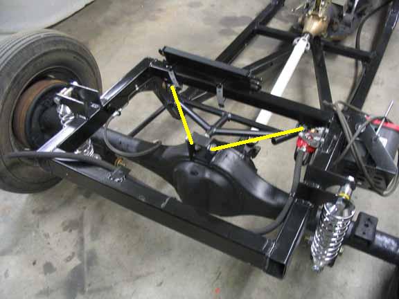

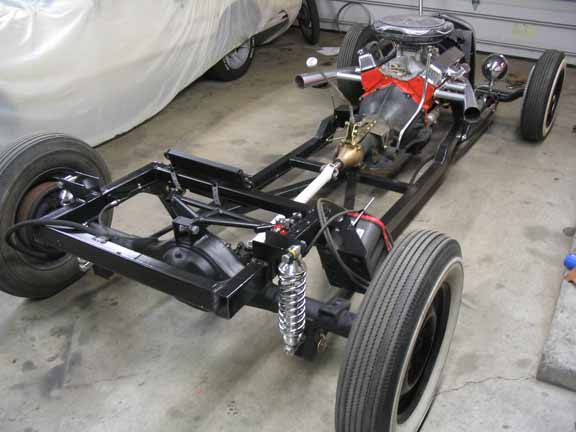

    Mine's similar to a 3-link, I guess you could call it a wishbone. I have lower control arms mounted from the bottom of the axle to the outside of the frame. On top I have a triangular shaped wishbone with the base of the triangle attached to two points near the top of my kickup and the apex of the triangle mounted to the top of the rear end. It works great, bind free and doesn't allow for any lateral movement of the rear end. Its the only thing that works for me, the car is about 5.5" off the ground and heavily chanelled.
  5. Lucky77
    Joined: Mar 27, 2006
    Posts: 2,495
    Lucky77
    Oops, guess some pictures would help.

    If you look through my posts, this was the topic that I struggled with the most during my build. This ended up being the fourth suspension design. I was going to go with a four link but the center section on a 9" isn't centered so I was going to have to come up with different height mounts and trying to keep all the respective angles was driving me crazy. fab32, my hotrod Yoda came over and said "Why don't you build a wishbone?" He drew it up on some cardboard and I got to cutting and welding. You could even turn around the design and put two mounts on top of the axle and one in the center of the chassis. I have rod ends at all pivot points including the top of the rear end. This allows me to change the pinion angle.
