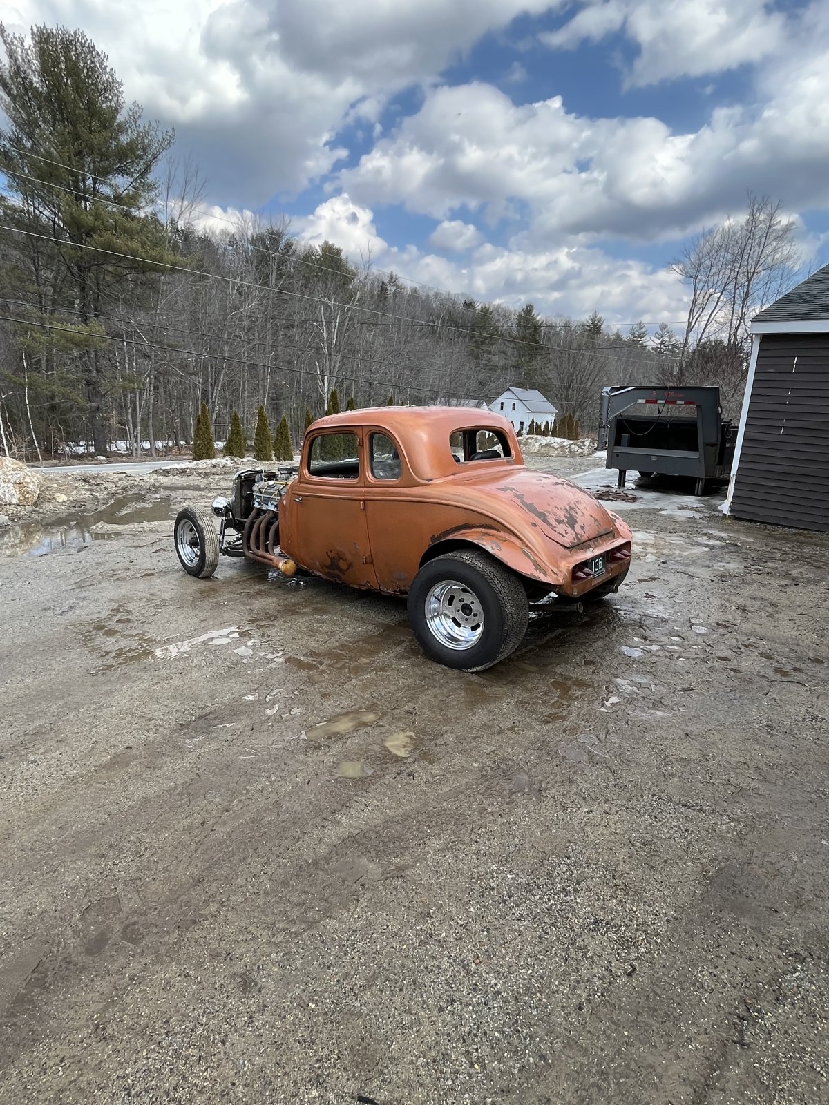

History Anyone recognize this 60’s, Orange, Channeled ‘34 5 Window from New England?

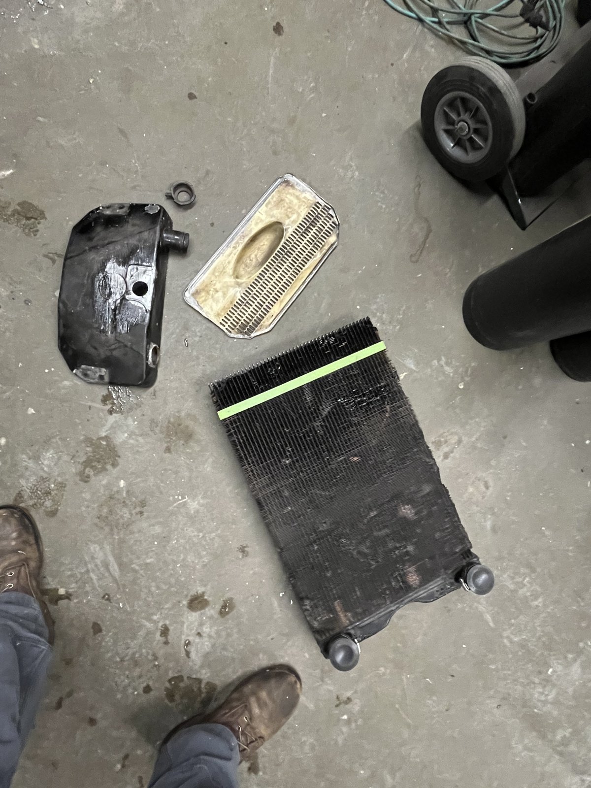

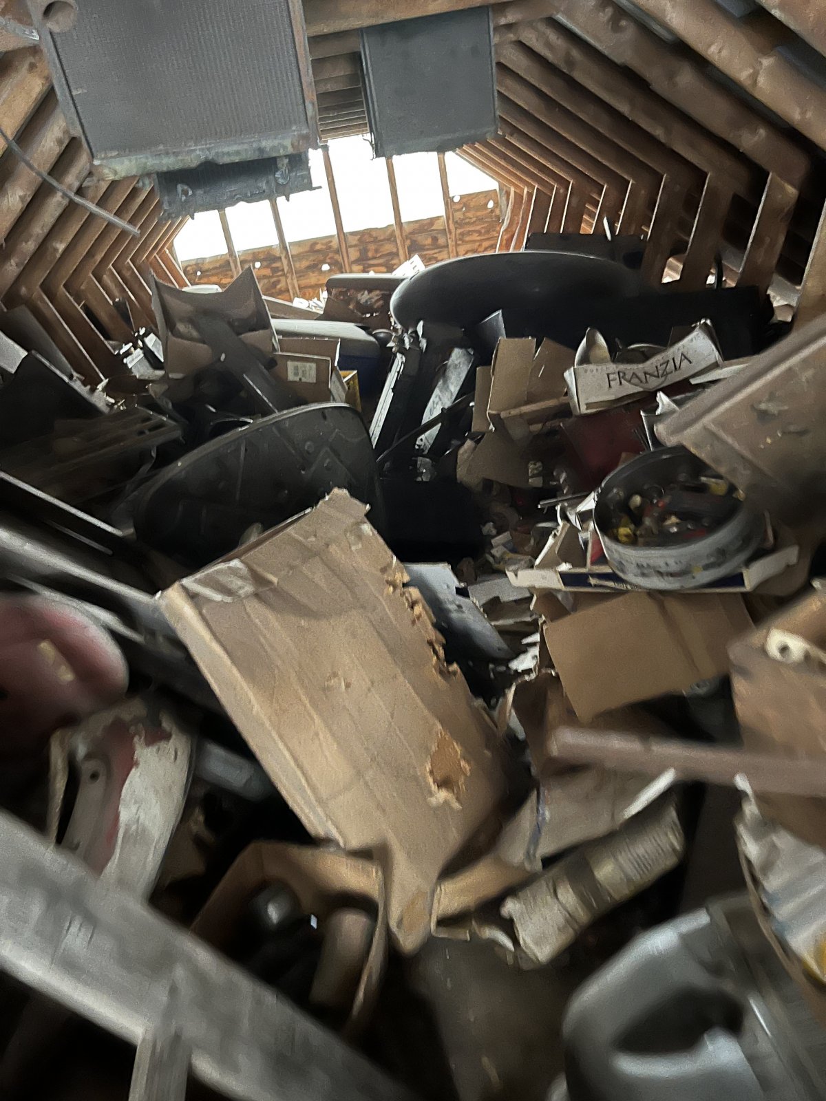

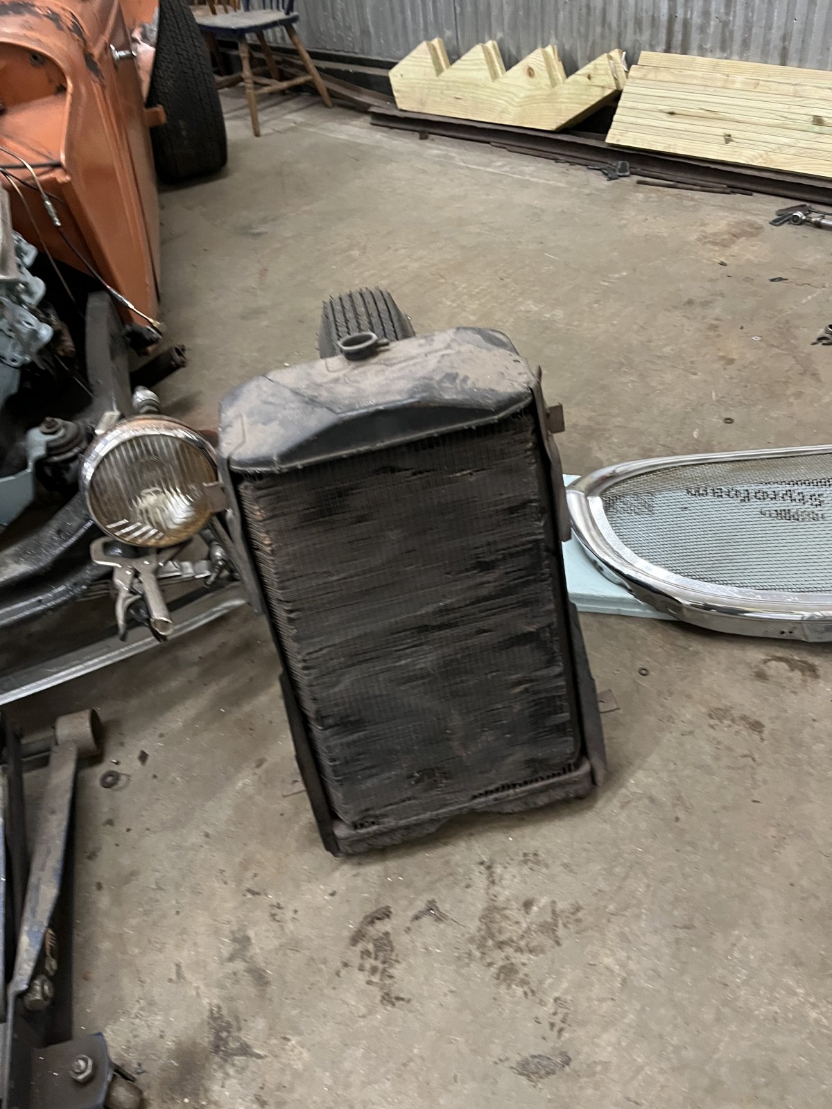

    Been doing a bunch of research, measuring and making a bunch of phone calls, but I finally settled on using a ‘37 Ford passenger car radiator. The sides of the core taper I , and it’s only 14” wide at the front.
    Managed to find one in a friends attic, he had forgotten it was even up there. I tested it and found a couple small leaks, but I think it’ll be good enough to use.
    Plan is to chop the core about 5”. The top tank is going to be modified as well.

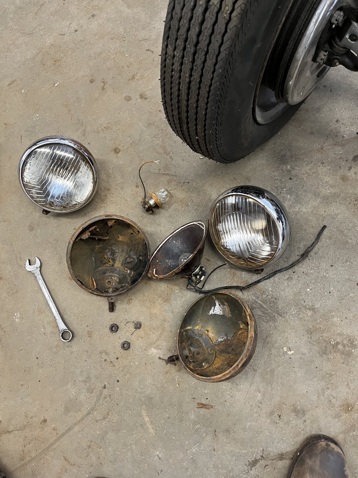

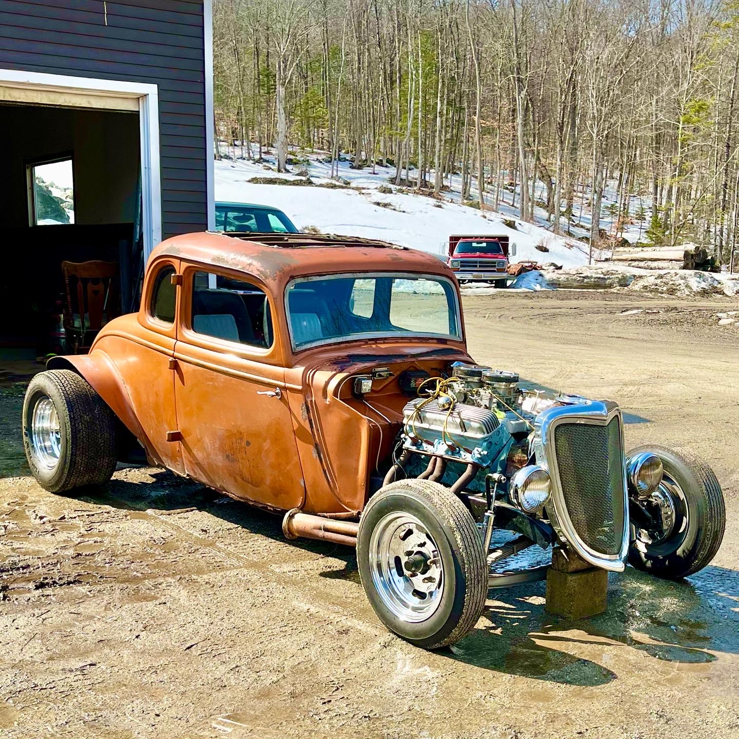

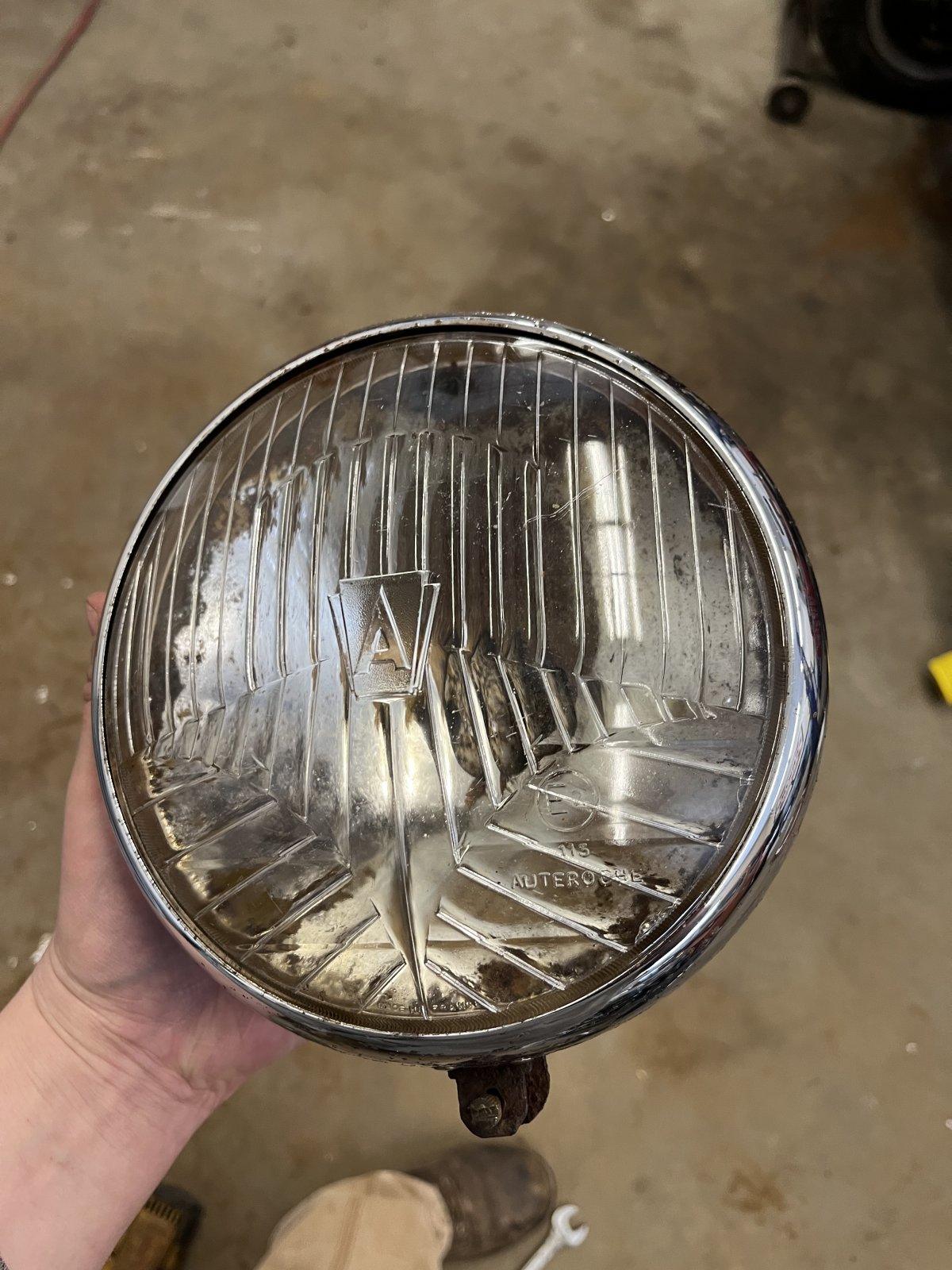

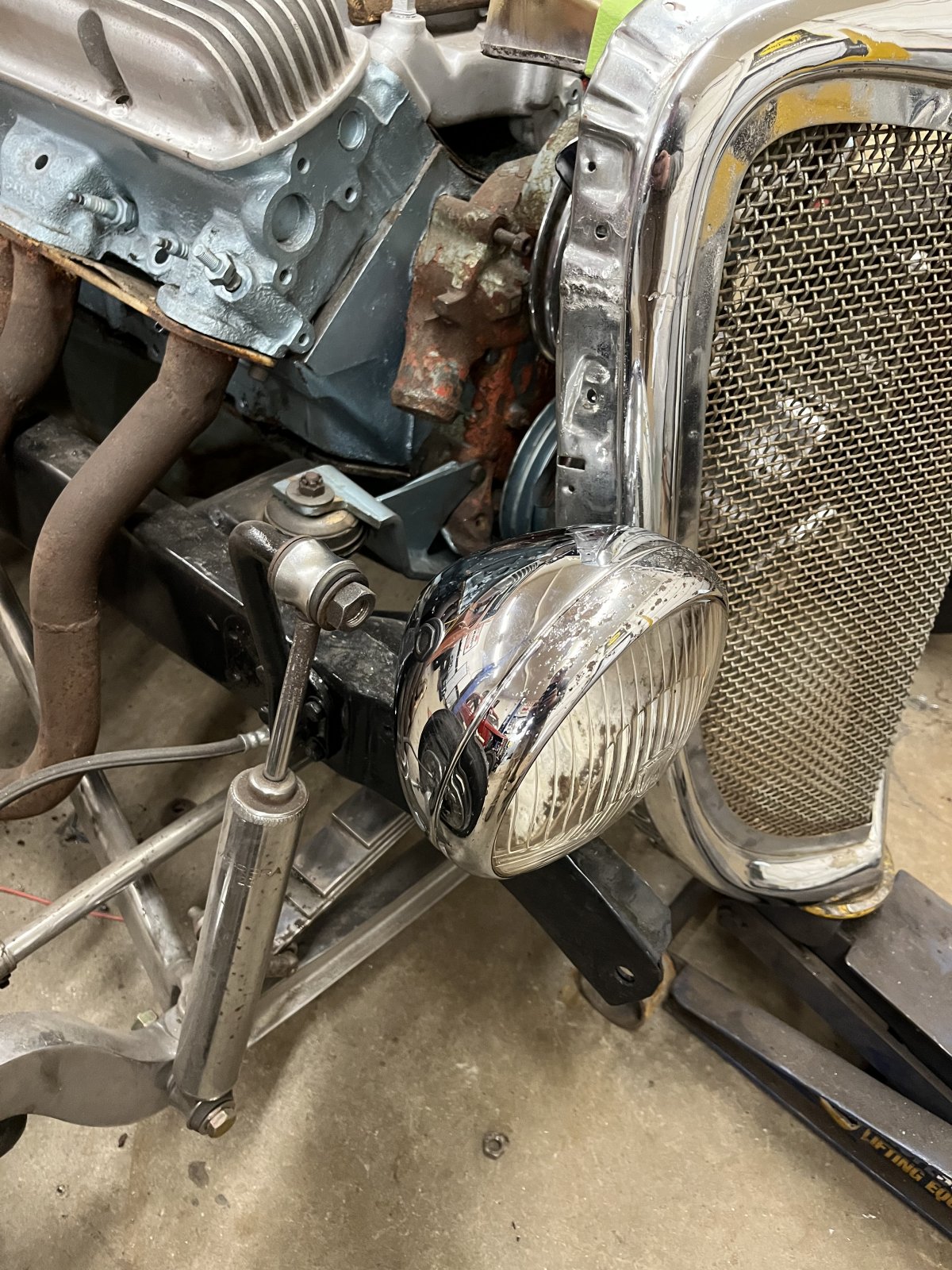

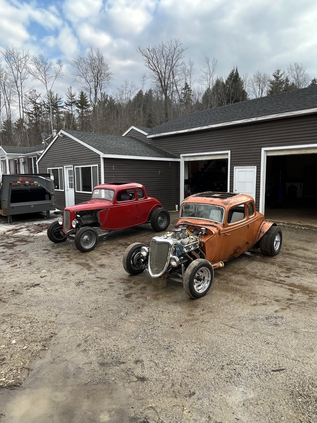

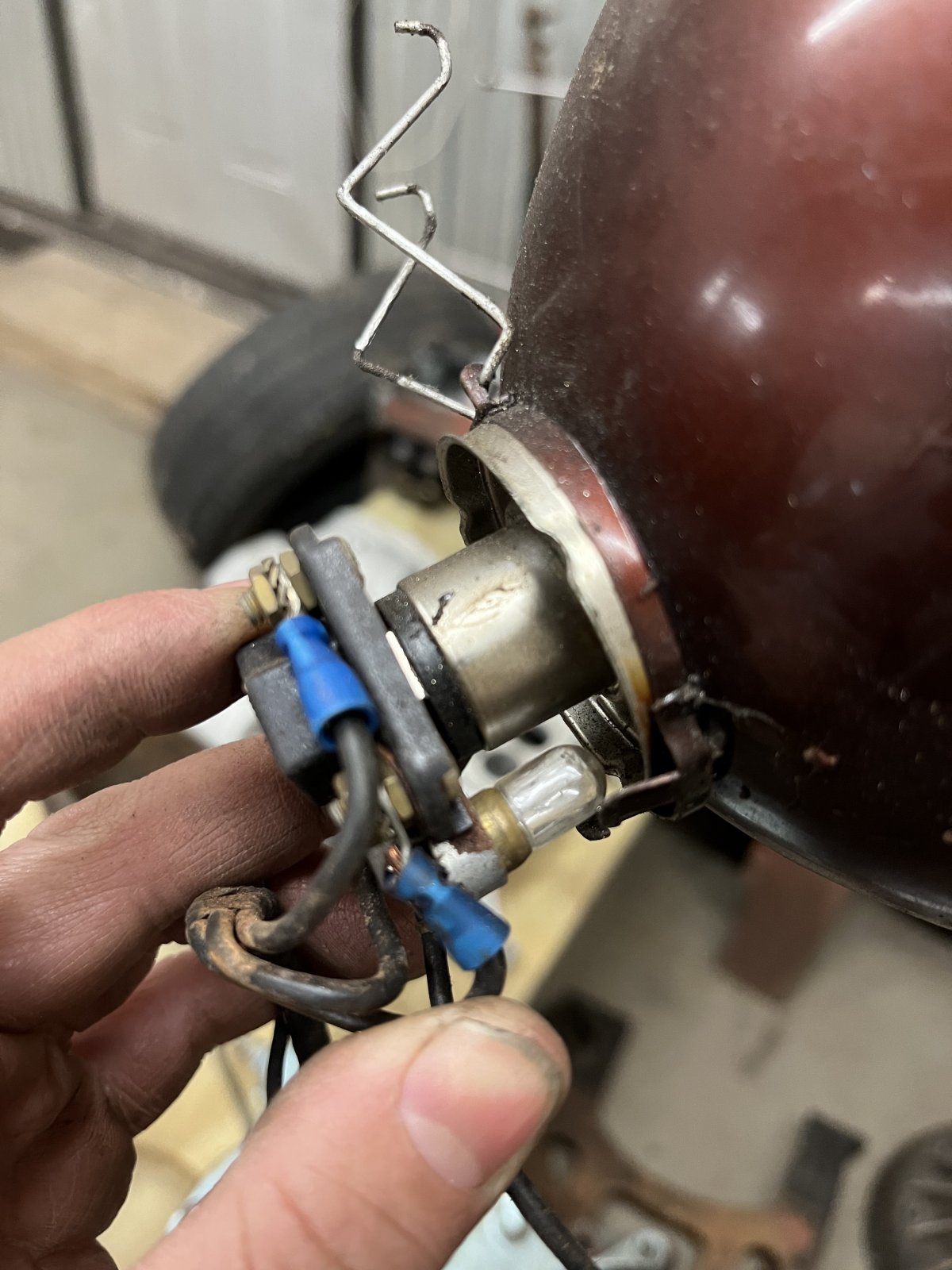

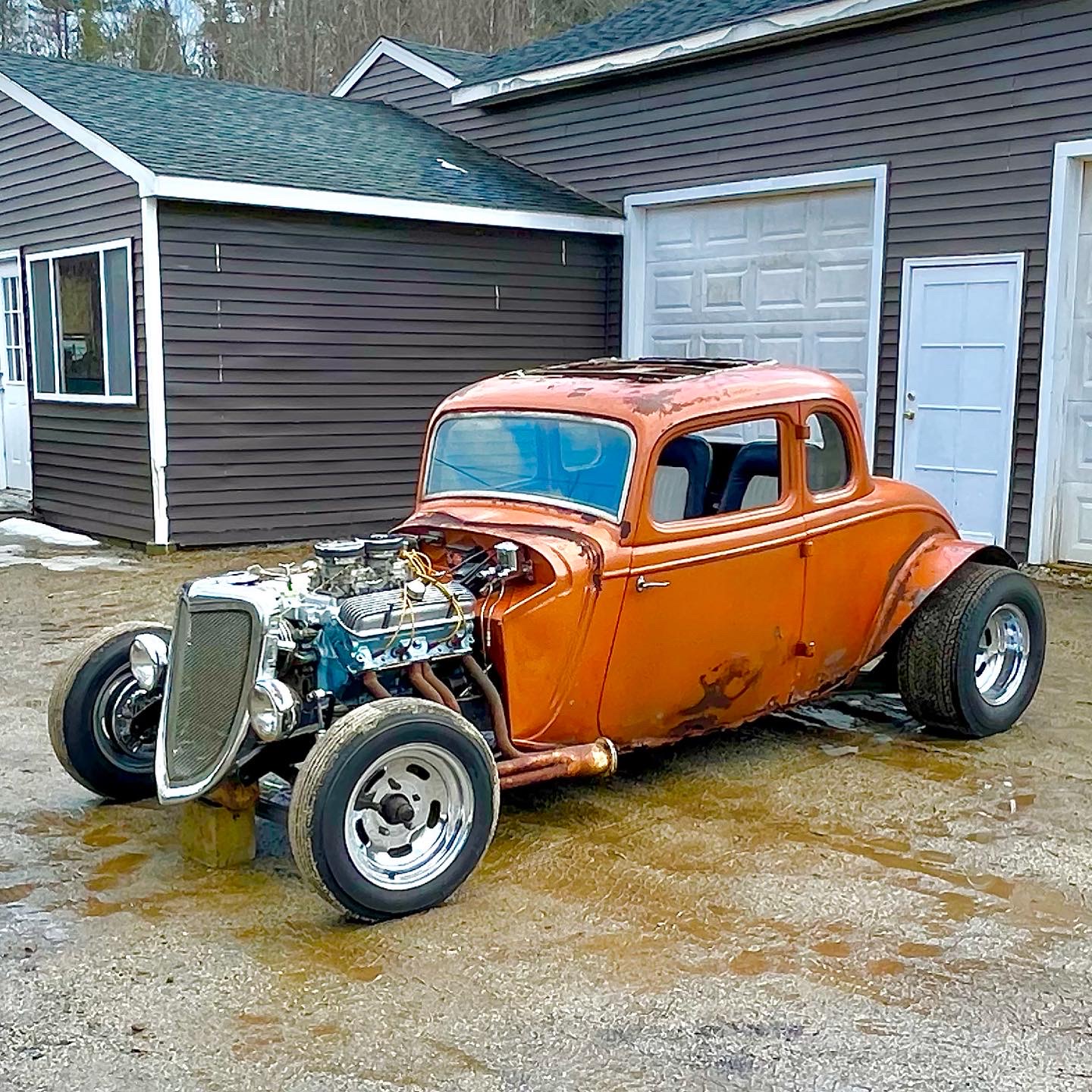

    Played around with headlights and got them mounted. The chrome cleaned up decent. They’re made in France, and have separate parking lights built in. Thanks to rustnh for the extra set of headlights, had to use the lenses from the donors. They’re sealed into the tins behind them.
    712CA824-B25F-44B2-A0E8-1B6AF87764F8.jpeg CD23624D-138F-49FF-BE9F-089DB7879969.jpeg 05986A8B-7307-4DD4-95FF-50A19607137D.jpeg 4D9367C3-8347-4F10-9549-FBC479CAFF10.jpeg

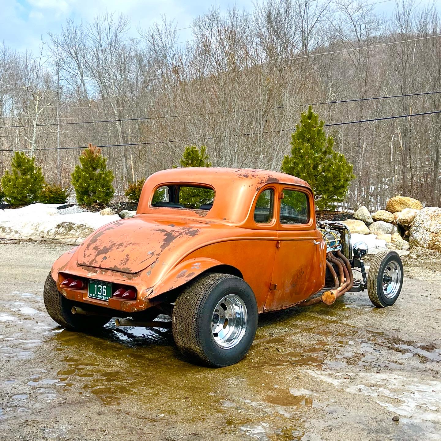

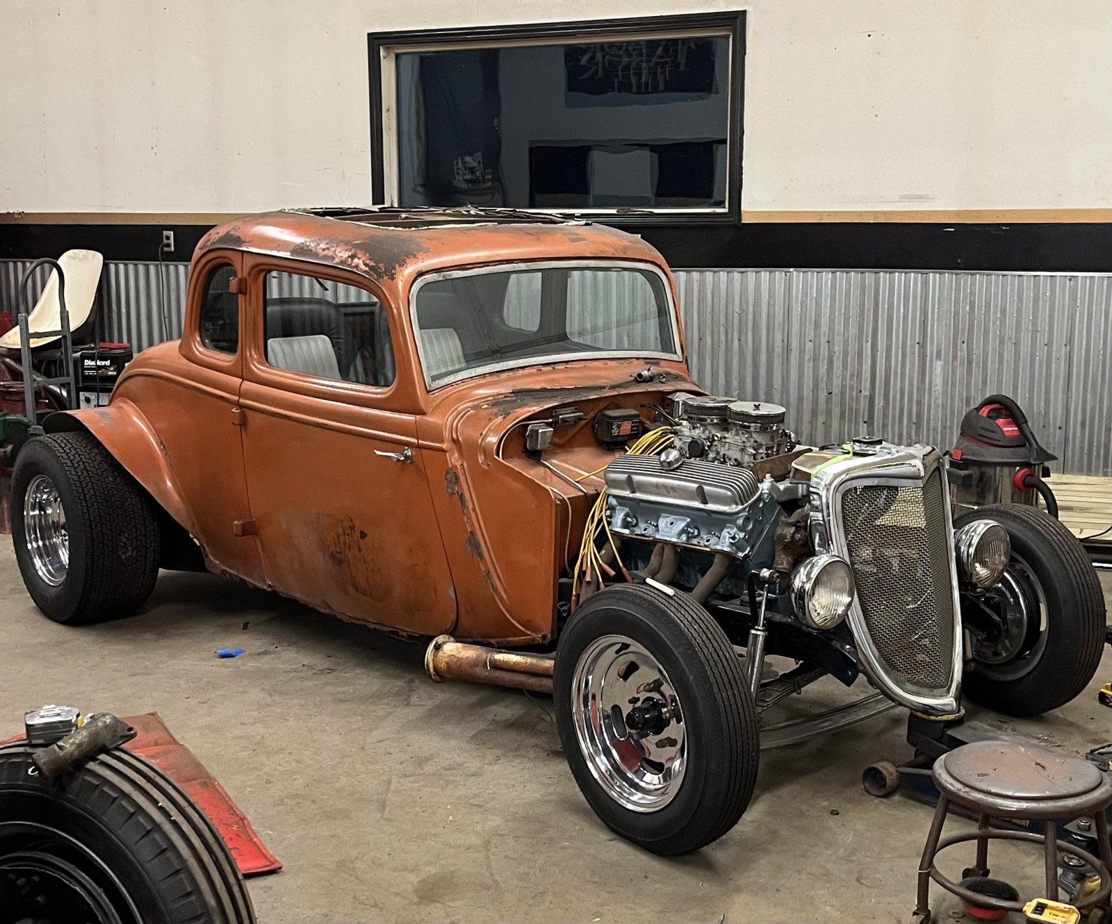

    Working on the radiator as well. Finally wired a converter for a 3 phase vertical band saw I’ve had for a long time. Now I just need a new blade before cutting the core. I quickly soldered the 34 top bracket onto the 37 top tank to see how things will work out.
    The nose looks a little stretched to me, but I don’t think I have any options left. Well aside from a 12” wide radiator, or cutting the firewall. The distance between firewall and top of grille is about 2.5” longer than stock.
    B1682980-3834-43A8-A991-192273D15752.jpeg 73E3B3AA-333A-4461-9C0E-776898068758.jpeg 69F2D4C7-C18D-40FC-8952-FE39B73A56D7.jpeg C867A304-AC71-4AC6-96FB-284659ADE494.jpeg

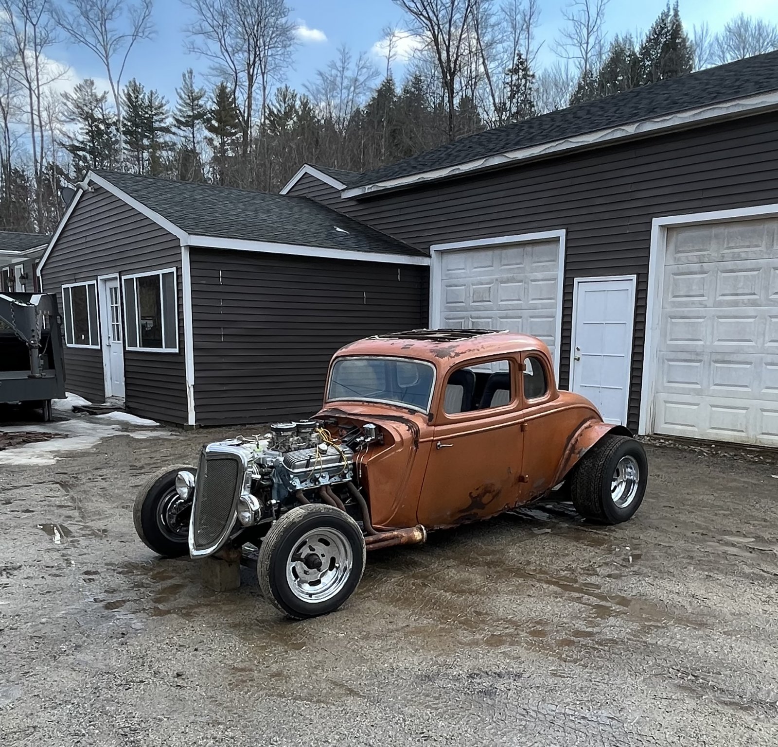

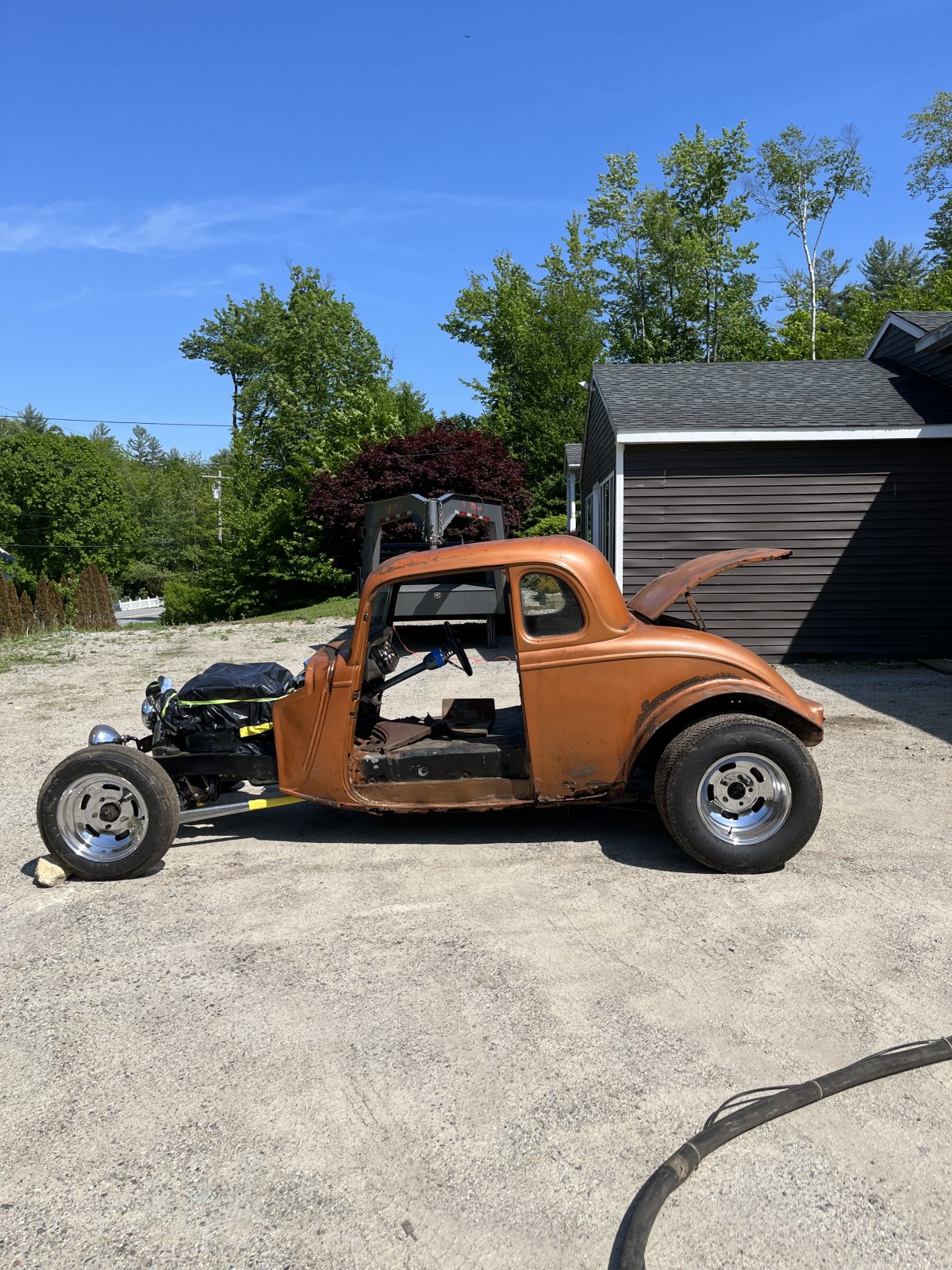

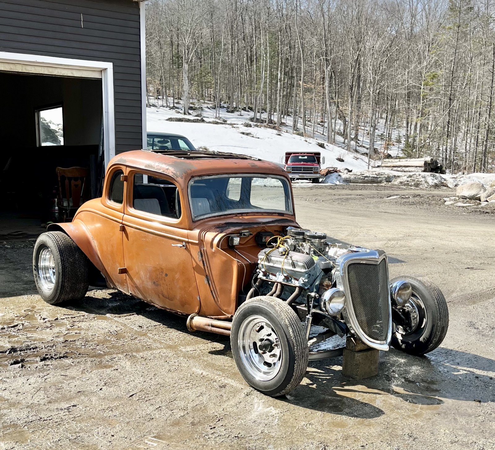

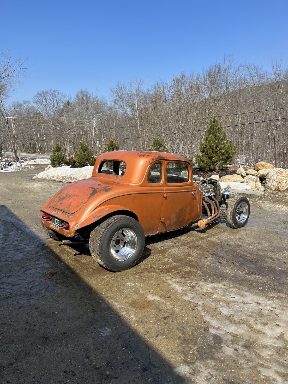

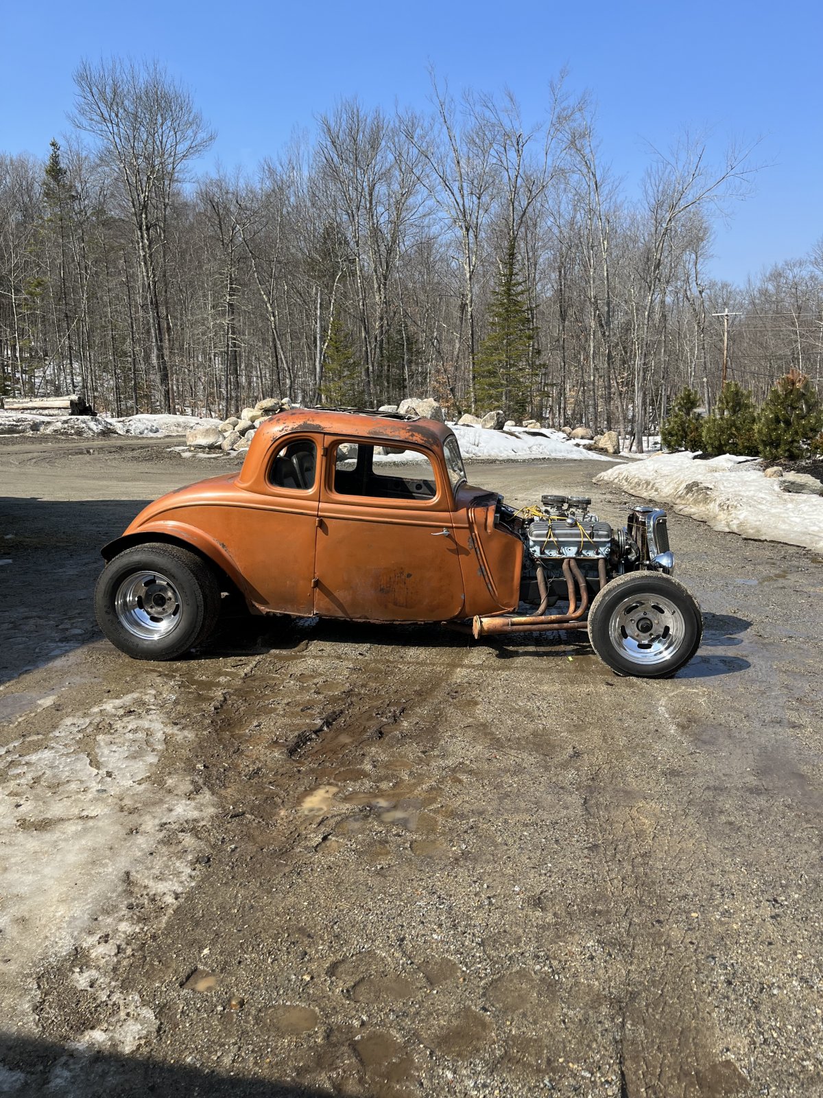

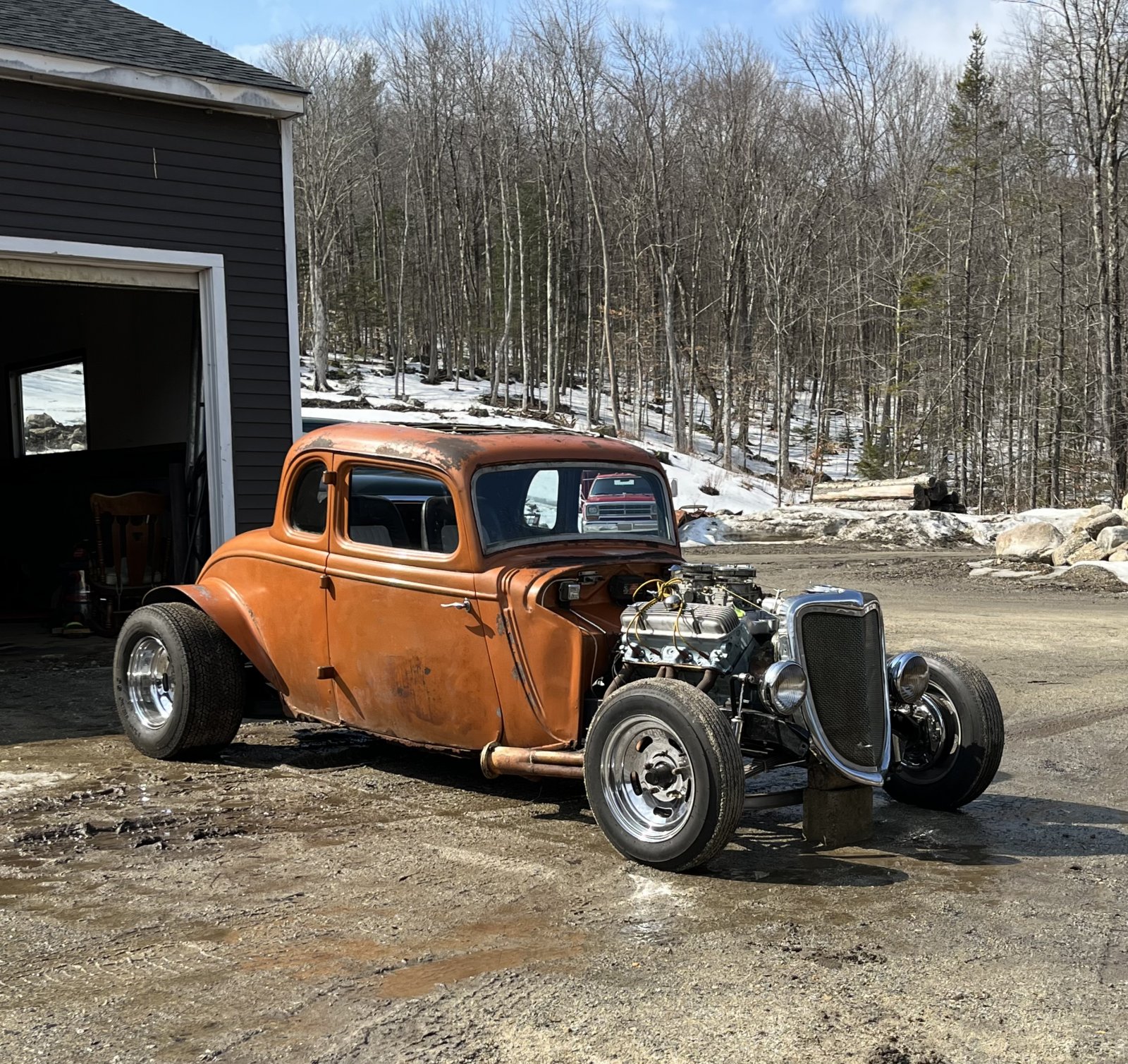

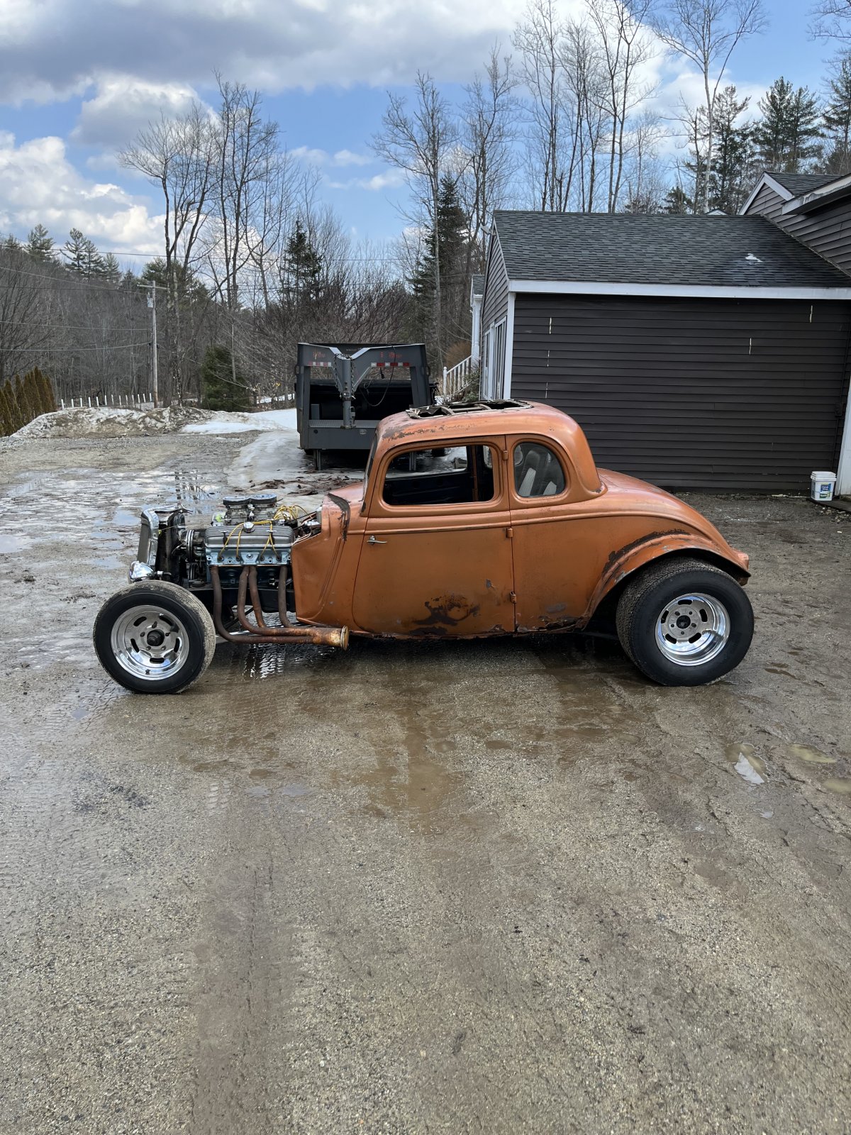

    Took the day off from work to mess with the radiator…. And took advantage of the nice weather to see how it looked outside. I think this is the first time since August, and first time with the 34 grill. I’ll post some more pics later. 020FF2CA-8D93-4DED-848A-821C50F6075D.jpeg

  9. 32 hudson
    Joined: Mar 5, 2005
    Posts: 784
    32 hudson
    Looks good. Yeah a guy needs to do that take a day off. Mock up the car with grill shell and push it outside stand back and look at it. Keeping the vision a live and for motivation !

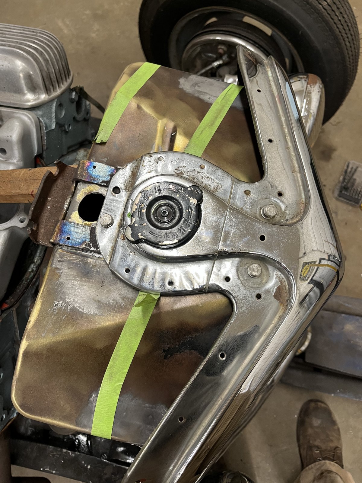

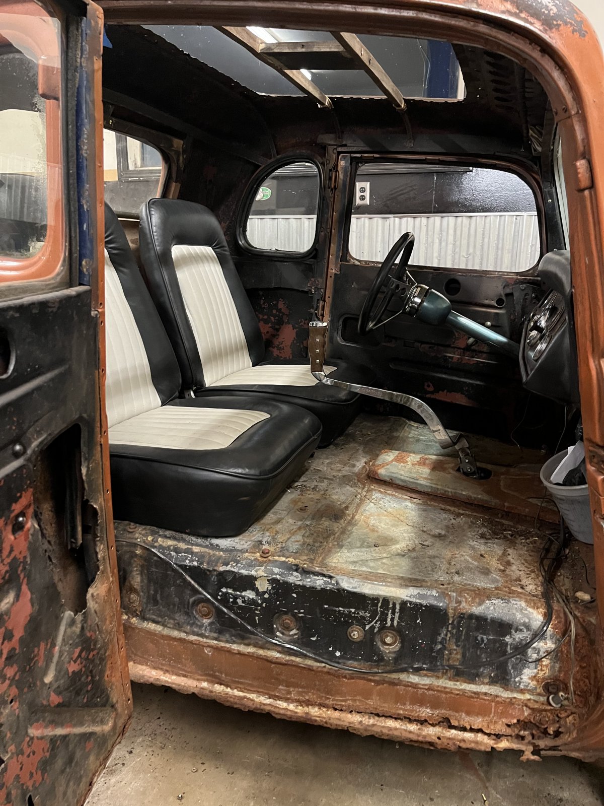

    I don’t really have any good pics right now, but I re-engineered the steering a little. Bought a new Made in USA Borgeson 525 Saginaw steering box, quick ratio, and added a u joint. The steering shaft straight off the box made the steering wheel offset too close to the door. So with the u joint, I was able to move the column 1 and 1/2” closer to the shifter. What a world of difference! Haven’t figured out what the column/box is out of, I think late 50’s GM. Did manage to find NOS turn signal switch
    Also managed to figure out my shifter! Of course the best fit would be from the first year factory hurst pistol grip Dodge Chargers (with console)… but I found one on eBay that someone took a torch to many moons ago, and made the seller a ‘reasonable’ offer and he took it. Might have to make some real wood grips… the plastic repop ones ain’t cutting’ it

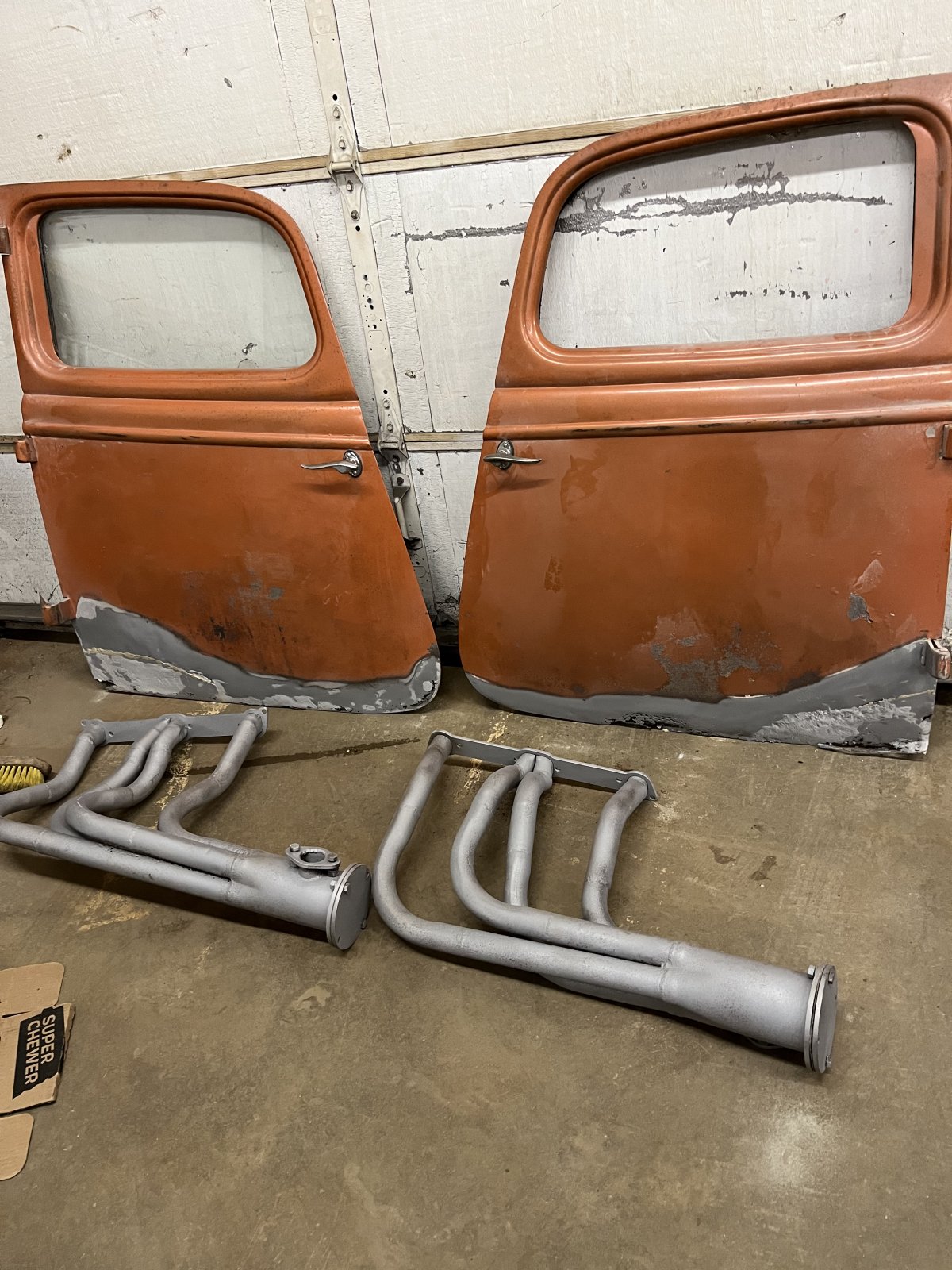

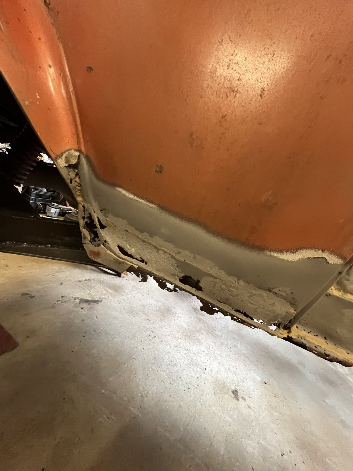

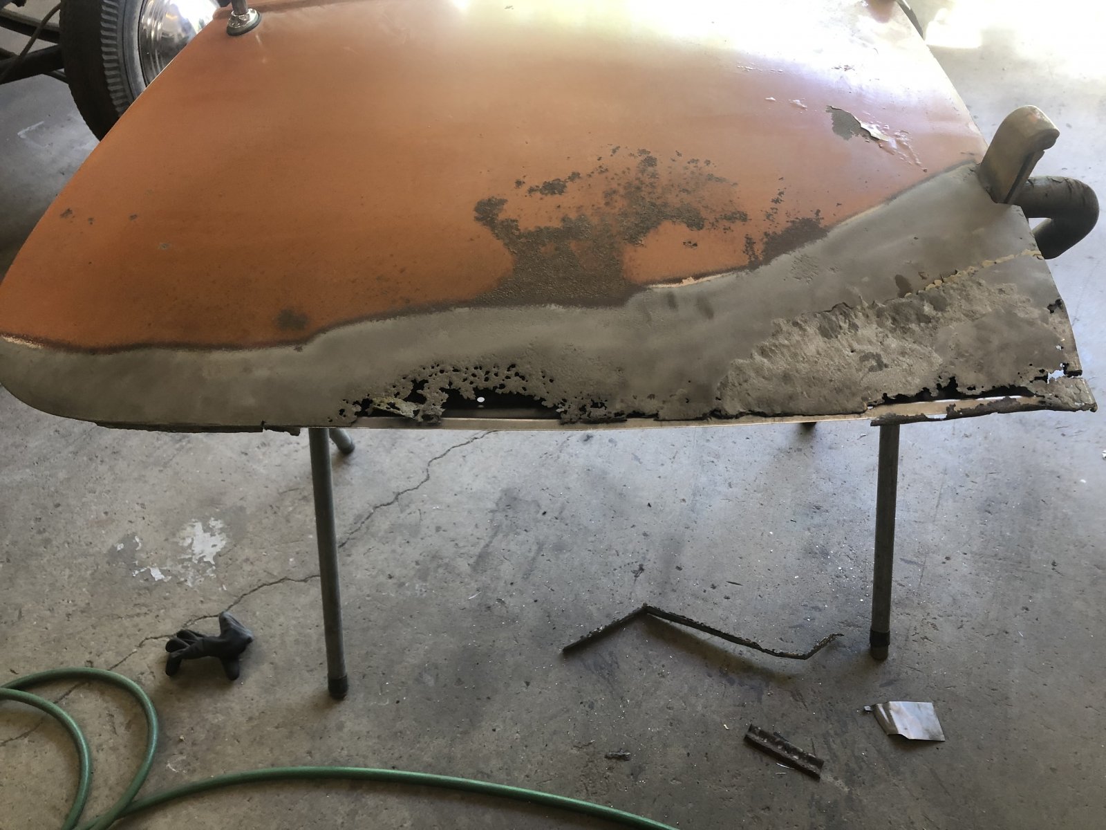

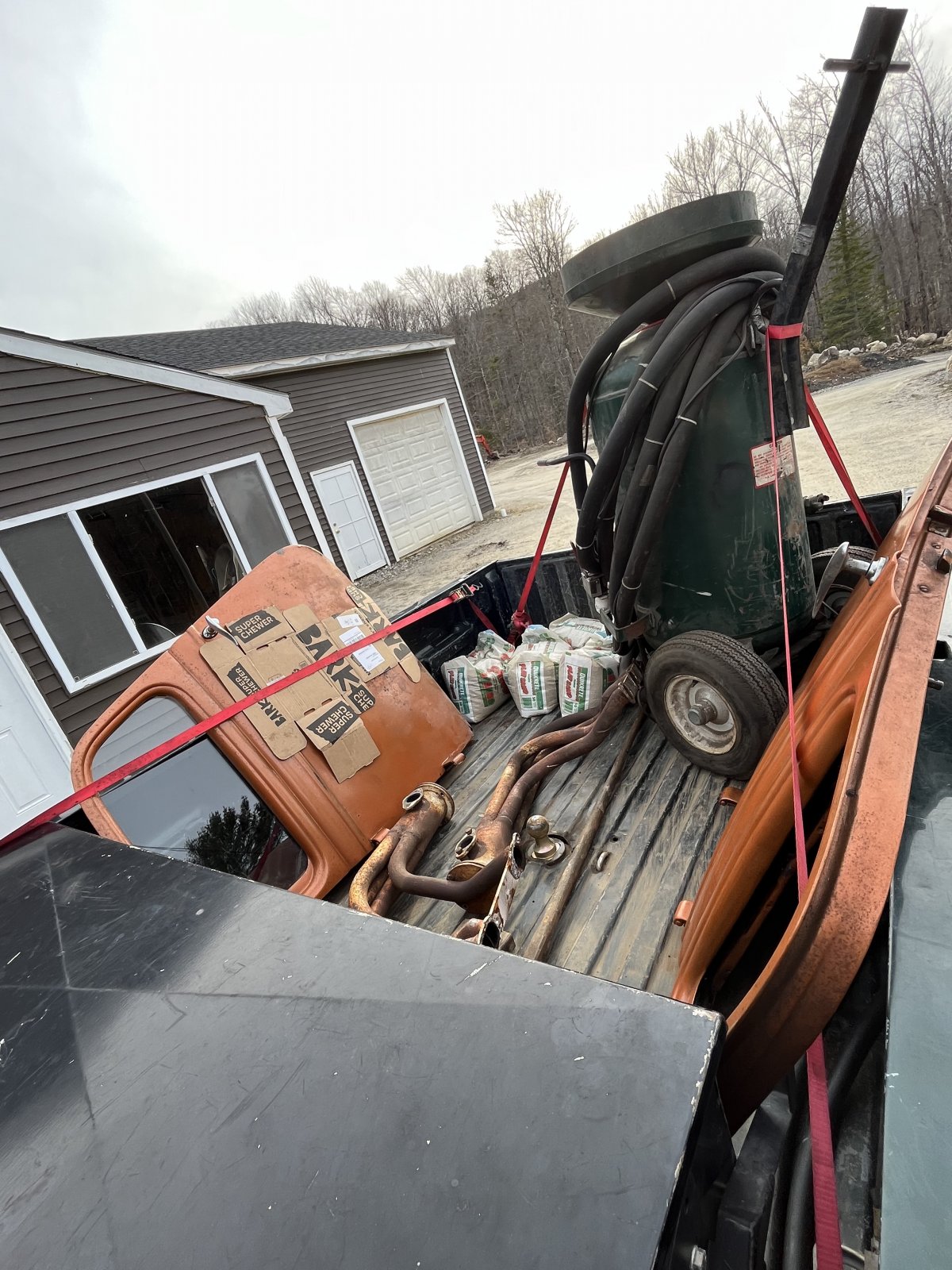

    Picked up a sandblaster that was a little big (300lb pot), and did the door bottoms as well as the headers. Found a couple surprises, hopefully Ray Prue at Father Rays Hot Rods can save em. Like to leave as much old paint as I can… Definitely found a lot of lead!
    20A05738-F035-4984-A905-89373E0DD0B5.jpeg 8307DCB4-812C-4DB0-BCBE-F2E915263159.jpeg A1DF1F30-54D1-440A-AA48-81F2ED94D2B5.jpeg 4693480D-FE16-4D23-8663-51DB6653B767.jpeg 243BB580-5319-40FA-82F4-5BFDDBB171A8.jpeg

    Man those headers are cool looking I love to recreate a pair for my car

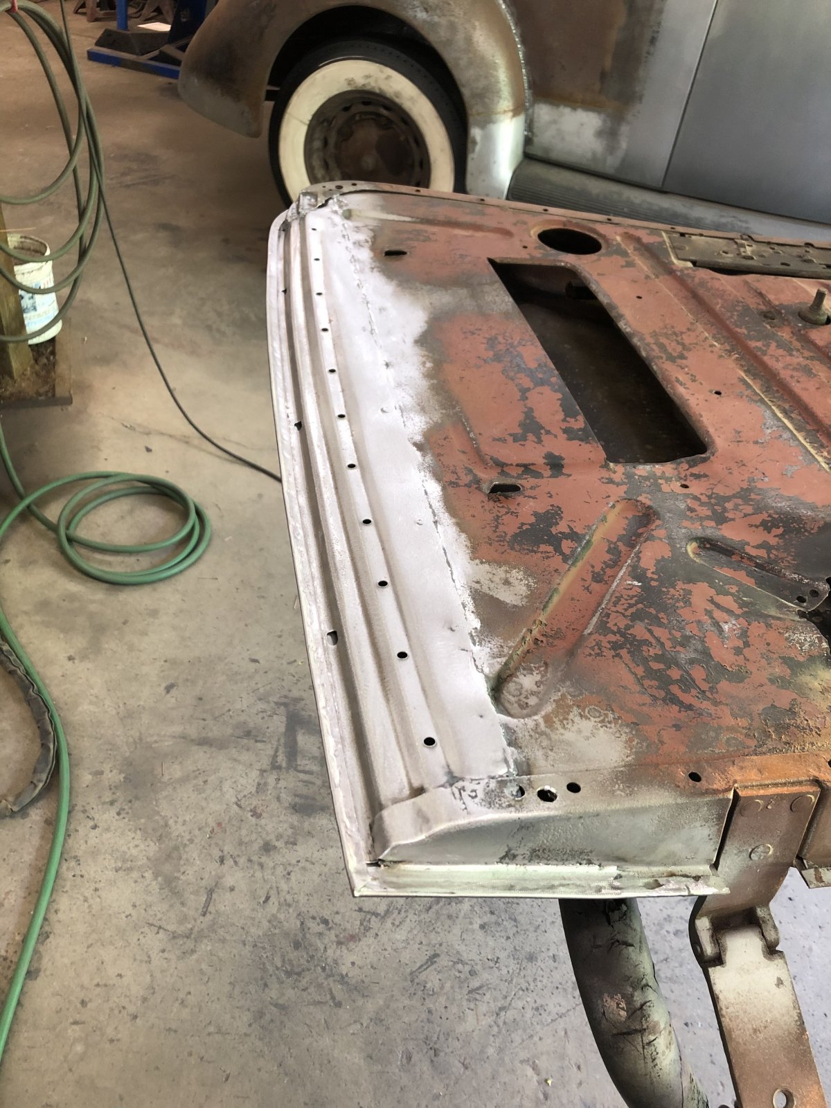

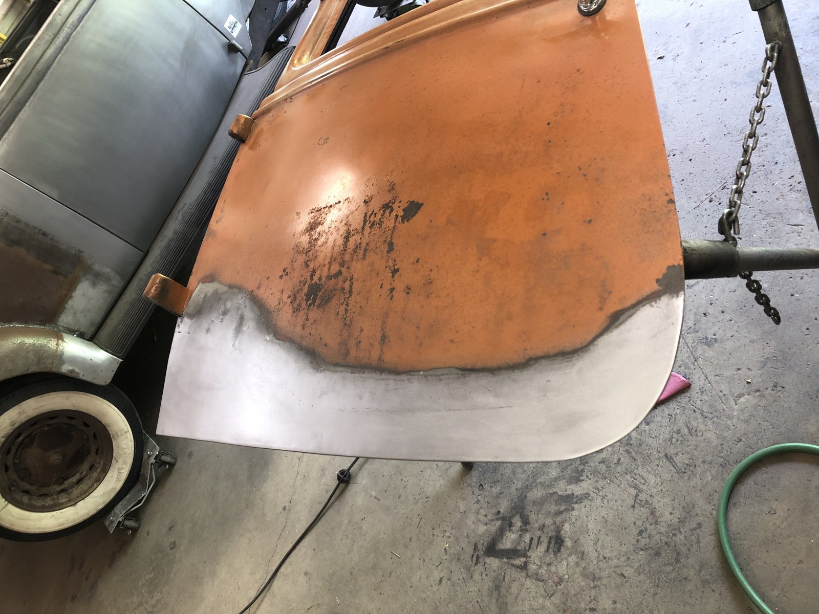

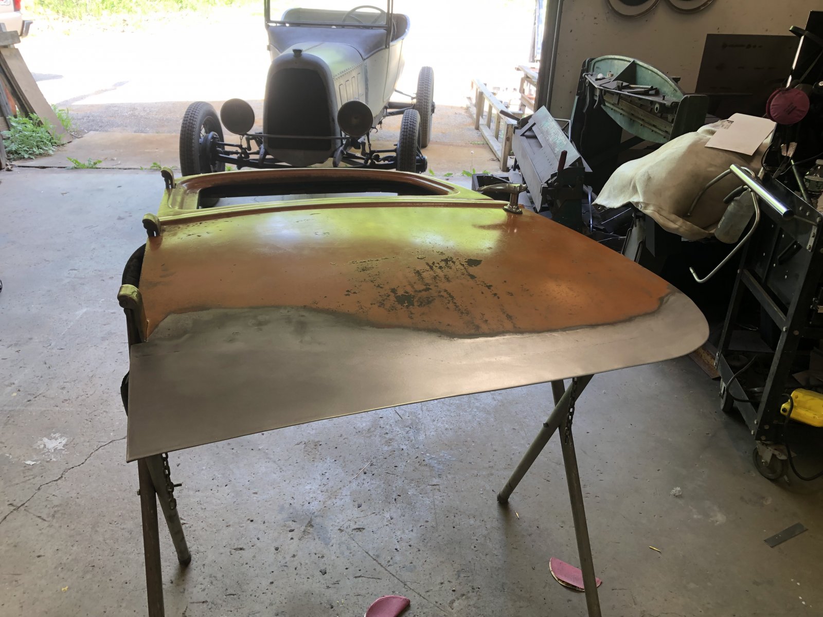

    Progress.

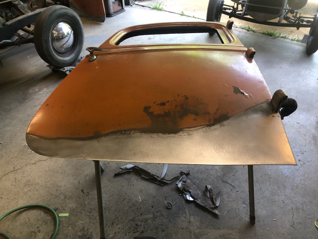

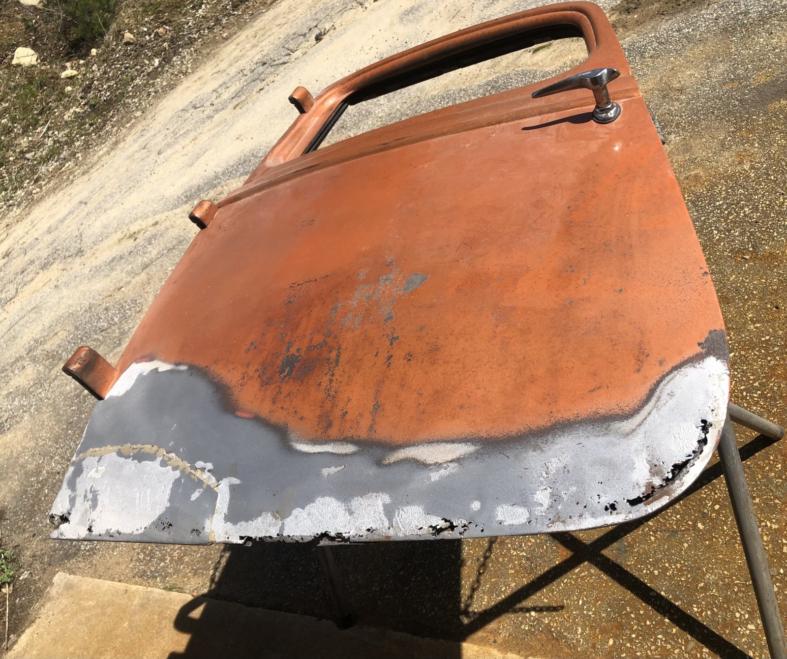

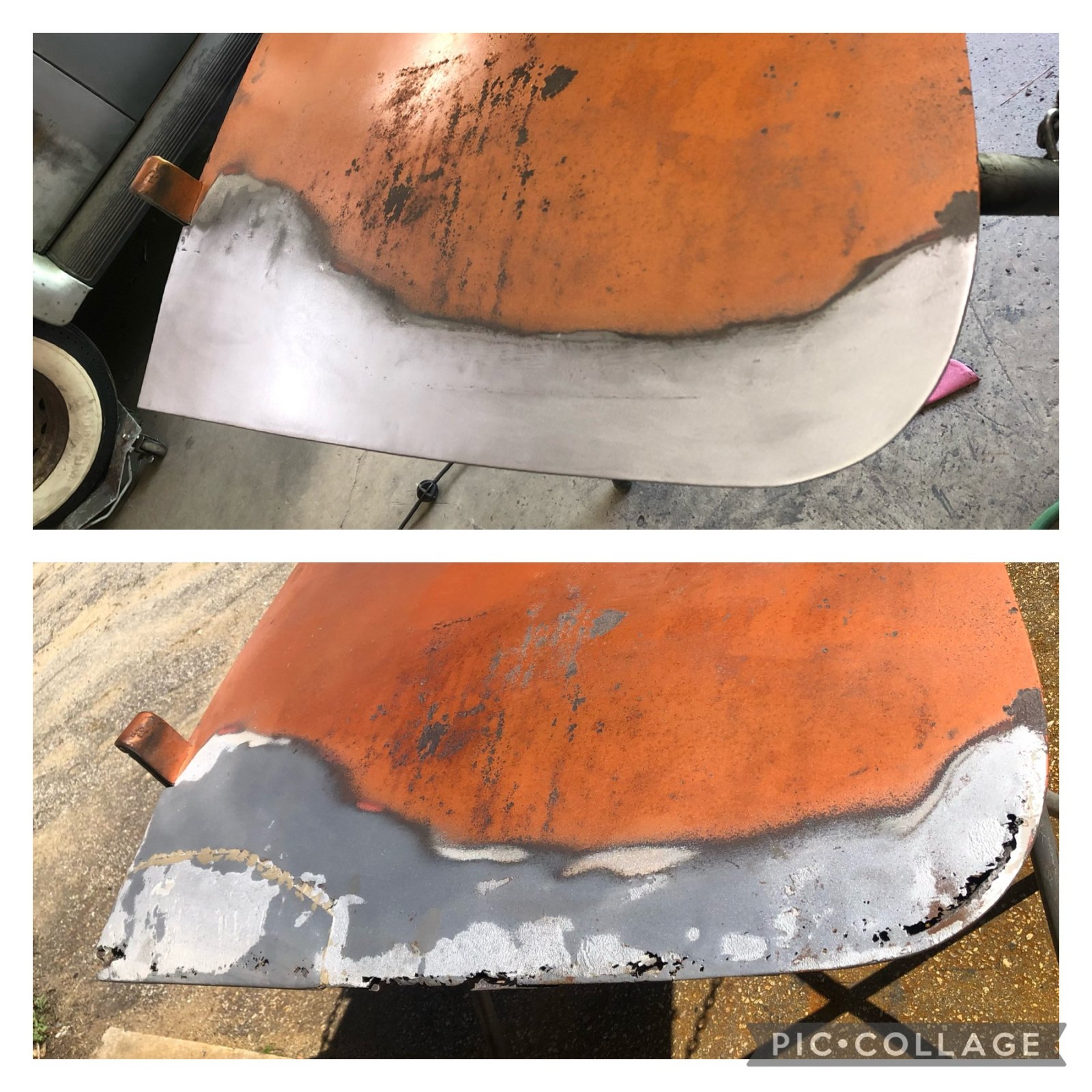

    Ray Prue of Father Ray’s Hot Rods saved the doors. The pics don’t do justice, he’s a miracle worker!
    70786B40-338F-4B9C-964B-A64CA116A774.jpeg E57F3A31-638C-4277-AD65-ABBE67FDA96C.jpeg
    0C16D3E7-91AB-47E7-9A42-B78E1D067F05.jpeg B6C2E593-2997-4C98-B55A-8CA7EDC32BE8.jpeg

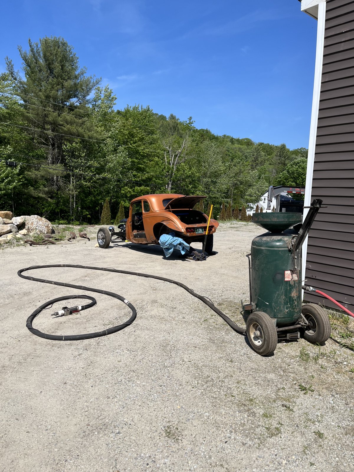

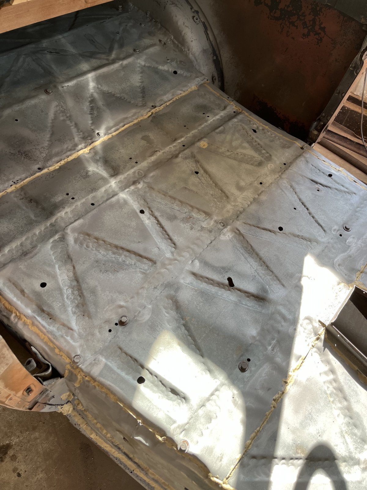

    Did some more sandblasting yesterday. Found that play sand works pretty good. Bought a sandblaster that was way too big though!

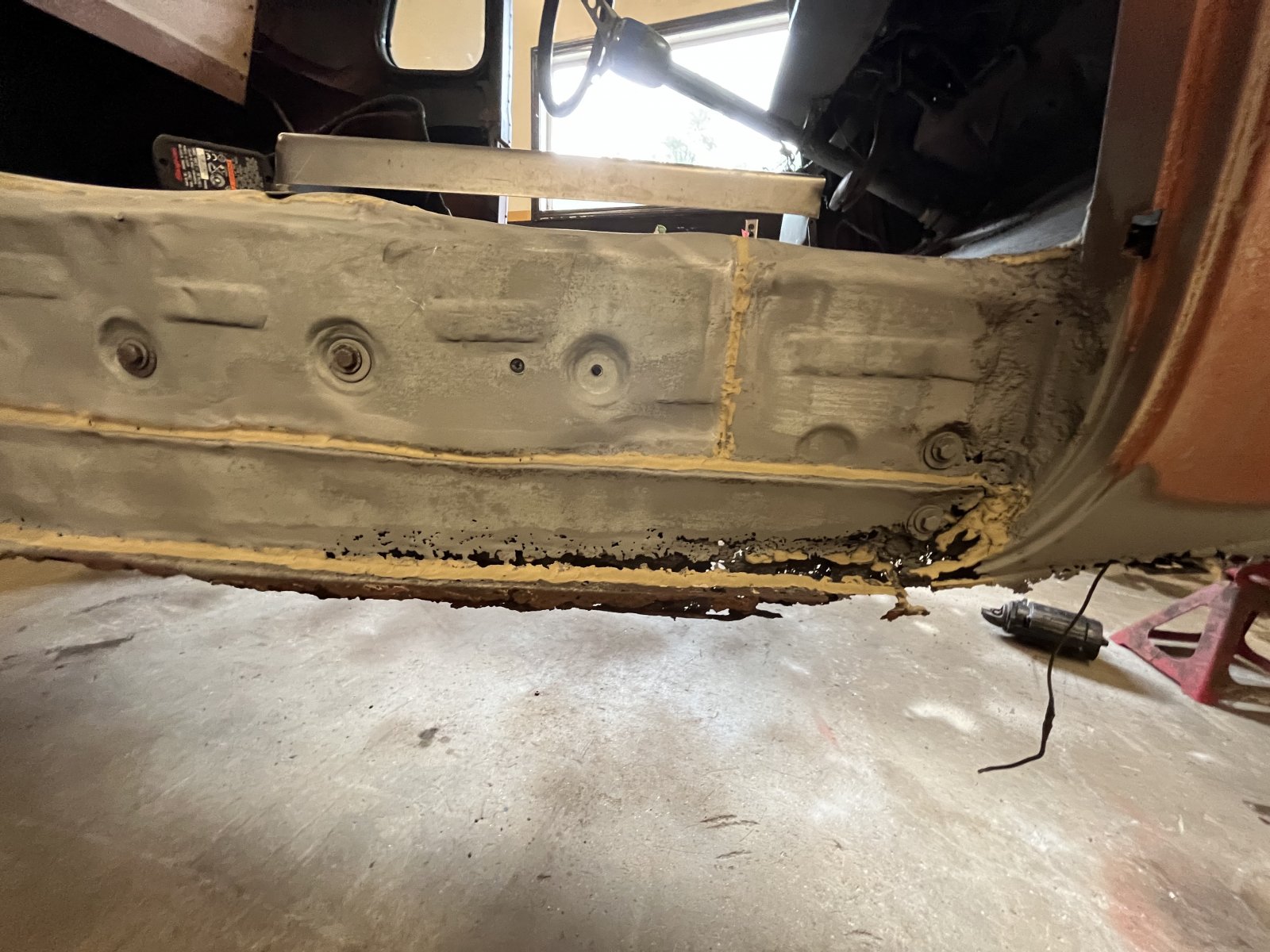

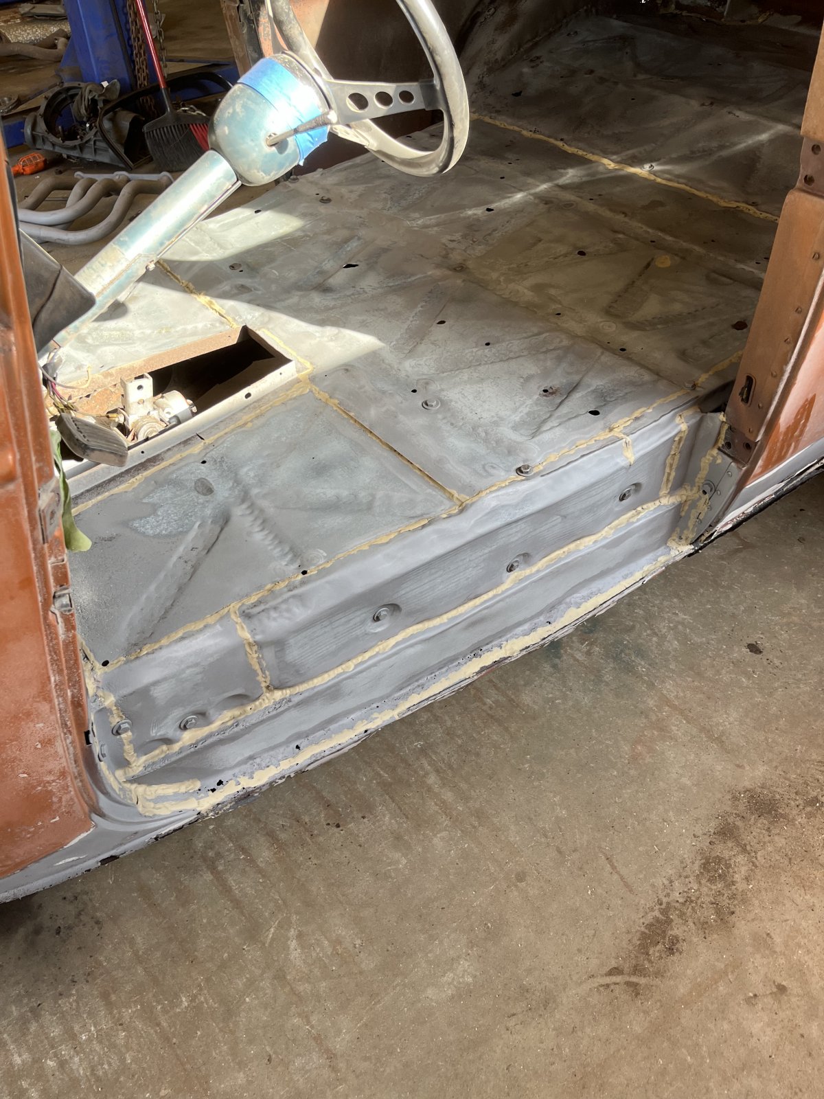

    Whoever built this coupe spent some serious time on it!
    1848F82A-AB51-49F7-BF50-F95903BB51F0.jpeg 32EF18E2-EB0E-4F1C-BC74-C625474D2D5F.jpeg 128DC7A7-8B97-4EF2-8D1A-E3DE4A30AF77.jpeg 1C058421-2362-4F38-B427-728E05BAEED1.jpeg 41229CFC-4758-4473-99B7-D4B8FFE9BA03.jpeg 809C0F9B-7E92-461B-AAE9-97EAAEB8536B.jpeg 27764172-B459-42B1-AA60-37197C1CC648.jpeg 51112093-24FC-4E5F-B1E4-27B53138D577.jpeg

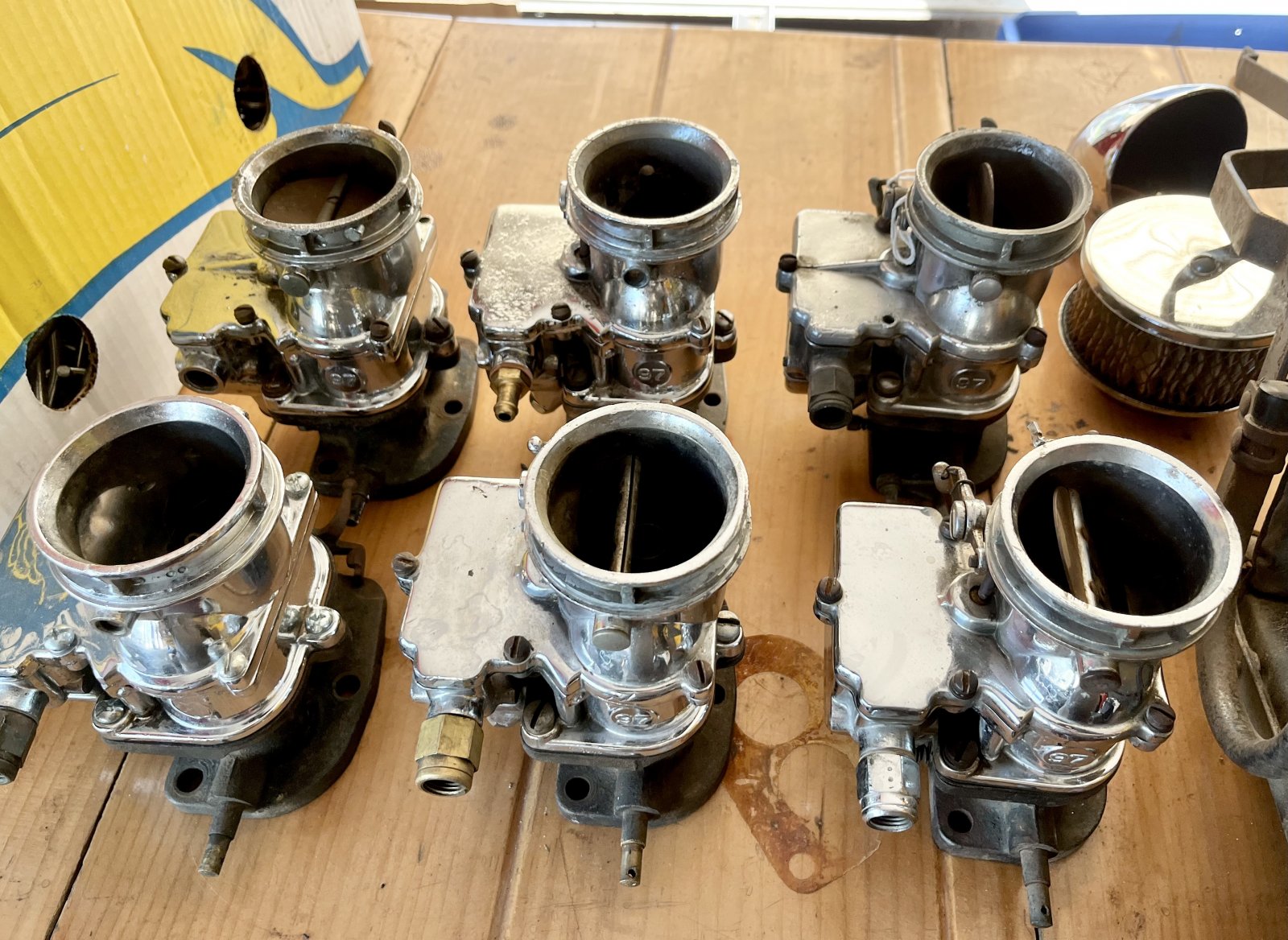

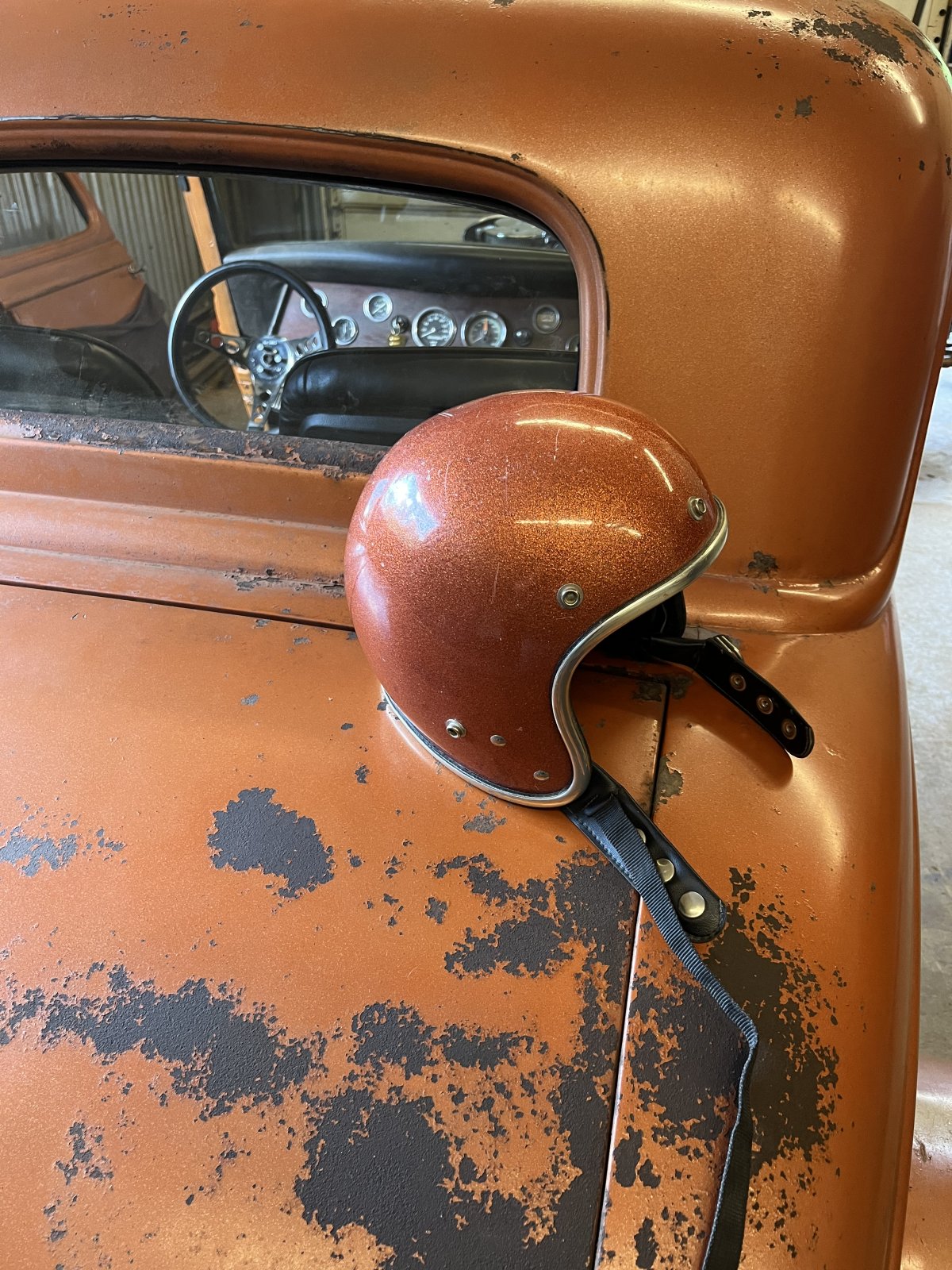

    Found this cool old 60’s helmet at the New England Dragway swap meet… couldn’t resist!!
    Also found these babies on eBay… from 6 different sellers!
    deadbeat, TFoch, WC145 and 14 others like this.

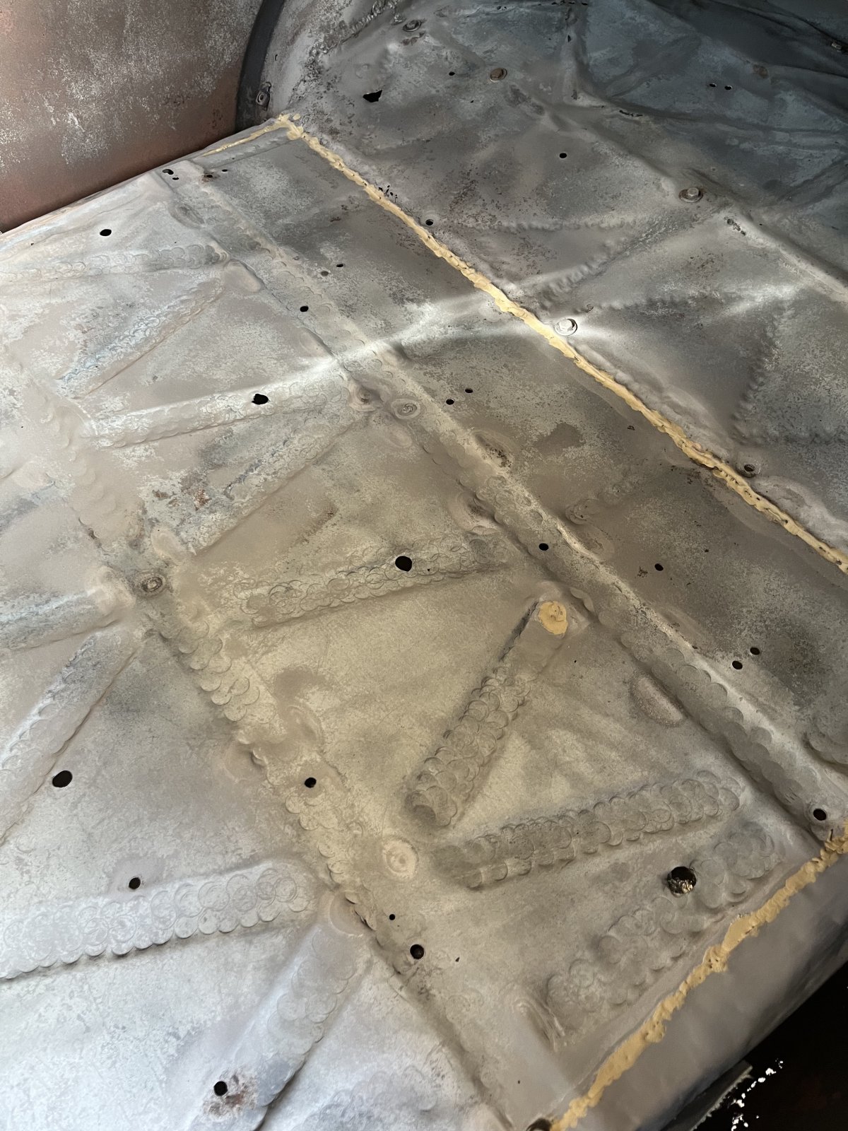

  21. -Brent-
    Joined: Nov 20, 2006
    Posts: 7,719
    -Brent-
    That floor work is impressive. It's wonderful that it survived.
    Father Ray's work looks incredible. This car is really coming along.

  22. alchemy
    Joined: Sep 27, 2002
    Posts: 22,336
    alchemy
    Is your Father going to replace the rockers as well?
    The hand beaded floor panels are amazing. I never would have thought that some hot rodder in the 60's would spend the extra time to hand form those beads.
    Thor1, anothercarguy, SS327 and 3 others like this.
  23. Shaun1162
    Joined: Feb 22, 2010
    Posts: 973
    Shaun1162
    They are cool! I’m not looking forward to cutting them apart to repair the rot, but it’ll be worth it to save em!
    That’s neat, they are pretty cool old headlights. A friend of mine donated a pair to help repair these ones, I probably couldn’t have used them if he hadn’t. I haven’t tried to contact Lee yet, but thank you for the tip! I’ll see if I can get in touch with him.
    It is impressive, they definitely had some talent to pull it off.
    Nah I’ll probably end up doing the bottom panels. I’ve got new rockers and rear quarter pieces, and original Ford cowl pieces to graft in.

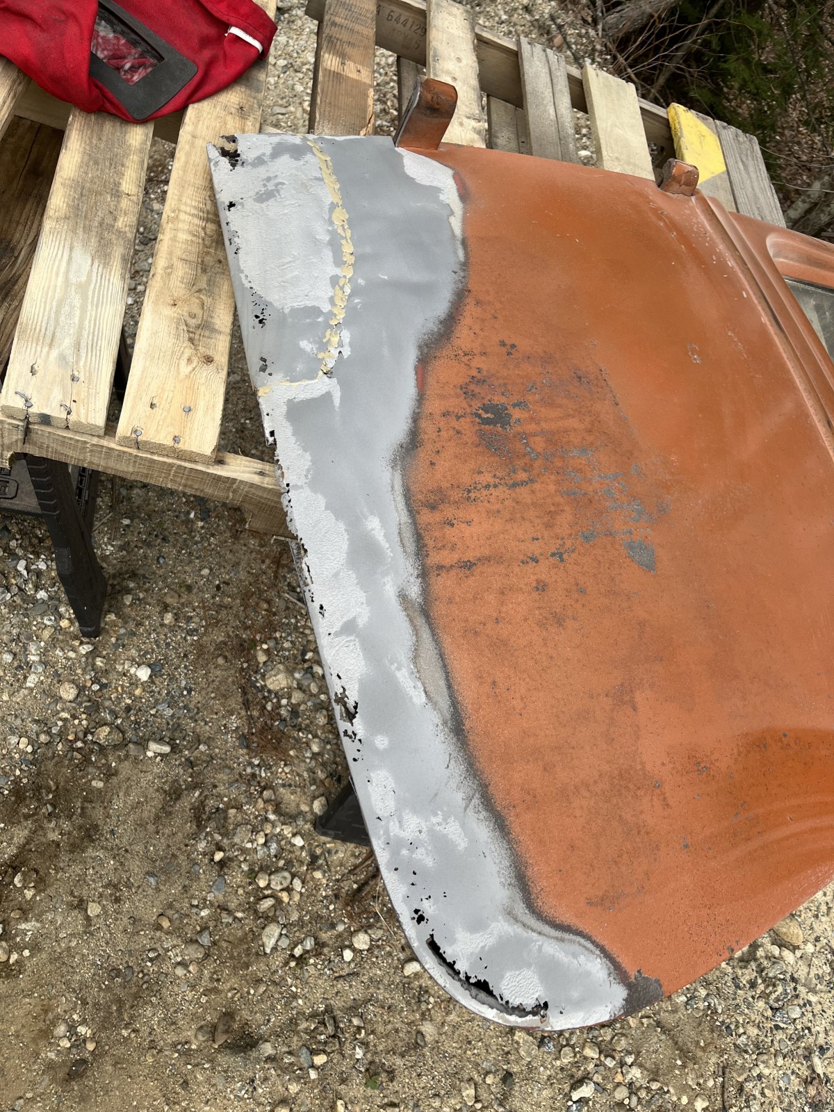

  26. Shaun1162
    Posts: 973
    Shaun1162
    Yup. I opened that can of worms.

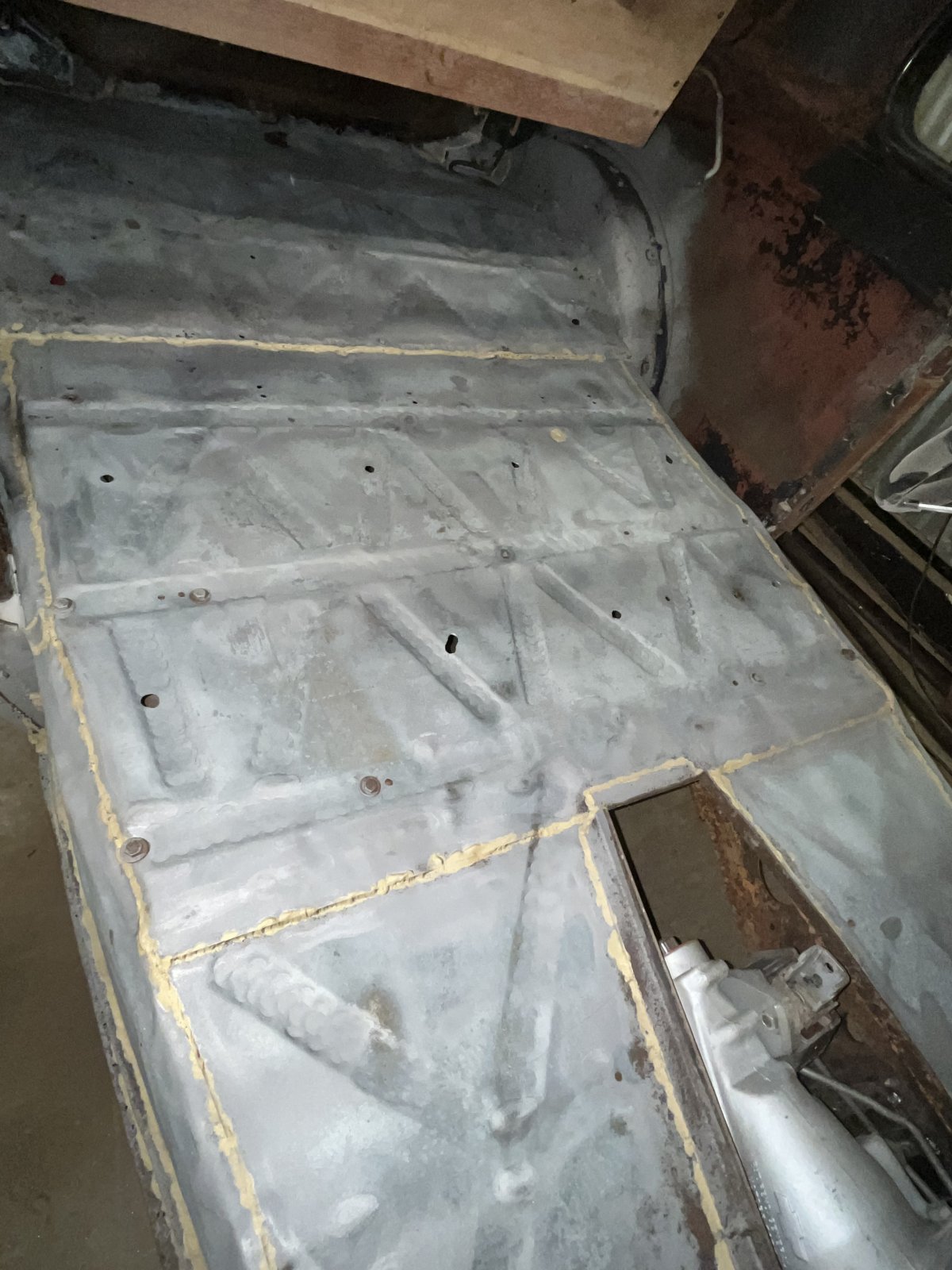

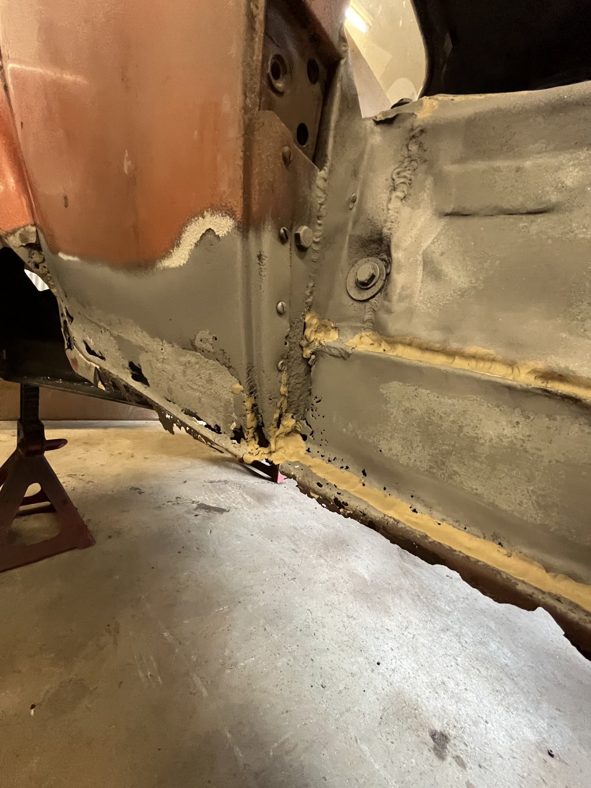

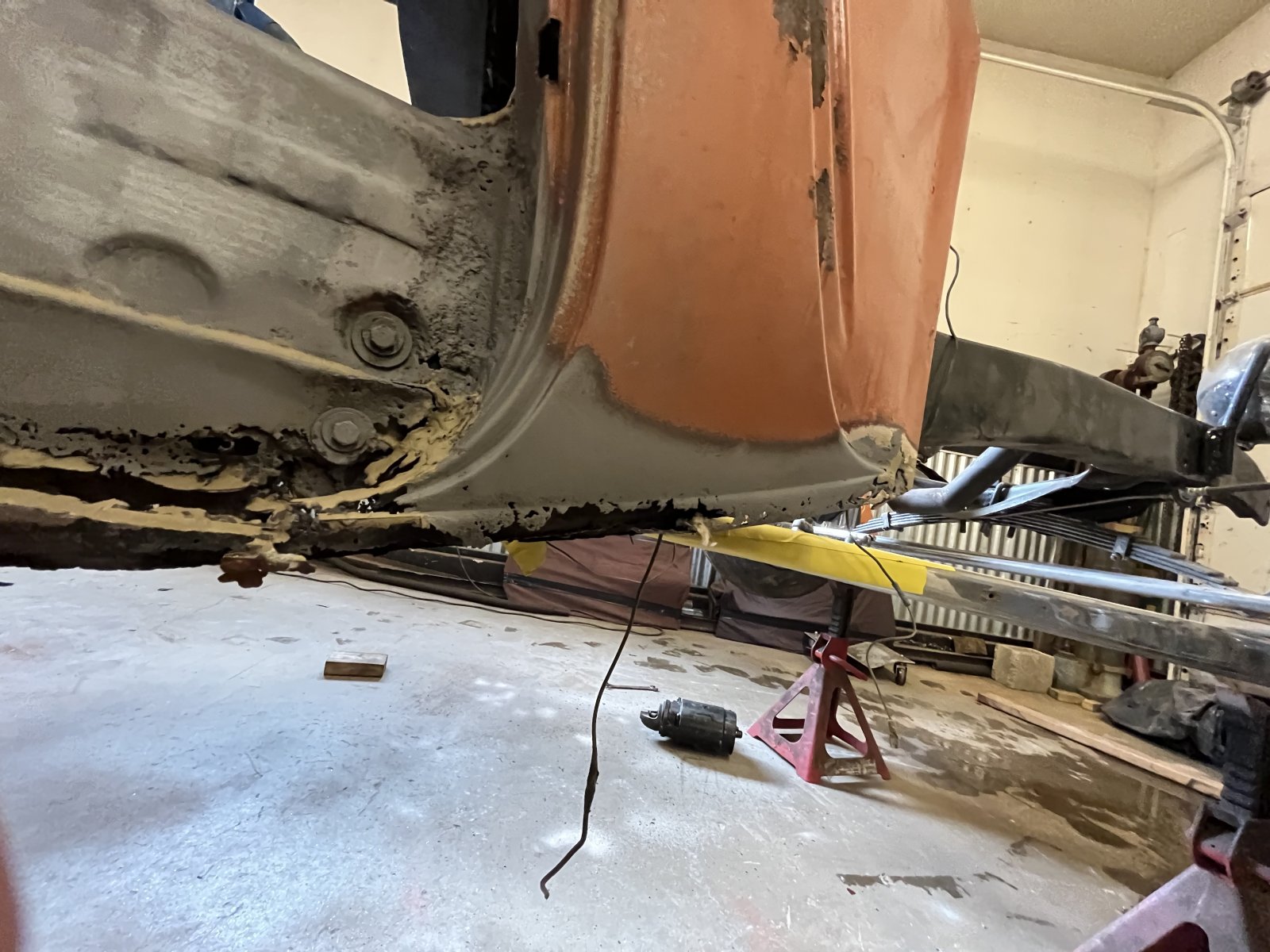

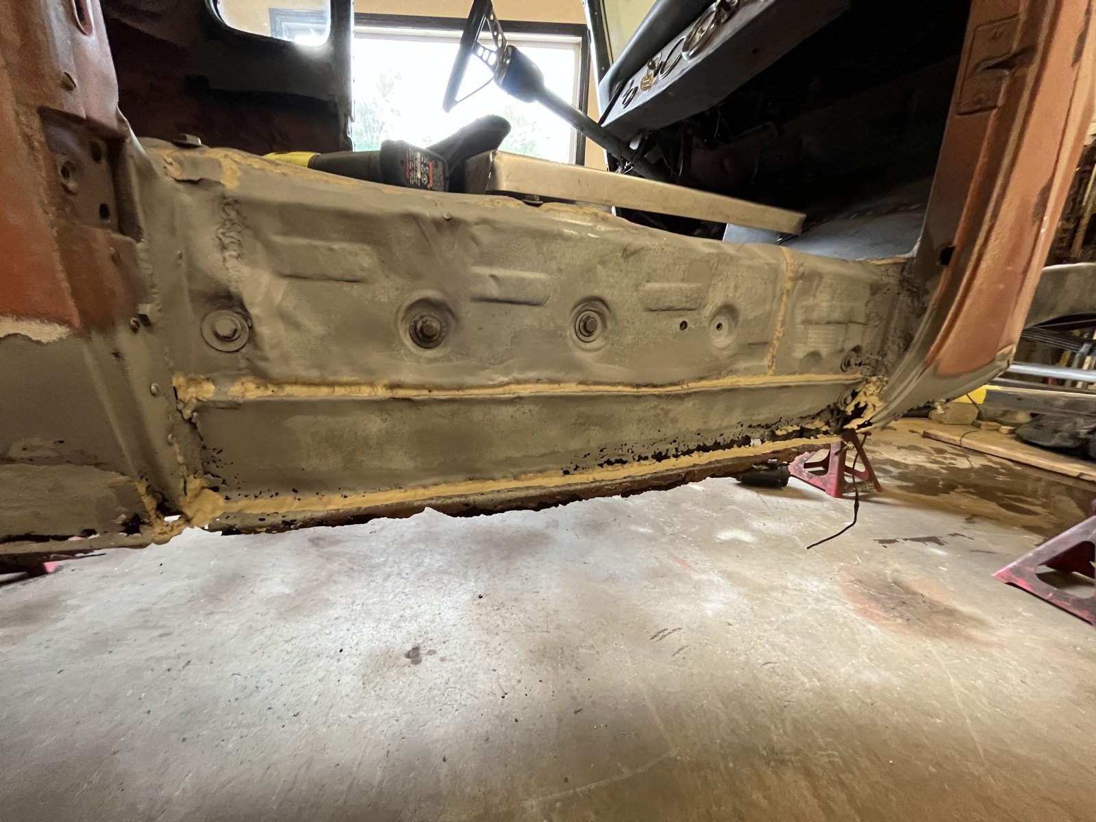

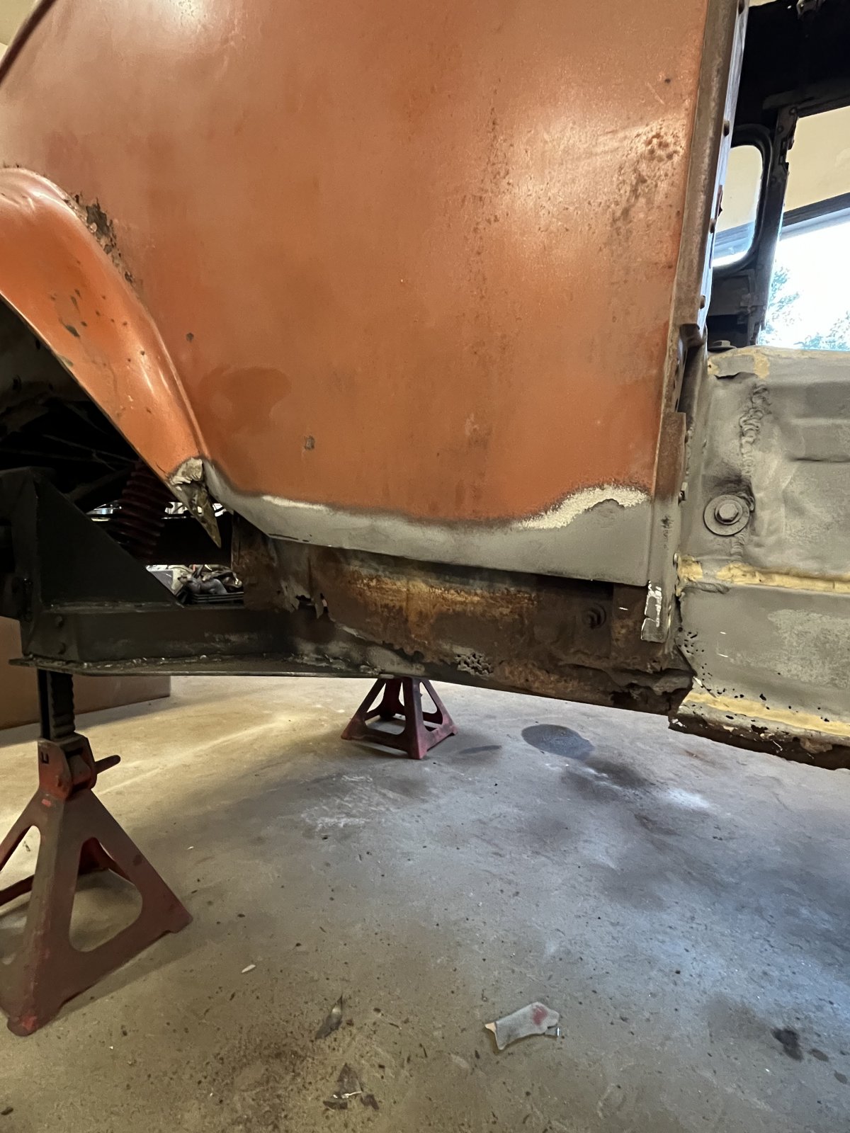

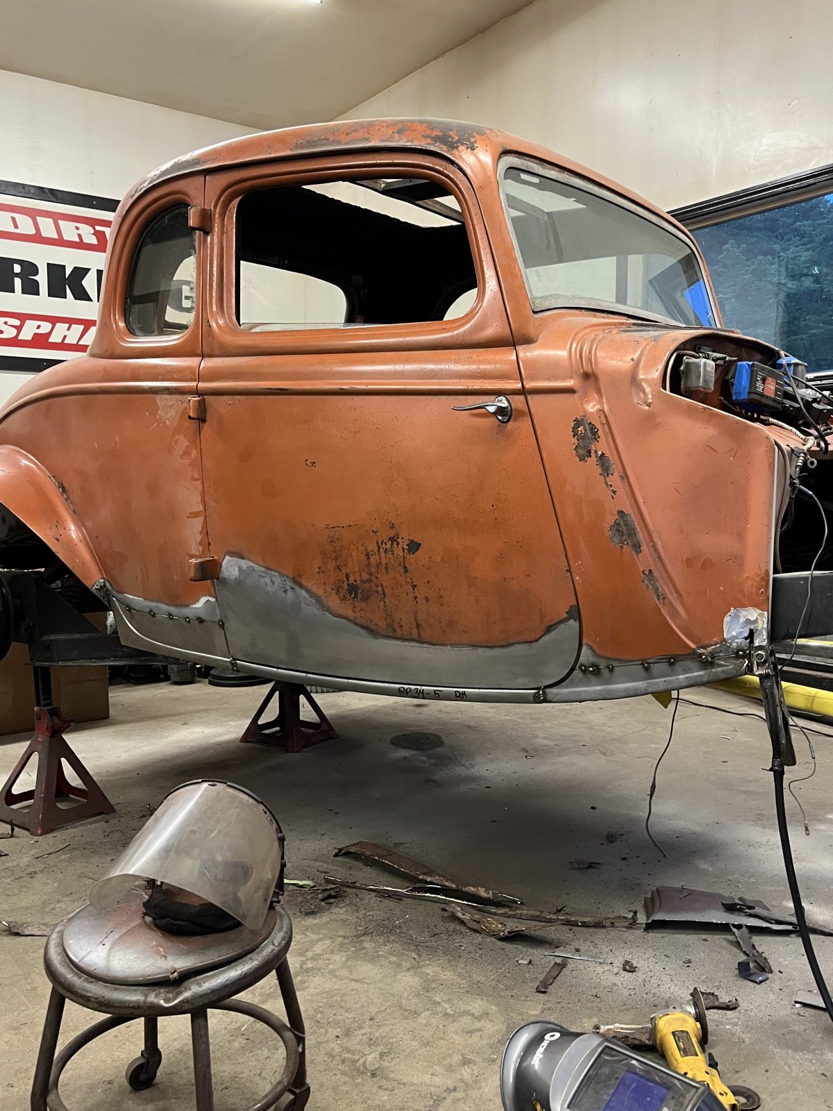

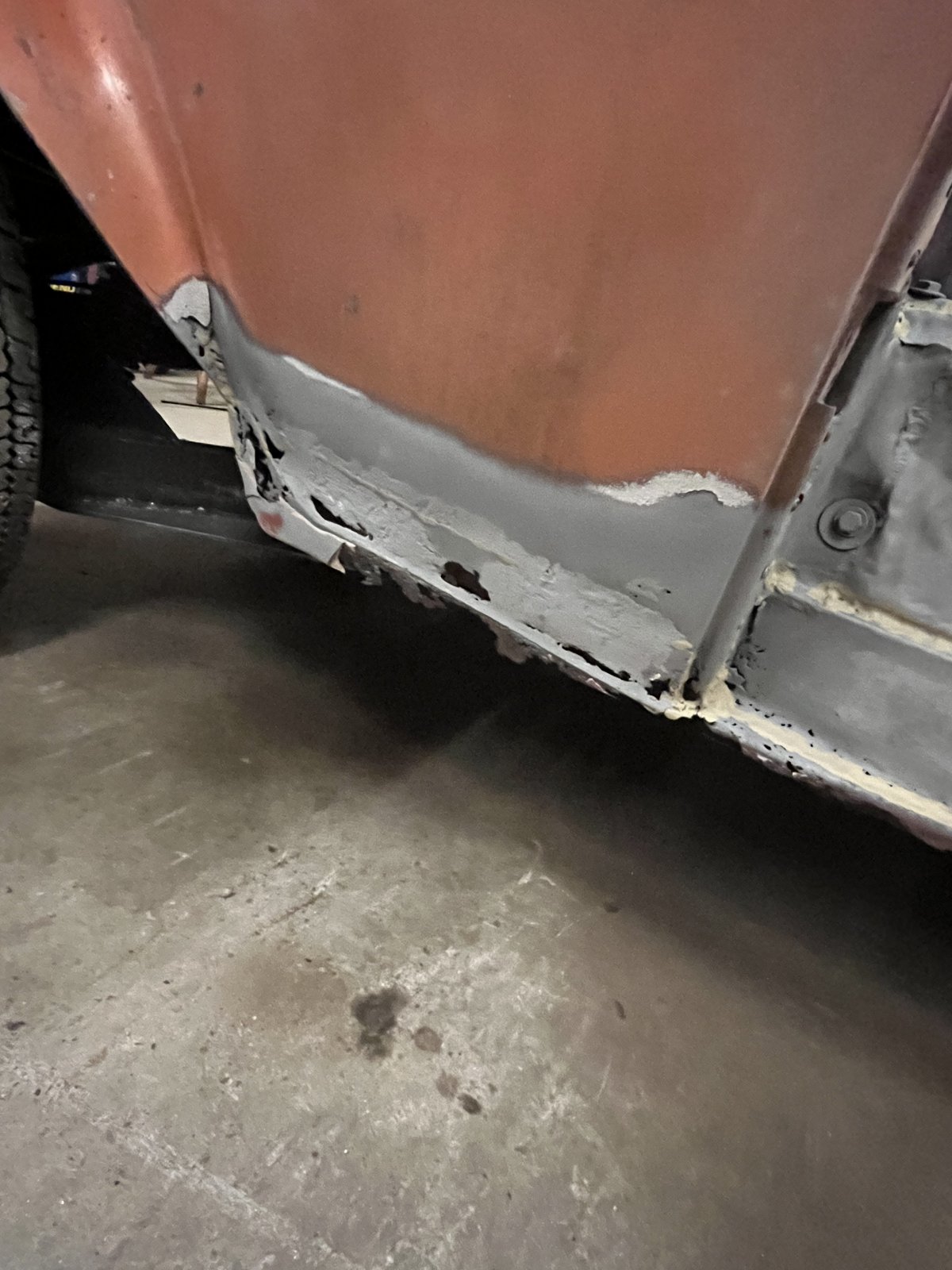

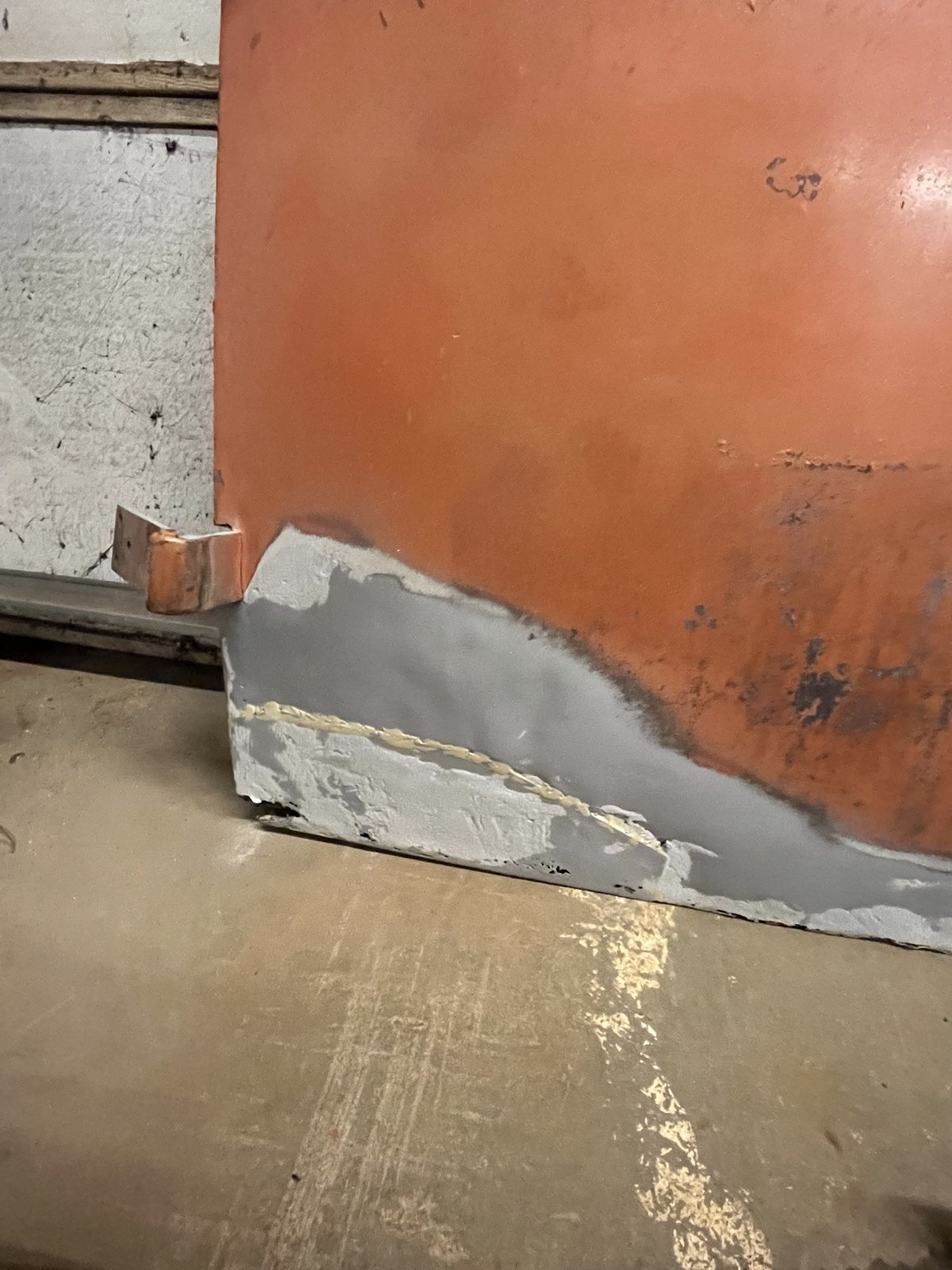

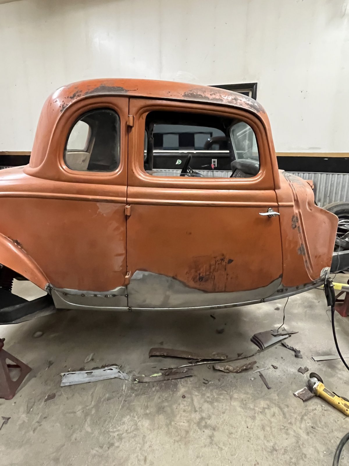

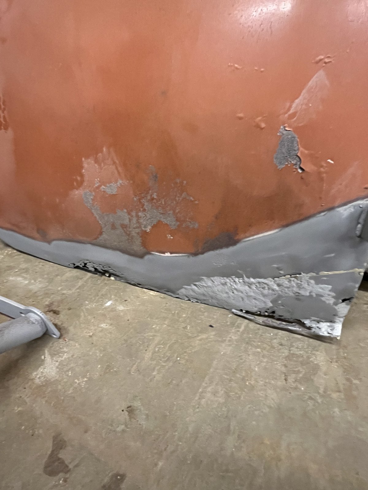

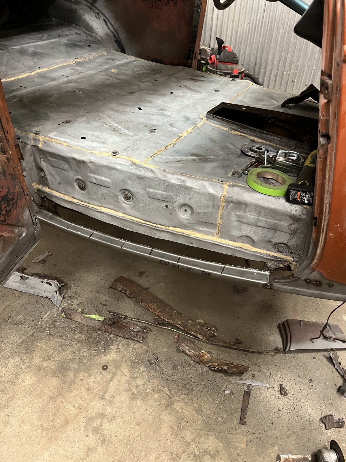

    I cut out the inner and outer panels. Tacking the outer panels where I want em, then I’ll make up some new inner pieces. Metal around the rot is still very solid.
    Patch panels for these still suck. Rear quarter patches are like 1/4” narrow, and the rockers have almost no crown to the panel to match the door crown. I probably should have pie cut in more places…. Trying not to go too crazy with a brazed together 7” channel job car- I just want to drive it!!
    CEC9F0C5-3DDB-49E4-8D33-F853E89108F8.jpeg 666BFFCB-28F4-43B0-AF9F-1EDF9DD07483.jpeg 14282732-3B2F-4128-89B2-7F165B9F165C.jpeg 620DE771-FE8E-4309-A770-9FAA9E3B0585.jpeg EFC31AD4-B243-4022-A40F-7EE0F9E8A8AD.jpeg
    290C5A56-6E0A-4F43-8A20-D7DF6A739E3D.jpeg CB85FB26-2DB4-4BD8-BF3B-47E242DF526B.jpeg 5D138EFD-2E18-4374-8EB5-B7188685E22B.jpeg 58488CB1-7A4C-4ED3-B0B1-B78C5D8CDB92.jpeg

  27. It certainly looks a lot better now. Tedious work, you did a good job.

    Thanks! Yes, definitely tedious… Been a few years since I’ve done much body work. I’m afraid the outside panels are the easy part- not looking forward to laying underneath and welding all the inner panels!
