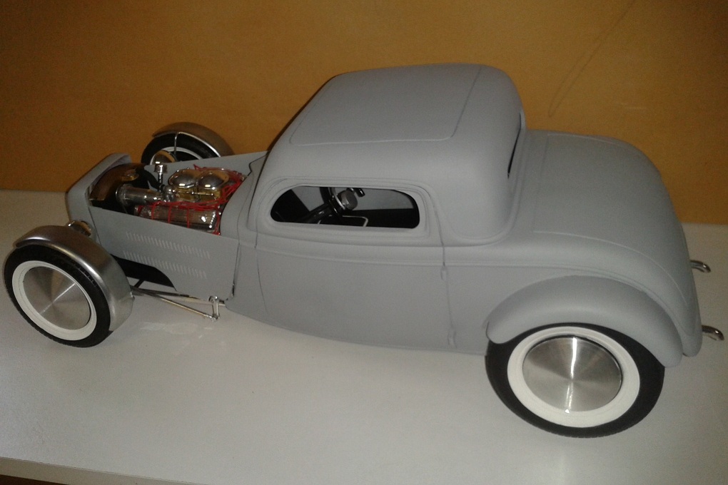

  13. This George Zurowski 1/8 Scale 1932 Ford 5W will be black full-fendered and flathead-powered with chrome rims and baby moons. Interior would need to be scratch built. Not a big deal. Will eventually place this Coupe in a 1/8 scale garage with a Highboy Roadster and T Bucket.
    Deuces likes this.
  14. big duece
    Joined: Jul 28, 2008
    Posts: 6,978
    big duece
    from kansas
    I chopped one of George's 5 window's to look like the milner car and sent it back to him to cast it. Chopped the grill/shell, bobbed the rear fenders, made a man-a-fre out of the 6x2 intake. I got all the masters back plus resin pops, except the 5w body. He passed on shortly after.

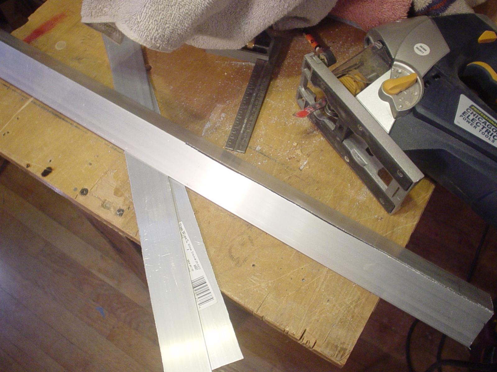

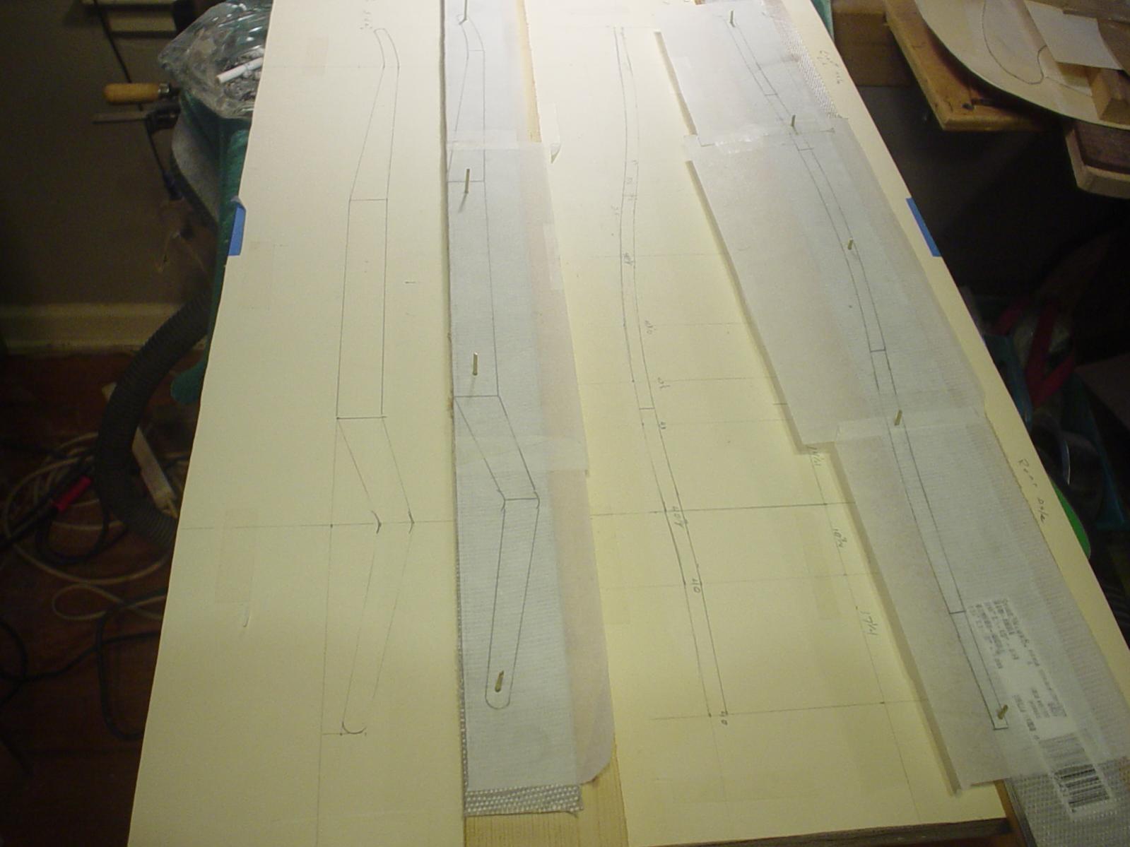

    Thought I'd bump this thread, as I've become interested in the 1:8 scale.
    Since retiring, the ole budget won't allow for another 1:1 build, so I'm planning a miniature 1:8 project in metal instead.
    Curious if there are any large scale scratch builders reading this page.
    Been researching using aluminum vs brass, as scrap alum is everywhere for the taking, as well as being lighter & stronger.
    I've come up with enough free 1/16 thick material to do a 32 frame that I've drawn up in 1:8.
    From what I've read, the main problem with using alum is difficulty in soldering.
    I've found a product by Muggy weld, called super alloy 1 that melts at 350 deg & has a tensile strength of 20,000 psi.
    Going to get the starter kit & see how it works.

    Cool!.... Let us know and take plenty of pictures...:)

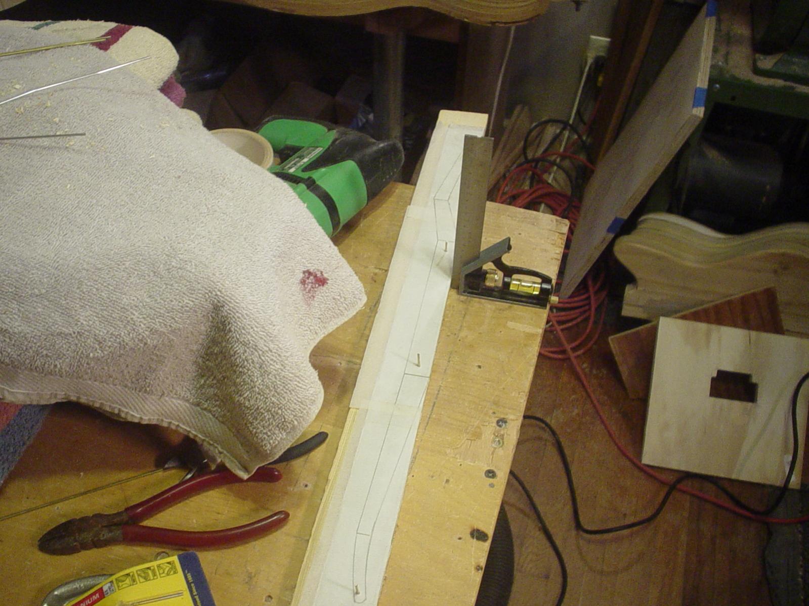

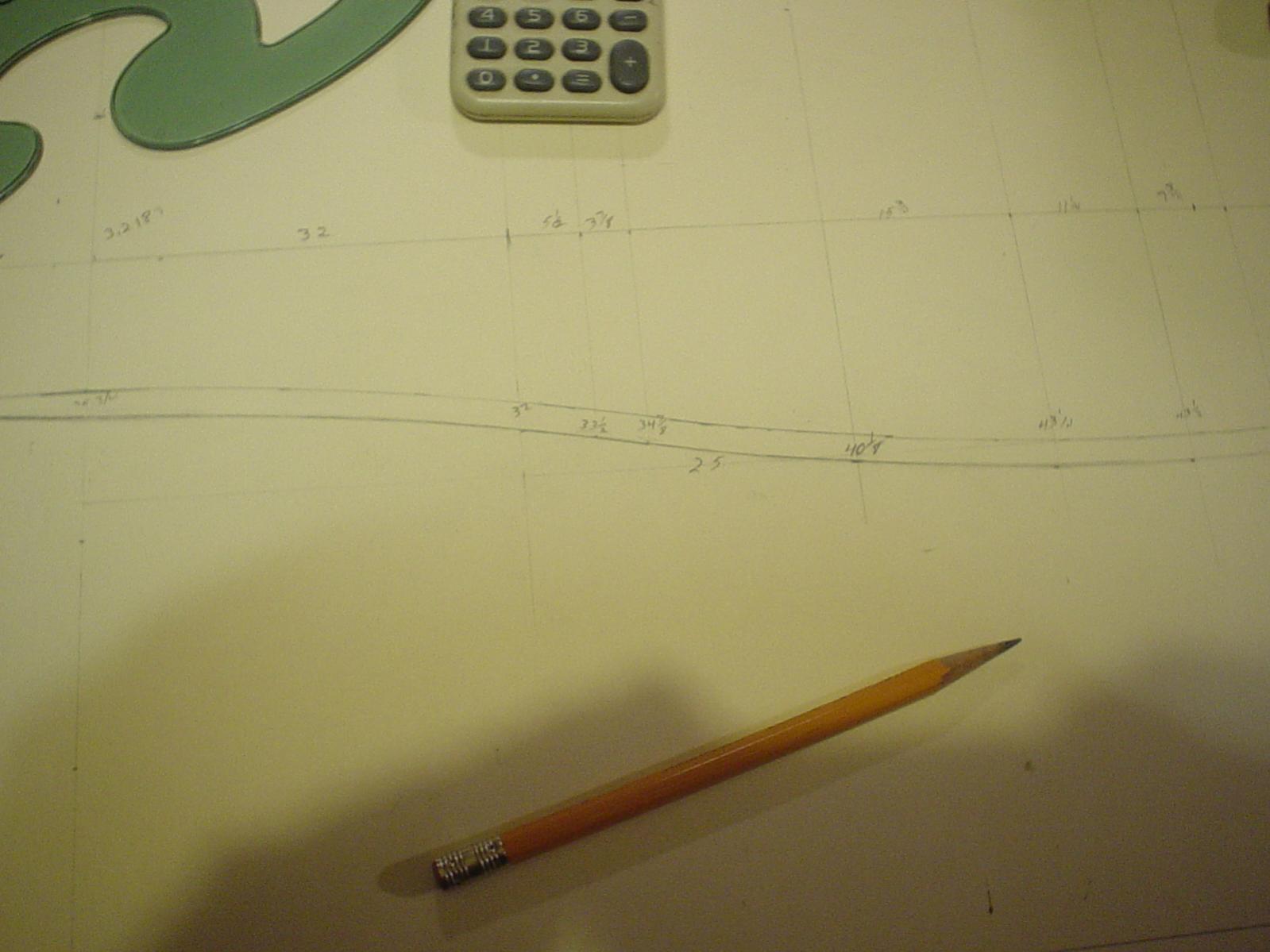

    After drawing the frame in scale, I overlayed with tracing paper & re-drew everything.

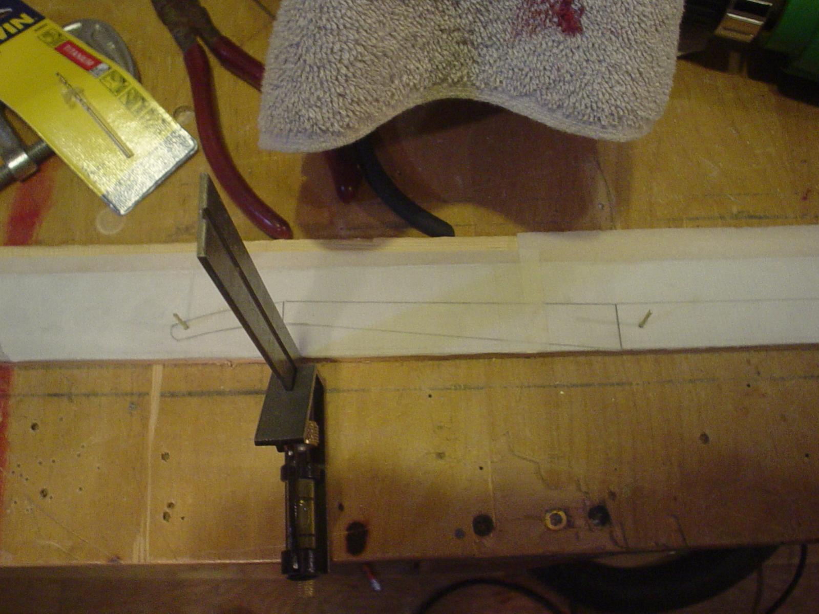

    After cutting the 1 1/2" angle down the spine, I stacked the appropriate number of alum pieces...two for the side rails & four for the top bottom pieces, attached the tracing paper overlays with double sided tape & pinned the stacks to a strip of pine to hold them for cutting to shape.
    When I get them shaped, I'll use them for laying out assembly jigs to hold everything for soldering top & bottom rails to the sides.
    Deuces likes this.

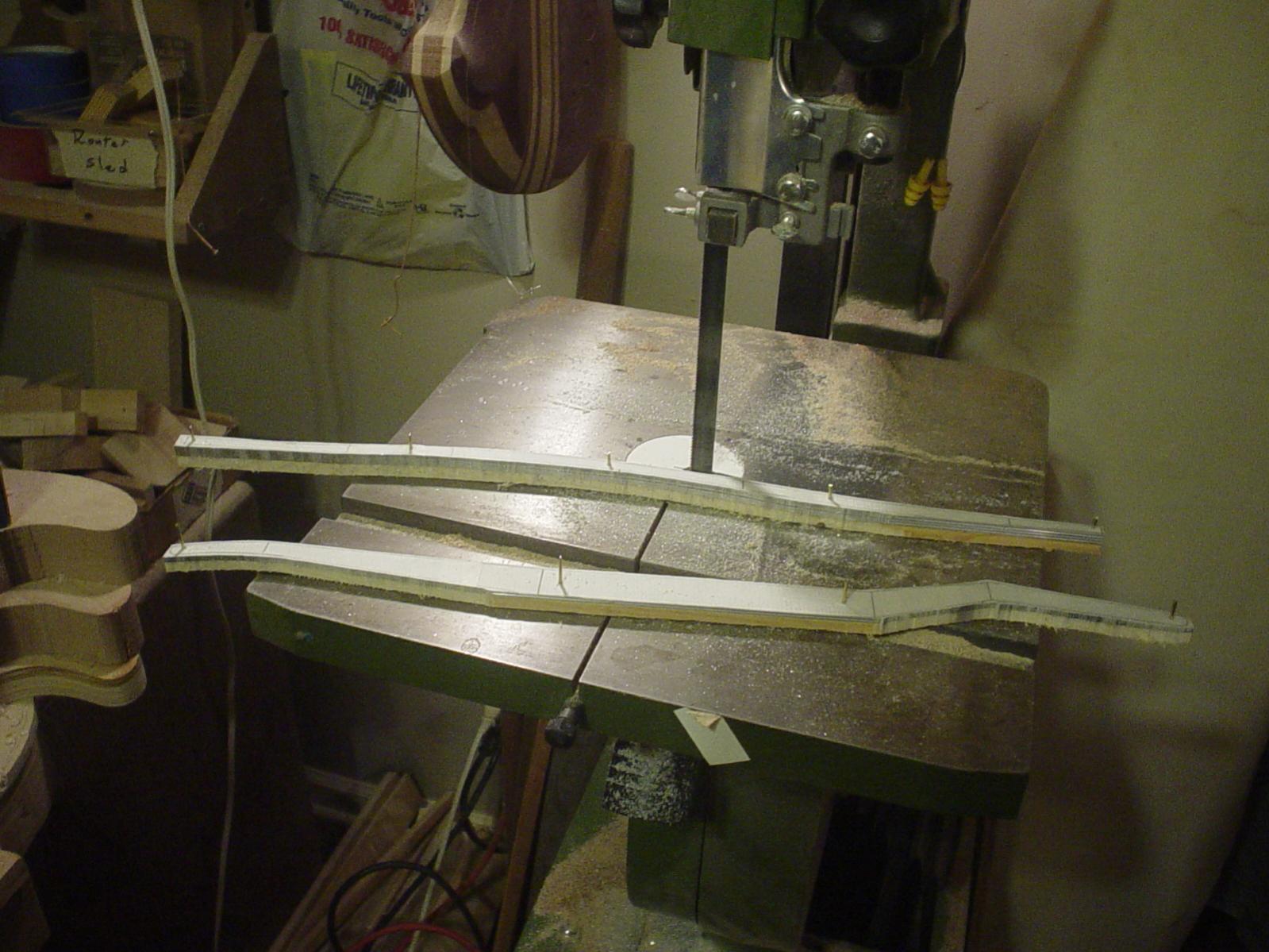

  27. Ognib
    Joined: Mar 15, 2013
    Posts: 113
    Ognib
    from Mo

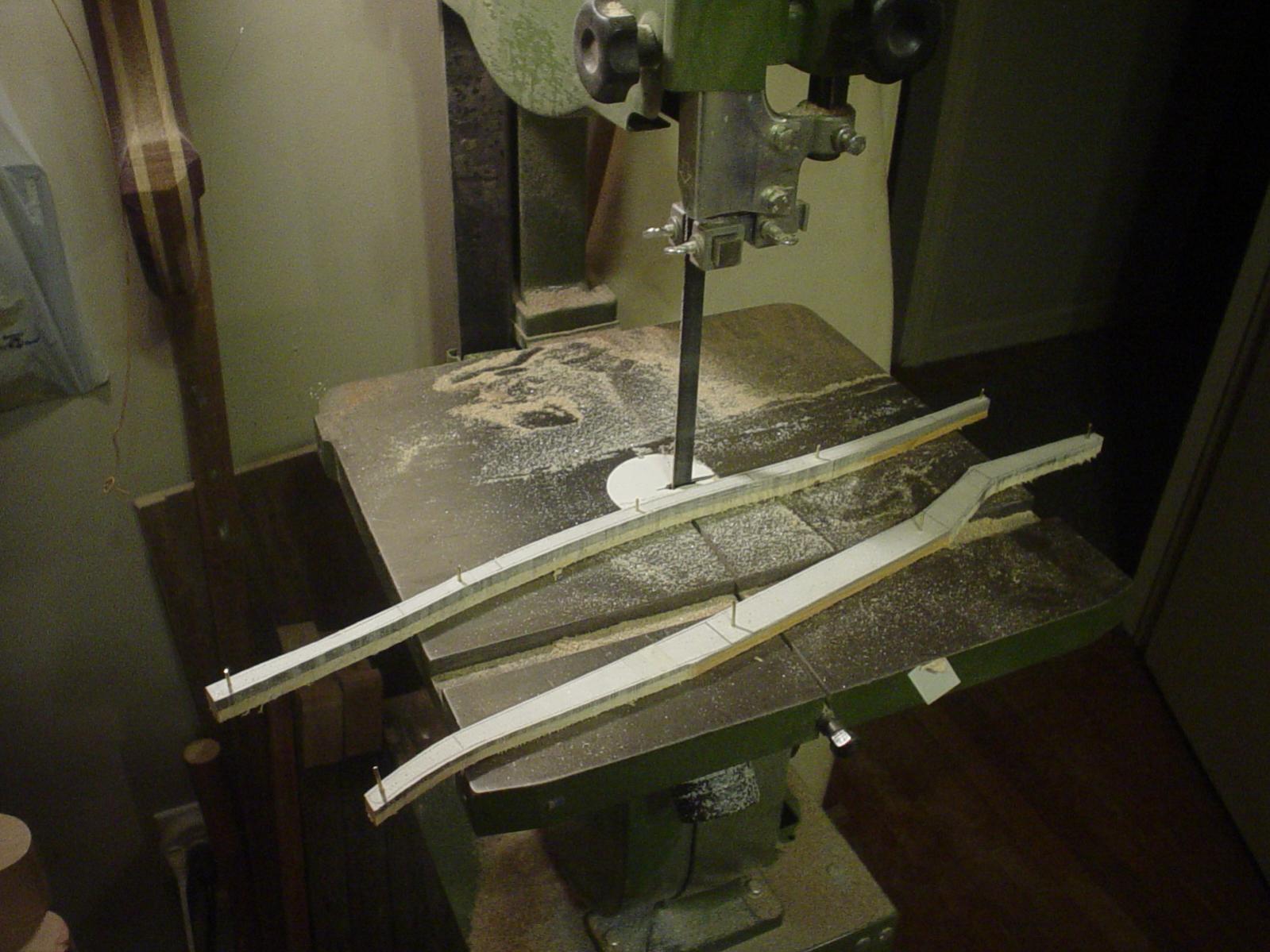

    I roughed them in on the bandsaw.
    I used a 14 tpi raker blade that's rated for woods & soft non-ferrous metals.
    Ready for final shaping.
    Deuces likes this.

    I'm digging the custom guitar bodies, use to make those too....
