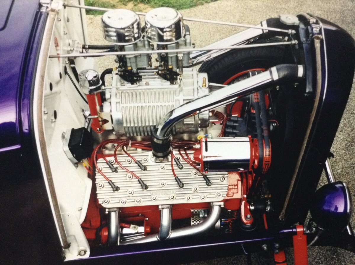

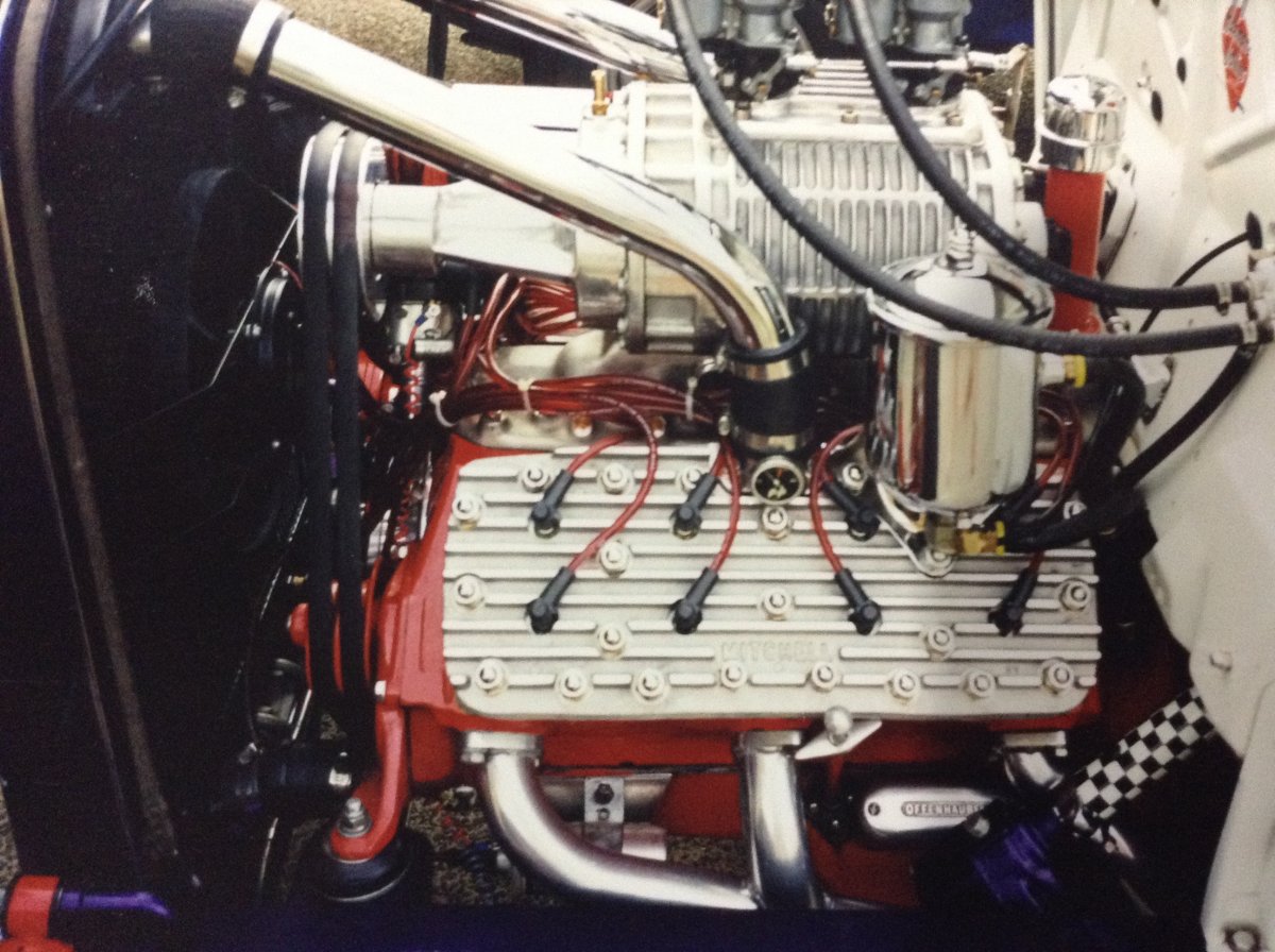

    image.jpeg Short answer is yes, I run duel V pulleys with my 4-71 in my 32, stock firewall with trimmed A image.jpeg image.jpeg front x member and stock wishbone mount.

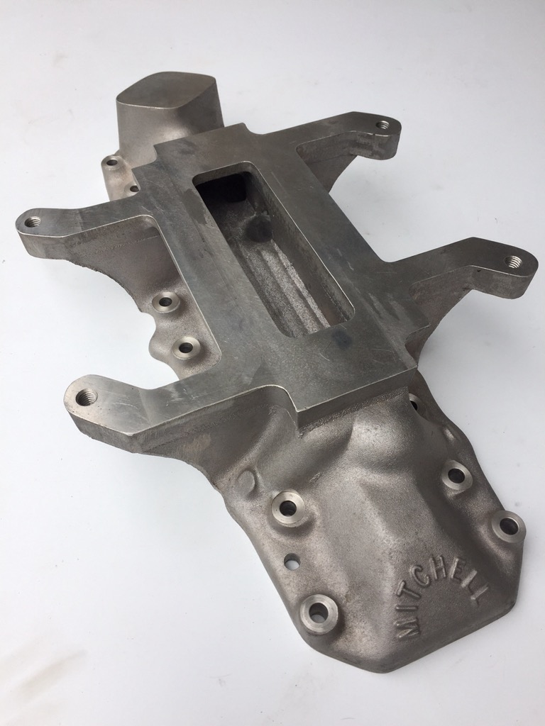

    I am building up a triple pulley setup for a customer now using one of my intakes for a 32 will post pics when it's installed.
    Here is some pics of my old setup still with duel belts

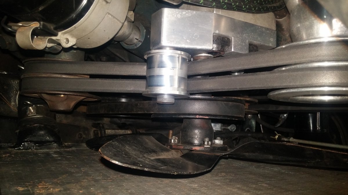

    I'm running a S.Co.T. on an 8BA It's a tight squeeze, it can be done. I had a wide three sheave crank pulley machined . The dizzy is a old cut down Chevy Mallory flat cap with a tach drive. The extended shaft allows for more belt room.If I were to do it again, I would use the truck water pumps and use frame mounts.

    Could you show a picture of how you did the fan mount. Thanks Joe

    I found a 17.5 in diameter fan and bolted it to the standard Ford mount. To adjust the belt the mount slides up and down in the aluminum idler bracket. The real bitch is the bottom radiator hoses, there is such little clearance between the radiator and the pumps and they do not line up. I have to pull the radiator off to change them. Fortunately that doesn't have to be done frequently. My grill shell is in the stock location and I can install the hood.

    Thank You, Thats the cleanest way I have seen it done. Joe
