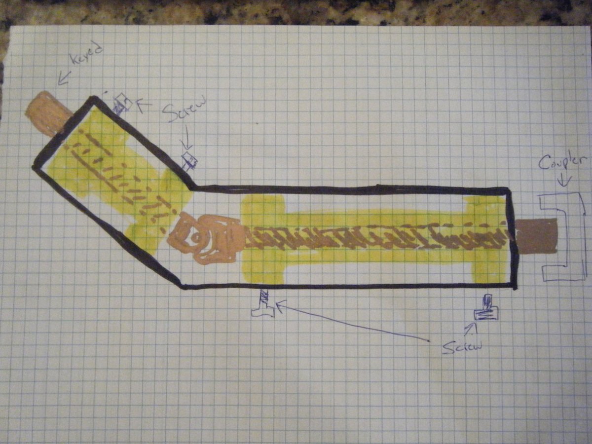

  7. if it was made with borgeson u joints and shafts that were preassembled then slid into the bent column and then the solid bushings slid into each end. the bushings could be set screwed in place. of course the bend in the column would have to be large enough to allow the short [upper] end of the shaft to pass through it and the u joint would have to be narrow. in the photo the upper is real short.
    it would be fun to take some exhaust pipe and joints and see how tight/long you could get away with.

  11. If there is a upper bearing in the long sextion you'll not get it at all. If there's no bearing up there I'd bet it want to wobble. Quicky sketch will tell you that its very little bend and still get the shaft thru.

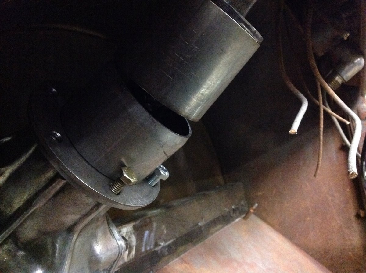

  19. Hard to get a shot under there and early mock up.
    There's a u joint in there that needs access.
    mounting plate on the box.
    Mounting plate for external holes
    Belled 3" exhausted pipe to clear internal bolt circle and
    3" pipe mitered (yet to be done in the picture.) that will be welded.
    Transition to 1-1/2" and mounting plates for it.
    Bearing in the 1-1/2 tube.
    The thing starts at the box and stack up to end at the steering wheel.
    All that to get the wheel out of the guys lap.
    Plus I had to cut into the dash and need to make a new doohickey that looks like it's 100 years old

  21. what i was thinking; black is the mast, yellow is the long bushings, and bronze is the shaft.
    slide the shaft assembled into the mast then slide the bushings in from either side and hold in place with set screws. on the lower a short bushing could be slid up the shaft with a long drift, and another for the bottom. DSCF4455.JPG
    Hnstray and Doctorterry like this.

  24. i was just thinking also, how cool would it look if the mast was oval? that would give more room for the shaft to make the corner. of course the bushings would have to be oval with a round hole in the center.

    Wonderful!!!!! That's sorta what I was thinking.
