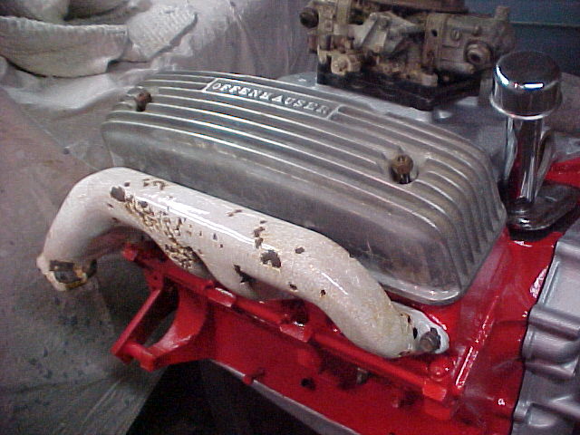

  1. I want to re-do my headers with porcelain as they were done in the 60's.Anybody do them?Would prefer Chicago area.

  6. I have another set. I will try the powder coat.These are just too cool and the coating is VERY thick.Just trying to keep this car as it was originally done.

  10. Just for information as I recall it only worked well on cast exhaust. Steel tube headers either took to much vibration or got too hot or both, but I don't remember it staying well on tube headers.

    Jaguar used to porcelain coat their exhaust manifolds. They were cast iron.
    Over time the porcelain would start to show tiny cracks, especially if you drove through rain puddles. The sudden cooling was hard on them.
