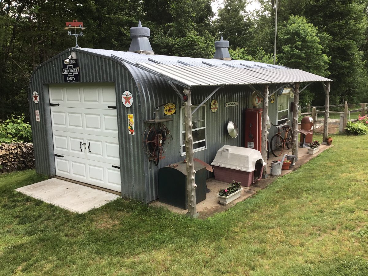

    I built one on a cement slab, real cheap build.It is 18 years old now and was only about 5k back then. 303B4AEF-4422-4901-8648-9E842EABDA70.jpeg

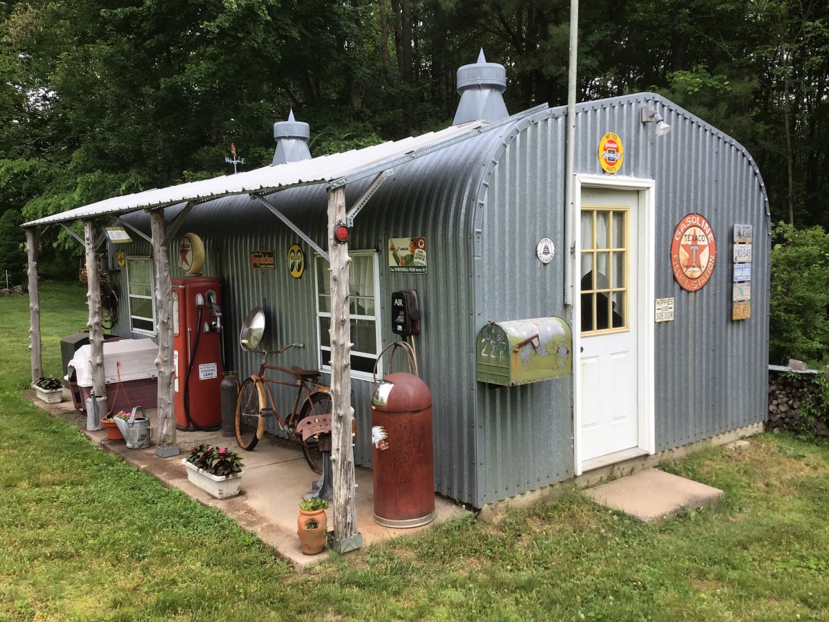

    I forgot to say it came in 3’ sections, mine is 12’x 24’. The overhang I added years later to give it the look. I used it only to store a car, Now yard equipment, if was to build one in it I would go wider and 30”deep. B3D740D8-A9FD-4DBE-9426-CC034C5F37BC.jpeg 73B6A1F6-E290-411E-981E-B8E6B0736471.jpeg

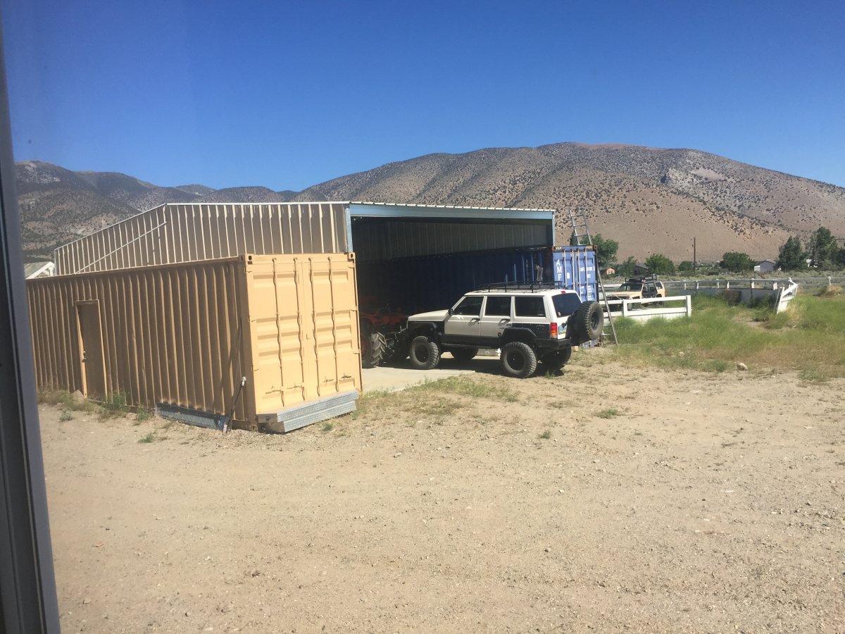

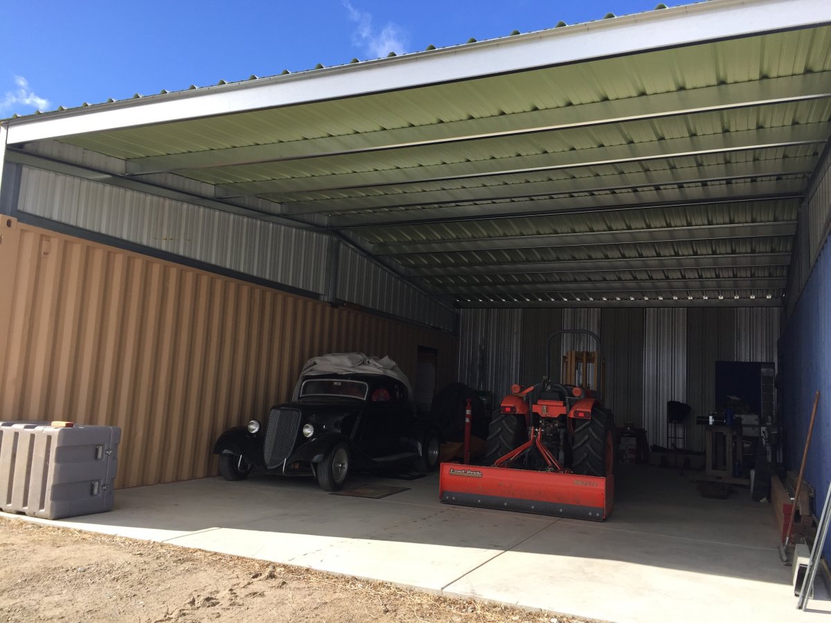

    When I bought my place it didn't have a garage so I bought a couple shipping containers to store all my crap. Then I prepped and set grade placing them 24' apart and poured a 6" slab in between. Roofed and walled it in and cut openings in the container sides. The slab is level with the container floors so I can wheel stuff in and out onto the slab. Worked out pretty good.
    Now trying to decide door configuration, one large in middle or two smaller on each side.
