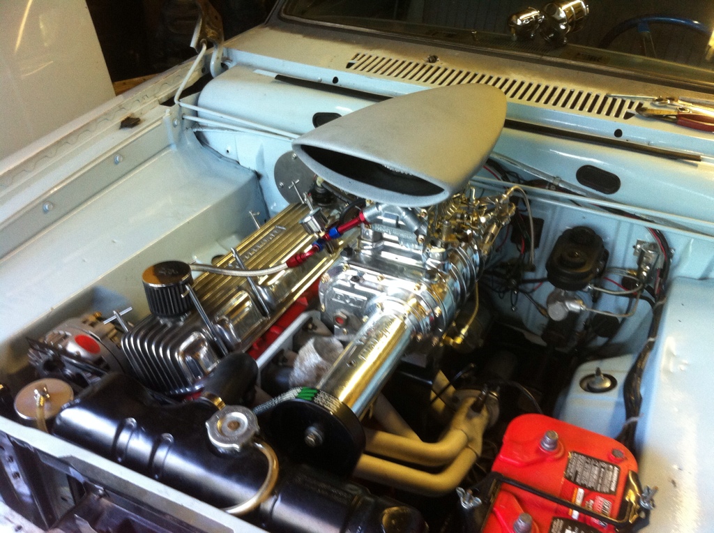

my slant six. still have some tuning to do. starts running lean if you put your foot in it, even with that 600 holley.
Don't confuse carb CFM capacity with the ability to meter fuel and control A/F ratio. The 600 may very well be enough carb for that engine - maybe even too much. More likely the answer will lie in jetting, power valve and air bleed sizing. That, of course, is assuming the cylinder-to-cylinder A/F ratio spread is not large and fuel delivery is adequate.. Good luck with your tuning.
