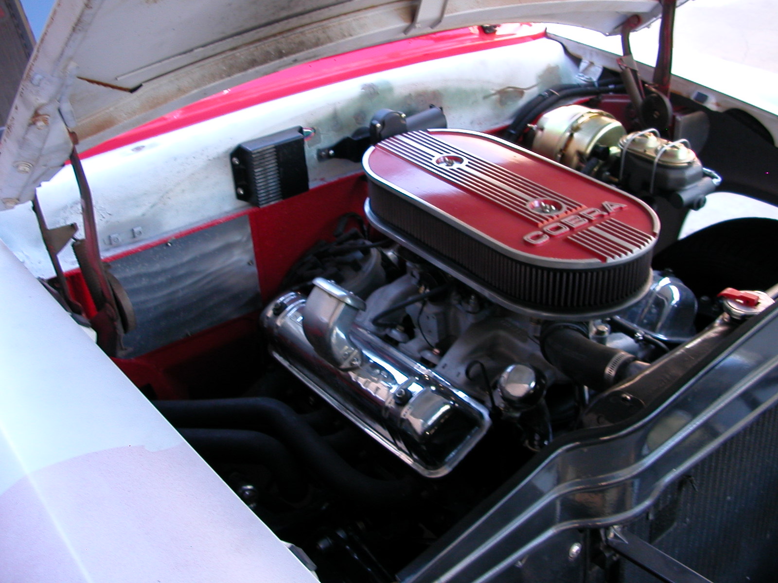

    Heres some pictures of my 368 in my 53. Valve covers were already butchered with the breathers when I got the core motor. .040 over, balanced, isky 270 cam, modified FE bellhousing and flywheel, 4 speed top loader trans from a big block Mustang.
    Chris Pellerin and kidcampbell71 like this.
