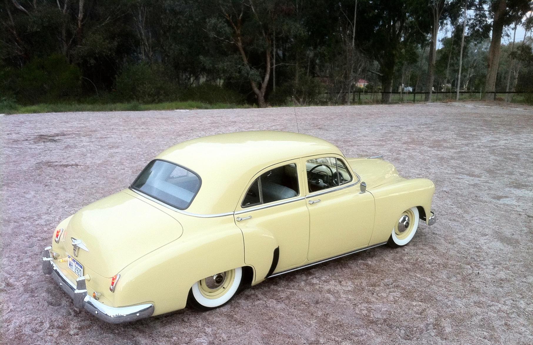

    1. 4 door kustoms

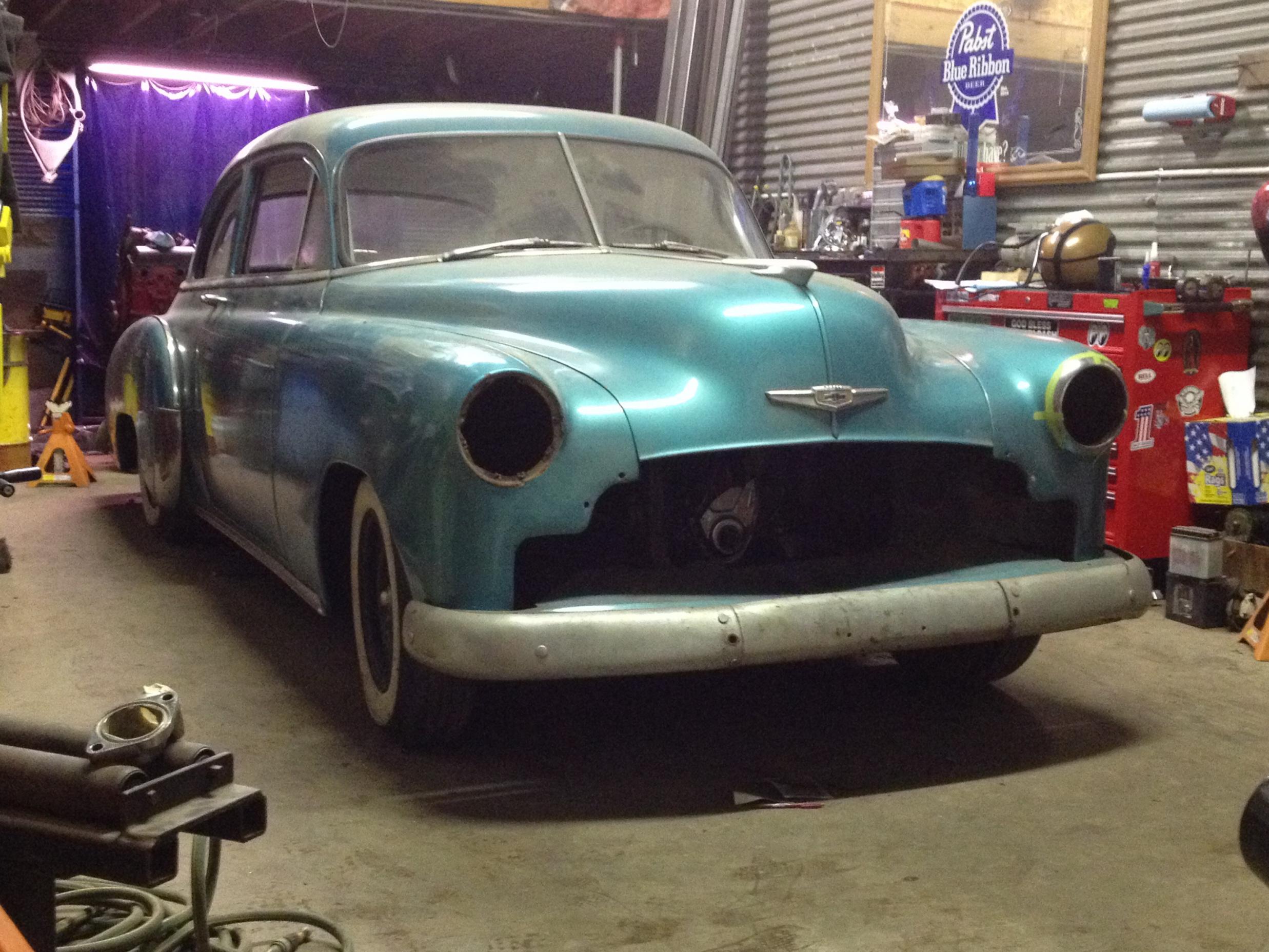

    This is my '50 4 door.
    fatman uprights and 1.5 coils cut up front, leaf pack de-arched and 3" blocks and air shocks in the back. Tires are 6.40-15 BFG silvertowns.

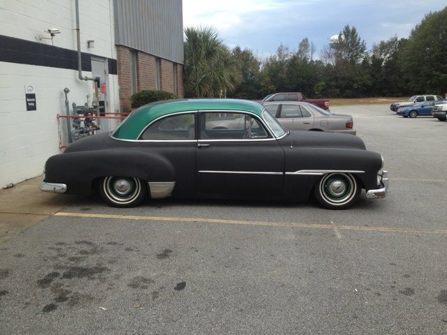

  10. Just dropped the rear of my '51 this weekend 4" blocks on old leaf springs, I have about 1.5" - 2" of travel left.

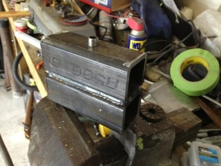

    Next is to step the lower A-arms and cut the coils for the front. I made my own lowering blocks too,(stacked &welded 2"x2"x1/4" box tubing). The best part of all is the box tubing was scrap from work I spent $20 for U-bolts and about $4 at the hardware for the allen-head cap bolts (for alignment pin) so for less than $25 bucks I got the back sitting right, and other than gas and welding wire, the front should be free to lower about 4"s. I'll get to that soon and post pics when I do. Thanks for all the great info in this topic!

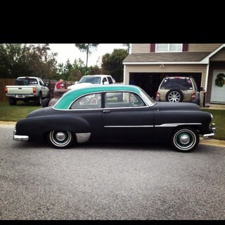

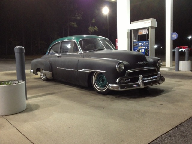

  11. Got the front down now!
    She's low now.....
    Stepped the lower arms, and cut 2 coils off the spring.

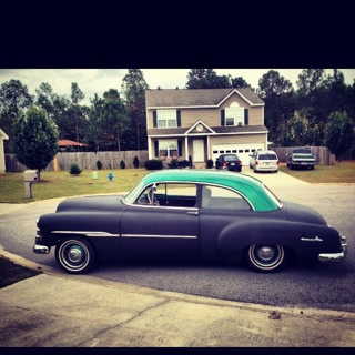

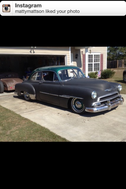

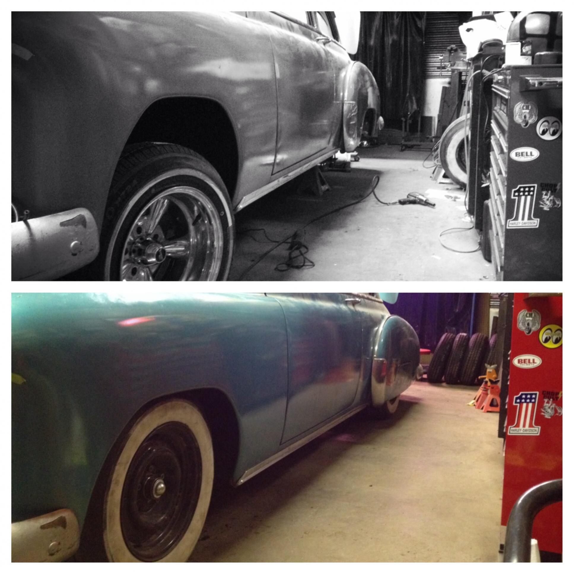

    Sorry for no pics just yet, but I've cut one full coil off front and 3" blocks in back on my '53. Loving the rear (without any further headache), but would like to cut more out of front. Judging by your pics, sounds like another half a coil would be no prob...but would I be pushing it/getting into any other issues/giving up any ride if i were to cut another full coil?? (to = 2 full coils cut) thanks in advance..will try and post my before and after pics.
  21. TRAU 82
    Joined: Nov 28, 2010
    Posts: 24
    TRAU 82
    Here she is in all of her glory..your thoughts much appreciated.

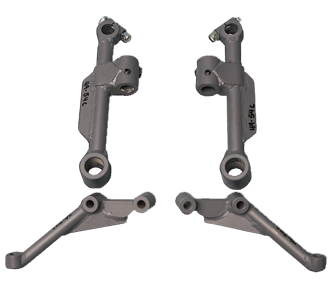

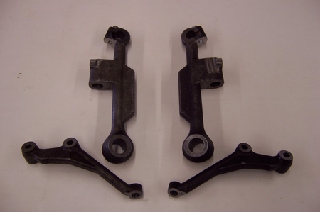

    I've decided to go with a set of the Fat Man Fabrication dropped uprights and steering arms for my 53. Can anyone tell me why there would be $190 difference in price between ordering them from Fat Man vs. ordering them from Hot Rod Hardware ($595.00 vs. $405). Not bashing anyone here...just want to make sure I order the right stuff, am I missing something?? (First picture being Fat Man Fab and second being Hotrod Hardware)
    Also, here are the links:
    http://www.fatmanfabrications.co/products/1949-1954-chevy-dropped-uprights/
    http://www.hotrodhardware.com/index...gory_id=1096/home_id=-1/mode=prod/prd4629.htm
  24. I had a look and I don't think the Hot Rod Hardware price includes the dropped steering arms. If I remember right the steering arms are about $190. I got mine from Gambino Customs.
  25. TRAU 82
    Posts: 24
    TRAU 82
    ...now that I had a look at both of them individually, your prob right. roughly 400-405 for the uprights and 185-190 for the steering arms. thanks for having a look kan't spell. appreciate it man..

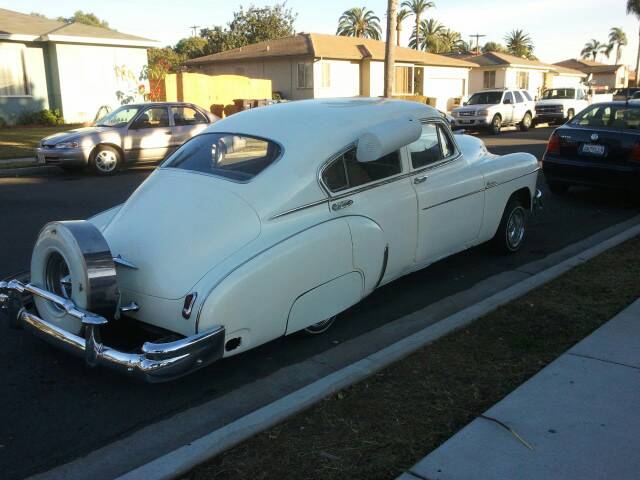

    Hey guys, great info. Here is my 51' delivery, with de arched springs and not sure in the front yet (just bought the car)
    The diff has about an 1.5" of travel before it hits the stock bump stops.
    If I add 2" blocks and trim the bump stop, will I be more likely to scrub the on tunnel first or will the diff be hitting the chassis first?
    Ive had other static cars like Valiants, where the tailshaft will start to smack the tunnel before the diff hits the floor or chassis

    Great stance, did you have to trim the bump stop a bit, or delete it all together ?
  28. speaks
    Joined: Mar 22, 2009
    Posts: 34
    speaks
    1. 4 door kustoms
    Thanks, I trimmed them right back to abou 1/4 inch thickness. The pumpkin taps the trunk floor just before the diff hits the rails but on big bumps they both hit pretty hard. In western australia where i live it is illegal to c notch your cars chassis so unfortonately I just have to put up with the banging.
