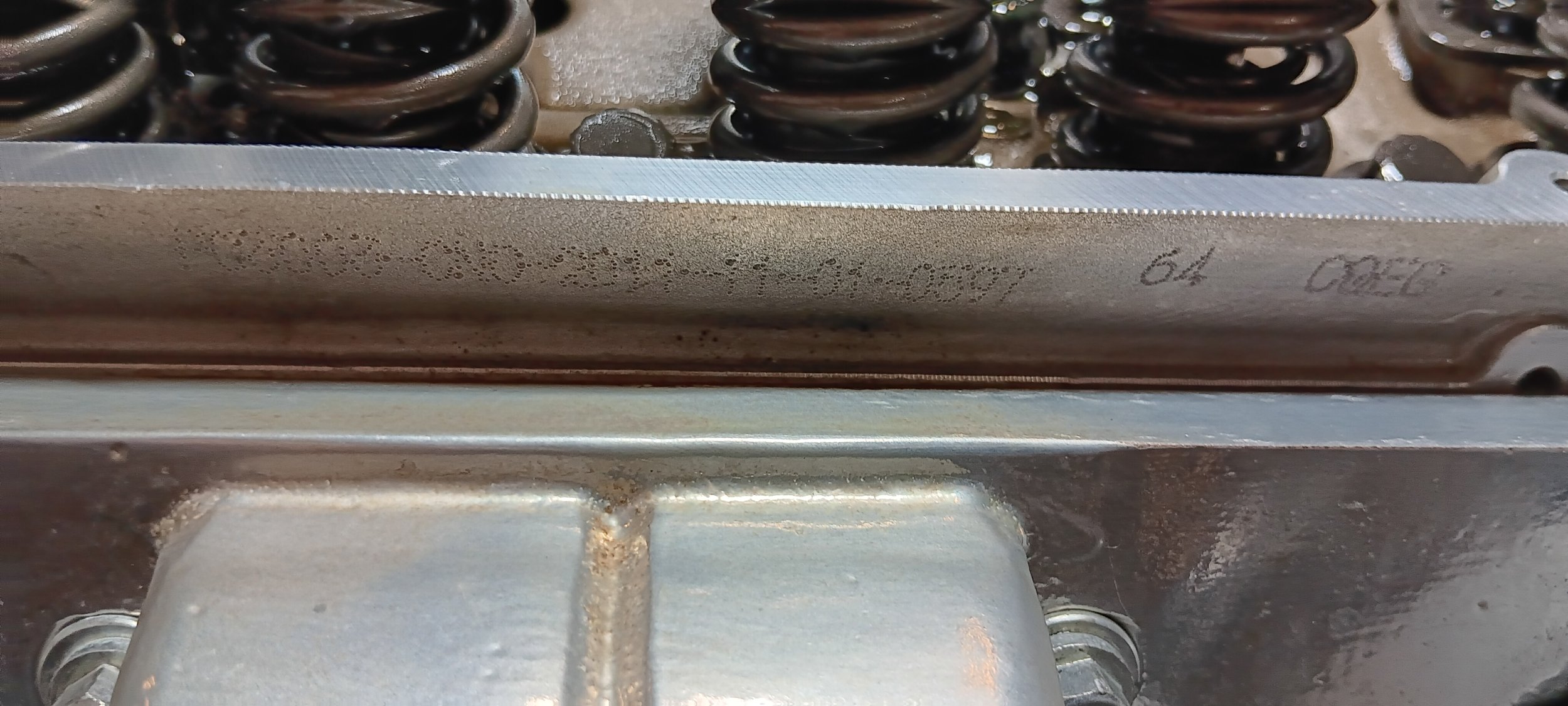

    Chasing a valve train tick on a customer's small block powered 32. While running the engine with the valve covers off it's definitely 20250709_100859.jpg 20250709_100926.jpg 20250709_100931.jpg 20250709_101012.jpg 20250709_101025.jpg number five and seven intake. Check adjustment and they were good But re adjusted to make sure and the noise is still there. Pulled both of the rockers and found this. The valve stem tips are worn pretty bad and so are the rockers. What the heck could Have caused this?

    Yes, the rollers roll just fine by hand but looked like they never did when installed Causing the gouge in the valve stem.

    Unknown head manufacturer they are aluminum. Customer has a build sheet 17520827557636635365911665611314.jpg at home. He's going to look at tonight.

    I went by the machine shop to pick up my fly wheel and asked the guy about the heads. He believes they are comp heads and they have titanium valves and they should have valve caps. He thinks the dissimilar metals is what's causing the problem and says that the rest Are probably starting to go also. It has the proper valve locks that are made for the caps To clear.
