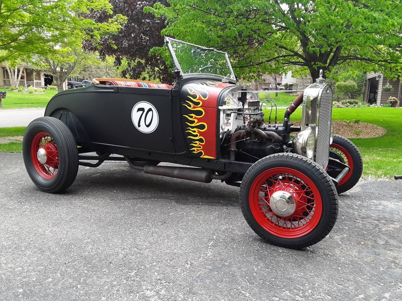

    I used John Deere satin black 4 years ago. Very cheap and touch up with spray can!! 20200519_152102.jpeg
