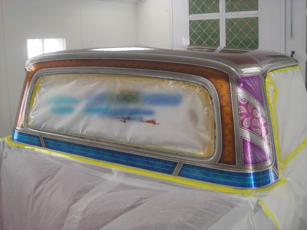

    got some shells done on the back panel. root beer, with pagan gold over
    then moved on to the last piece of the top. oriental blue lace with aqua blue over with a fade up the side panel.
    afew with the clear laid down.

    Keeps getting better and better.

    just wow!
    How you do the bandana patterns if you dont mind me askin?

    it was, unfortunately the shitty part is up next again,color sanding.
    i had a buddy that makes signs, make me a stencil pattern. a real bitch to weed out all the small dots.but i think the end result was worth it!?
    i will post some more detailed pics soon. im going to do a step by step thread and show in detail every step in doing a paint job like this.
