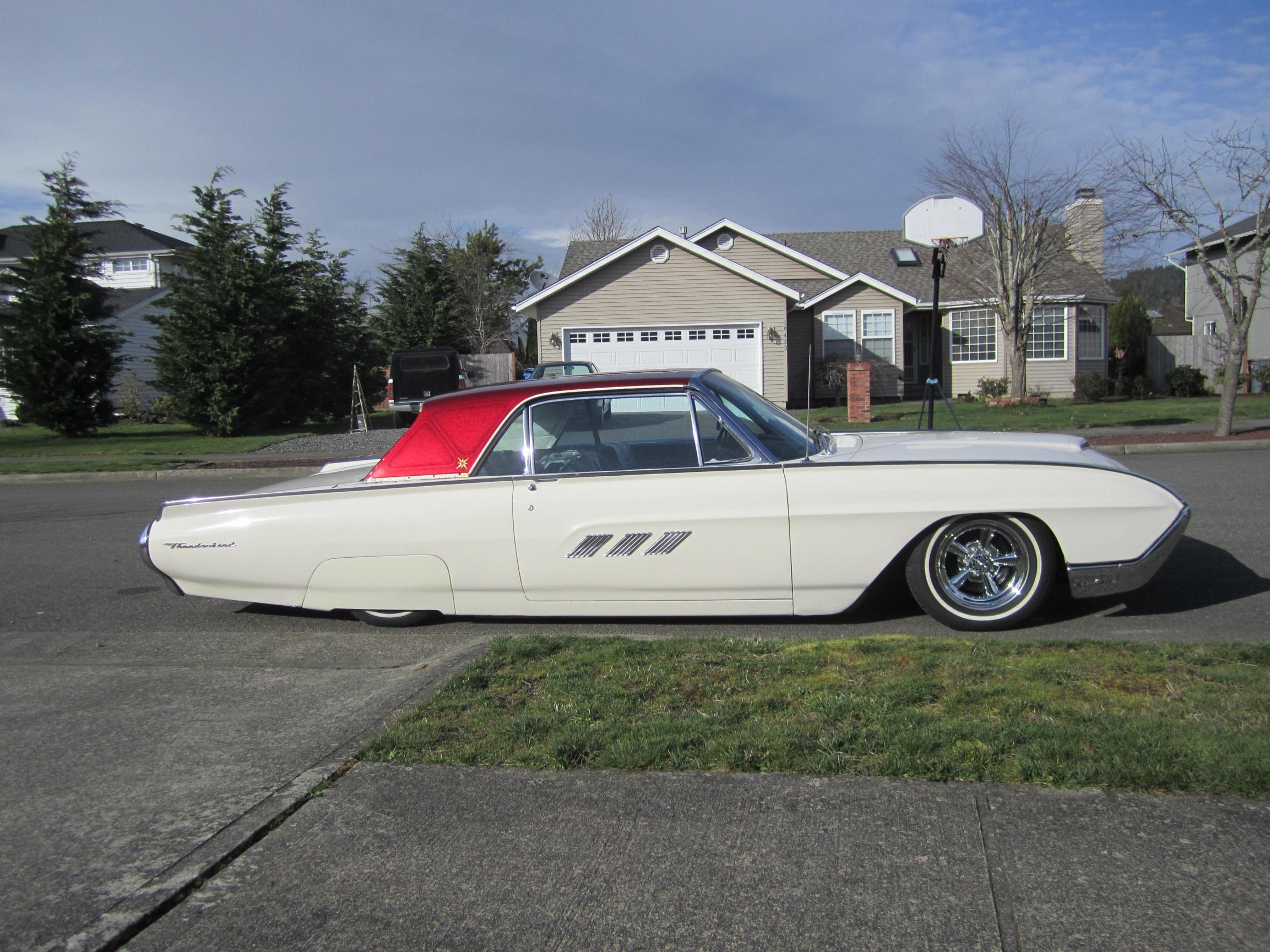

  14. gecko54
    Joined: Oct 28, 2006
    Posts: 249
    gecko54
    from Sumner, WA
    Alan was right, the Gods are Happy and the Sun came out. Here's a couple pics. Alan feel free to add some if yours came out better. I can't put all the trim back on til after we Cut & Buff.

    Here is one of the whole car
