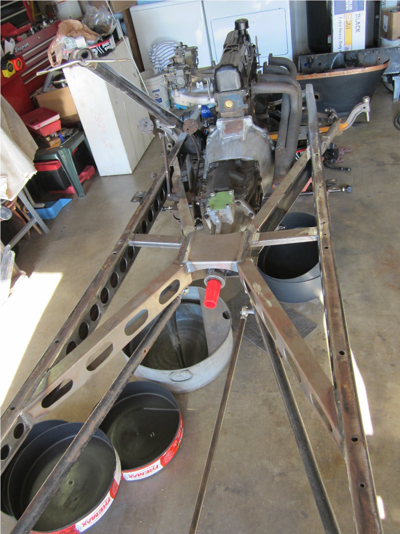

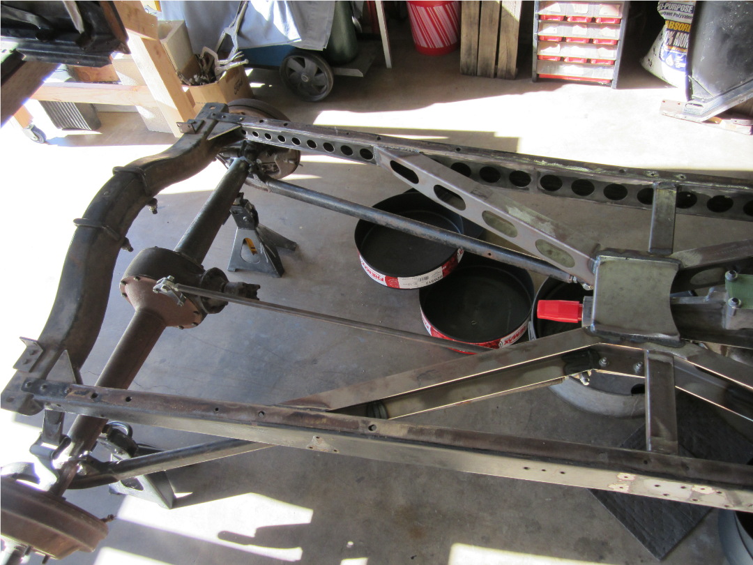

  14. A pic from a build down under that I saved a few years ago to give you another idea
    ottoman and Blues4U like this.
