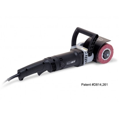

    That is a nice tool to have. Flop gets some amazing finishes with it. That would be great to have if you needed to strip surface rust off of panels.
