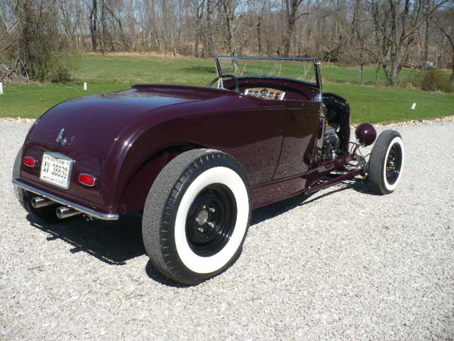

    I have 820-15 on 6" wheels . They measure 29 1/4" Bill P1020701.JPG

    That looks good. That diameter is close to cokers site, can you tell me the tread width please ?

    The tread width measures 5 1/4". Bill

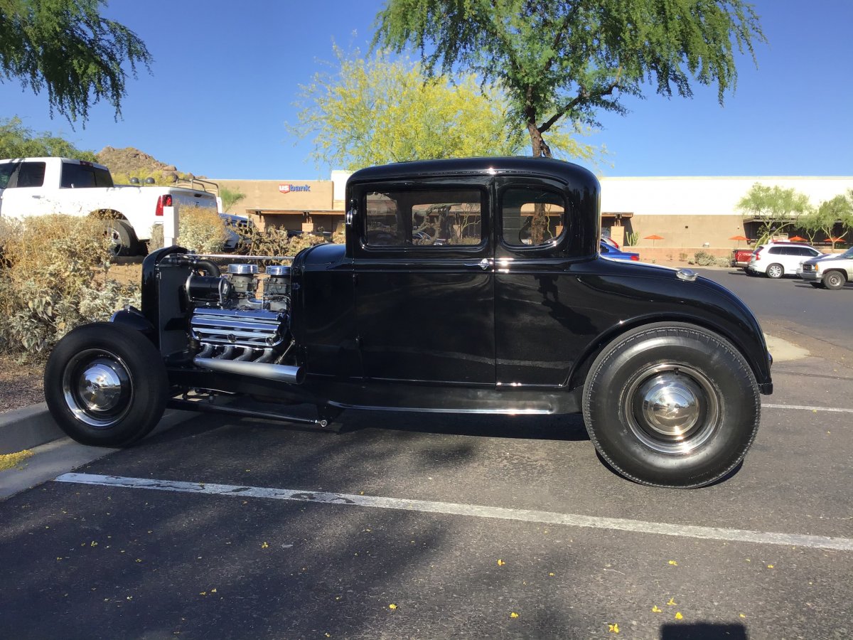

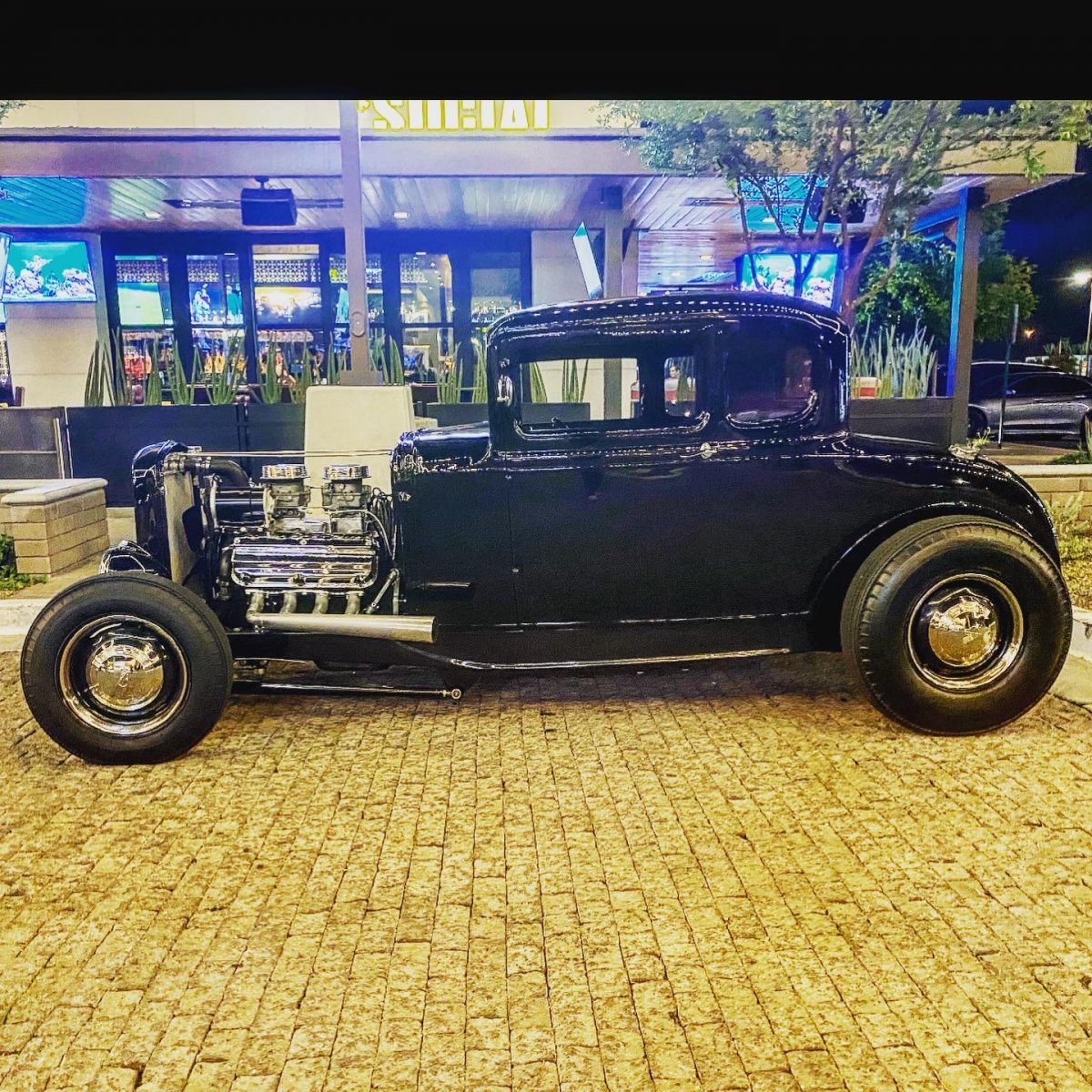

    The new Americans classic tires C9B4960E-9316-47C1-9468-68346B6506CA.jpeg C2817C82-A1CC-4578-B22A-46CD3CC9E1C0.jpeg 597CBBC5-C461-40F7-8781-F5359166AC91.png

    I am considering 16” white walls, maybe Christmas?
    All traditional hot rods 8 see are running 16”, sometimes it looks good but it can make the rear look higher..

    Yes 15's are for the street rodders and 16's for the traditionalists LOL
    I'm running 8.20x15 on my 32-5 window but currently building another with 7.50x16 Wish I could get mine as low in the rear as you have but I already have a big "C" section out of the rails.
    Love your car, any details on the build?

    https://www.jalopyjournal.com/forum/threads/31-ford-build.1131262/ Is the link to my build. Thanks for the compliment, the ride height was a big factor in my build. And there is still things I would have done different. I started with vertical coil overs but that sat the car really high. When I angled them, the car dropped. I still have room to go lower but my rear end isn’t wide enough to allow the body to drop in between the tires. As it is the tires hit the fender and I did rub it down to metal. My painter is going to fix it soon. I had to put rubber bump stops on the frame which prevents hitting. Luckily my ride isn’t sacrificed. When I “modeled” a wider rear end to see the body drop, I didn’t like all the spacing I had to have in between the body and tire to prevent the body from hitting the tire. I also didn’t like how much I would have to stiffen the ride. I bought soft coil over because ride comfort is important to me. My last model a truck I did, I stiffened the ride for the above reason and it was horrible on the street, some people didn’t think so but I like a soft ride. Also a reason I got rid of the bias tires and went radial.
    I working on a 30 roadster which will be Z’d and spring behind axle for a aggressive drop. That I will also use coil overs and 16” tires. I haven’t documented it because of covid, I don’t wanna spend too much money till this calms down. Beside my frame guy is in Los Angeles haha

    That was definitely worth the hassle. Great looking car !! Bill

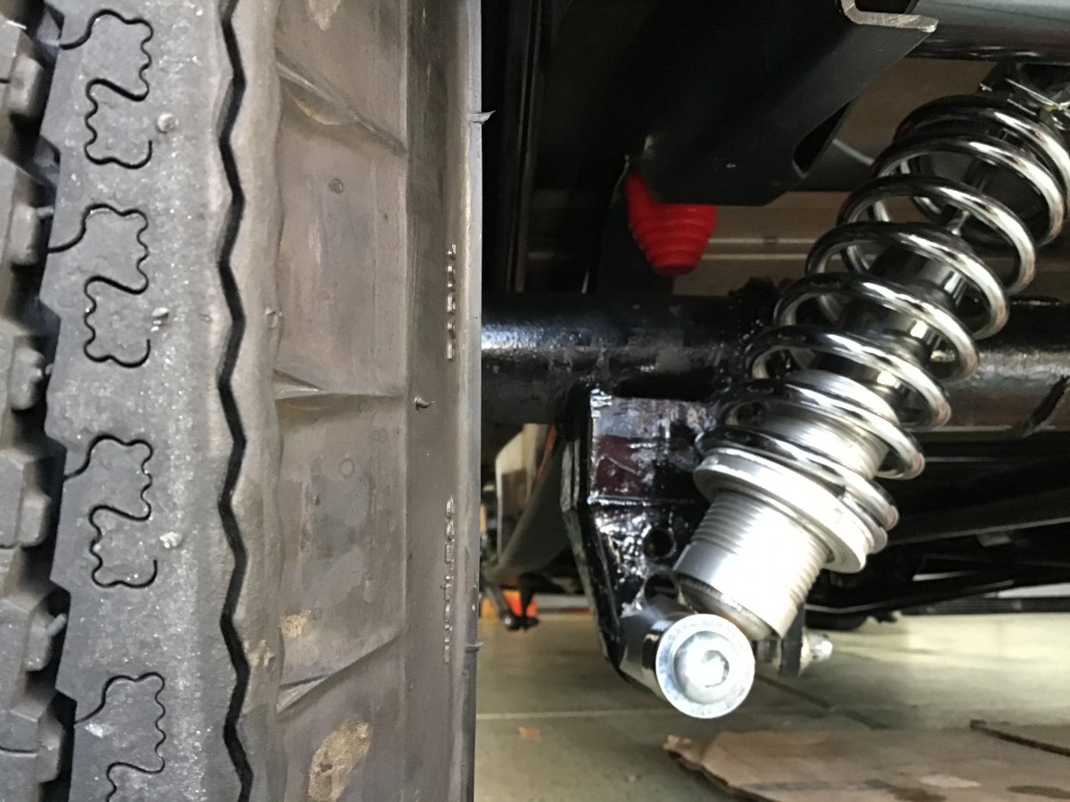

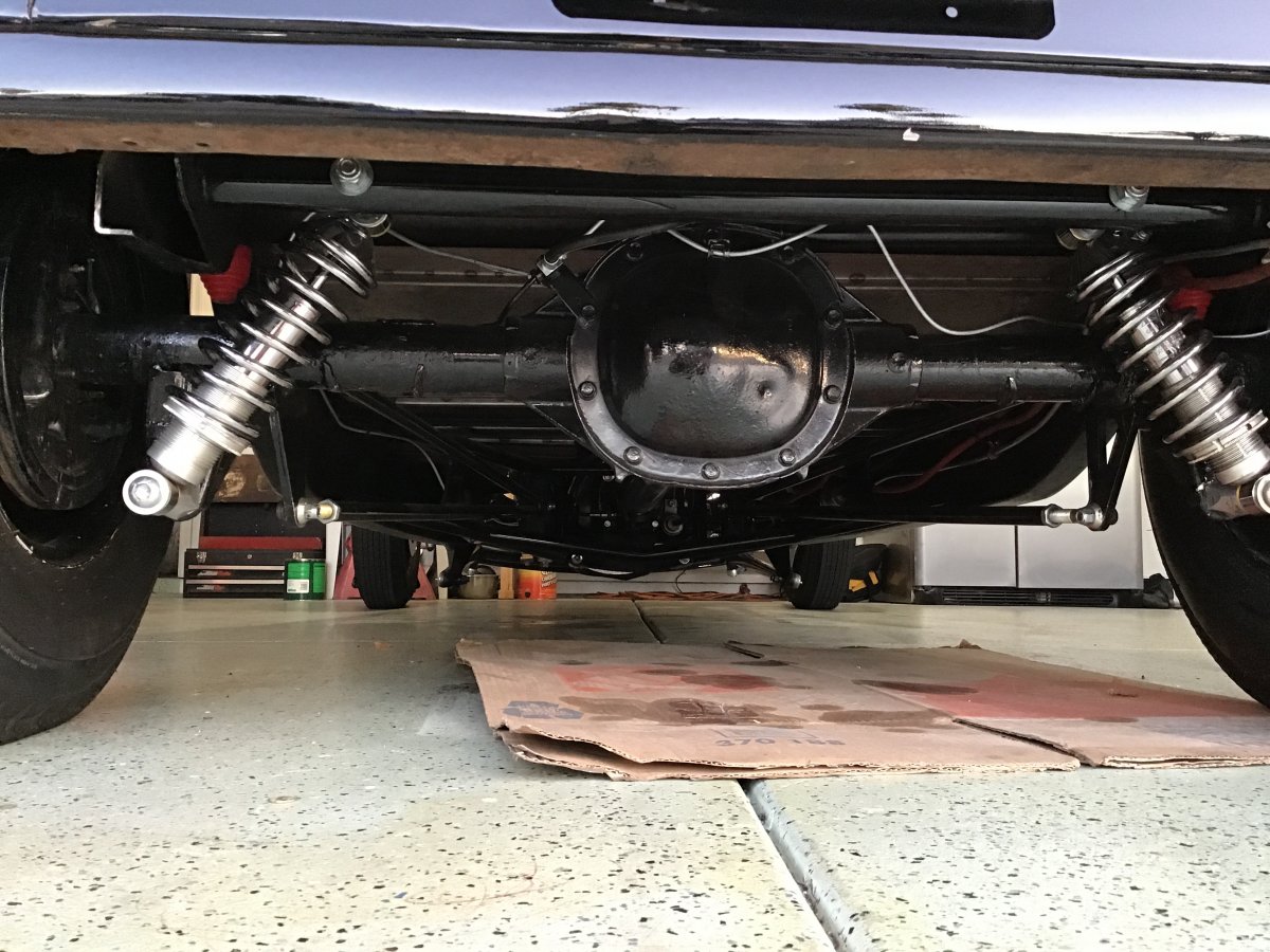

    I’m sure it’s the crossmember/spring that’s keeping the high. I have coil overs with a S10 truck rear end. Coilovers allow the drop. image.jpg image.jpg image.jpg image.jpg image.jpg

    You can see the c notch and the bump stop. And also the coil over bracket to the rear end, allows for more drop

  17. Nice, I would not have guessed that those were radials.

    That's a massive bump stop and you've got heaps of clearance between your axle and chassis. I checked my build out yesterday and with my set-up wheels which are 16" Mainline I will have the same problem as you with burning the paint off in the wheel wells. I do have a set of 16" Kelseys which have been modified to suit later Ford pattern which increased the offset by about an inch so will have to run them.

    You could also run a spacer, I am 5/16” or 8mm;)
