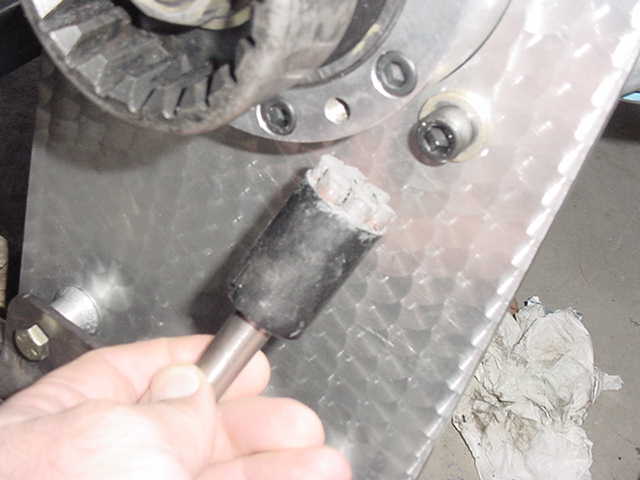

    I've done it poor boy style using sanding rolls, scotchbrite disks, and also a wire brush in a drill motor at low speed. To use the wire brush, wrap the circumference tightly with black tape several laps. Practice first.

    A brass bristled brush (rotary) with heatshrink around it works well in a drill motor also...

    I have done this two different ways. The old school method is to glue a small circle of suede to the end of a wooden dowel. Dab some valve grinding compound on the suede, chuck-up the dowel into your drill press (slow speed)and go. Later, I found a rubberized abrasive called "Cratex" it comes in cylindrical shapes and can be used like the dowel, when the tip wears, you just "dress" it by slicing off a bit off the tip to make it square again.

    I tried the wooden dowel thing - it sucked because of two reasons - first you had to have your dowel perfectly square (to itself) and then you had to have it perfectly square to the part. Instead I had better luck just glueing felt or leather or even a SOS pad to a bolt head chucked into the drill press. One thing I found useful was a straightedge to slide the part across as you did each mark - the spacing is NOT critical to the eye so long as they are on a straight line - IMHO. The "trick" when using the non-abrasive mediums is to wipe a coating of valve grindign compound (rubbing compound - whatever abrasive you prefer) across your part - this time each new mark gets a fresh "charge" of abrasive - if you apply the compound to the end of your "pad" you may notice (immediately or even years later) that the marks tend to fade away in their depth.
    I have also had good results using cratex - my only issue there was that I at times wanted to make a larger swirl diameter than the size of teh cratex stick - so I made a "fixture" - works pretty good all considering.
