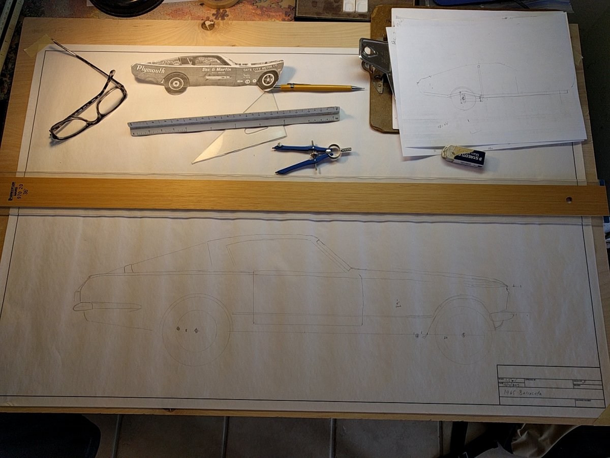

    I got my new CAD software.

  8. porkshop
    Joined: Jan 22, 2004
    Posts: 1,739
    porkshop
    from Clovis Ca
    Nice work drafting that out on paper......

  12. squirrel
    Joined: Sep 23, 2004
    Posts: 56,088
    squirrel
    I've been cheating and using the calculator, but I do have a coupe slapsticks.
    I'm closing in on the frame design. I'm waiting to get the front axle all figured out, first, since that will kind of tell me how far apart the rails want to be.
