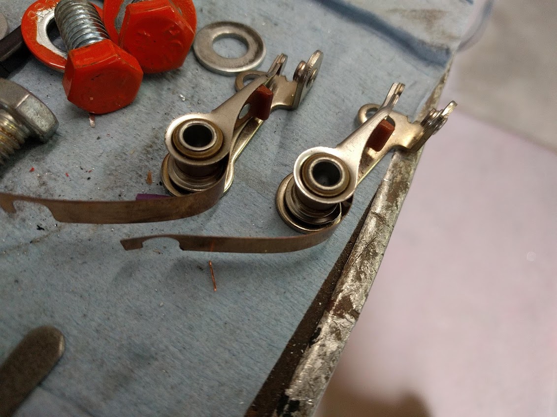

    I fixed the ignition problem. just defective new parts, they installed the contact strap, but not the spring strap. that was fun.,. I found the old points in the garbage can, filed them, put them in, and it runs great.

    How do they miss putting the spring strap into a new set of points?
    Stunning execution, and incredible speed at which you built this car! Best of luck during Drag Week!

    Those look like the exact same points that I changed in my little Massey tractor . Same problem so I filed and put the old ones back. lol I got mine at the NAPA I work at on Sundays. You would not believe how may different applications those fit over the years. And yes they are made over seas. Larry

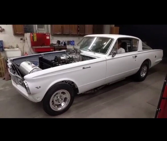

    little video. We're working on the wheelie bars, and the fan shroud, and the hood, right now.
