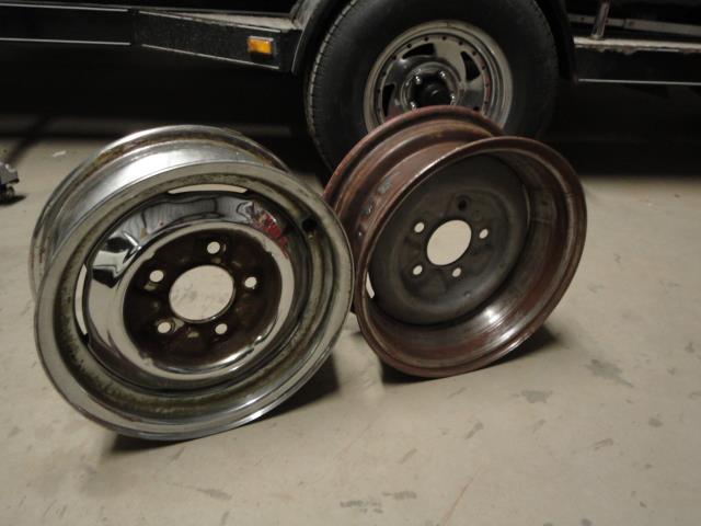

    7J, reversed the rims, partly to get the look and partly to make sure the offset was OK

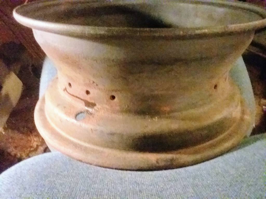

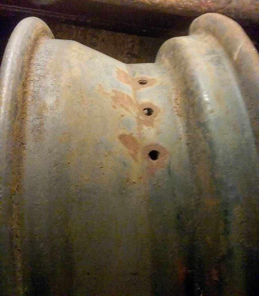

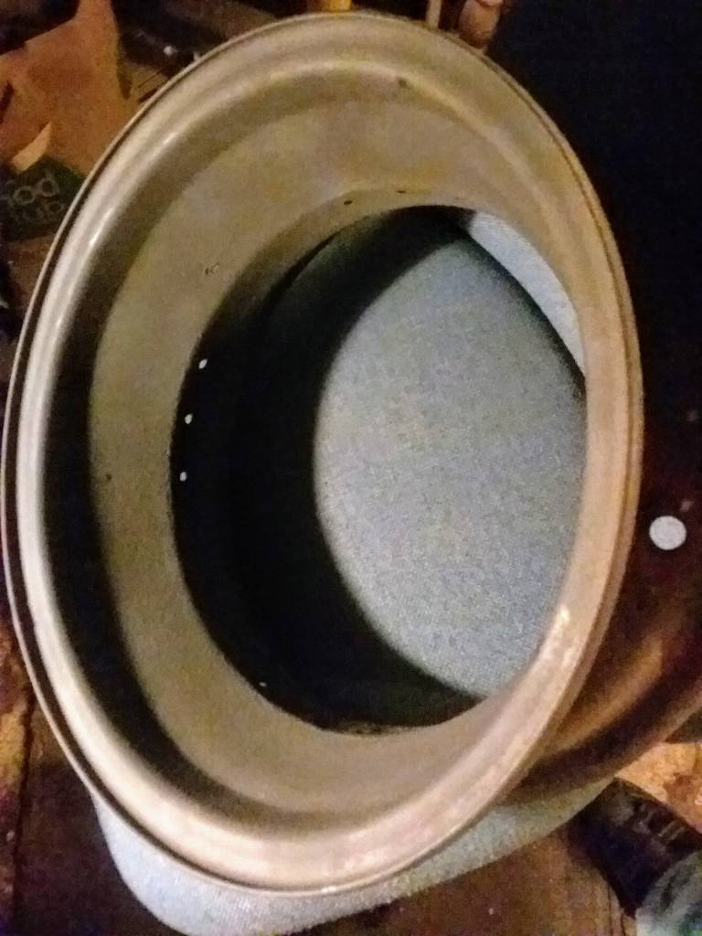

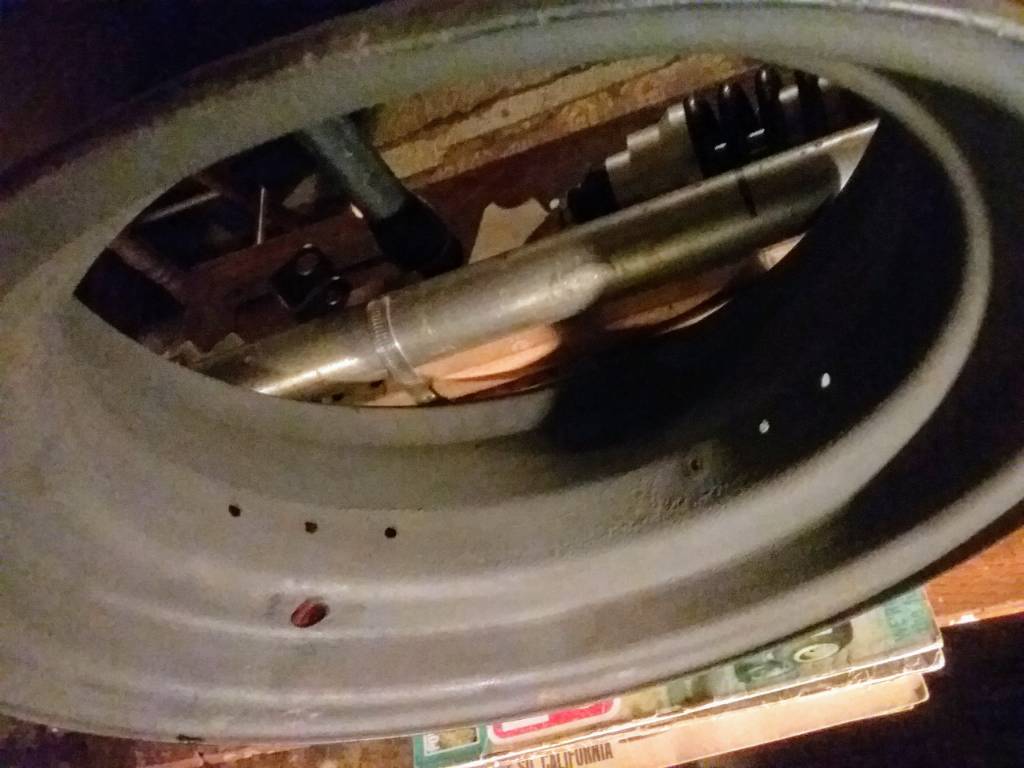

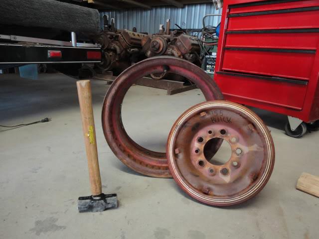

    Found this article in a May 1967 Rod&Custom magazine.
    The last ones I did was for a 51 Chevrolet pu.
    I used 56 Buick station wagon rings with late 50 early 60's 6 lug centers.
    The Buick rings have a nice smooth tapered look , I also left the valve stem in its original location , witch becomes the back side.
    The wagon rims are 7" wide and when reversed its 5" from the center to the outside edge.
    I still have two Buick wagon rings for something someday. 20200505_223618.jpeg 20200505_223659.jpeg 20200505_223405.jpeg 20200505_223502.jpeg 20200505_223021.jpeg 20200505_223311.jpeg 20200505_223421.jpeg

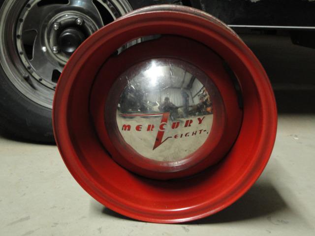

    I always wanted to build a set of 15 x 8 wheels. Using riveted early Chevy centers on 8" hoops with a back space of 5"... Then I would get some 255/60r15 tries from Diamondback and have them remove all the side wall markings.... A tire with a 8" wide tread, on a 8" wide wheel, is suppose to be perfect, according Herb Adams and a few others..
    Those Merc wheels are perfect.. Couldn't you drill a hole for the air valve, I'm too old to be climbing under my car just to put air in a tire..

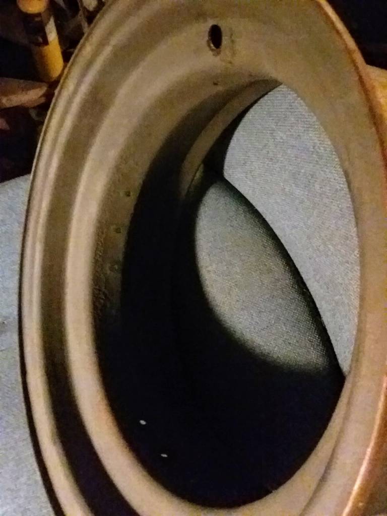

    Anyone know what 16 in rim to look for that will work with Early Ford Centers . I have some 5 in wheels I want to widen . Thanks and be safe

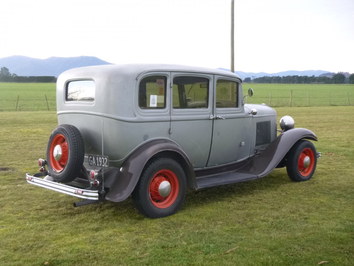

    Some 40 years back, in a moment of "how hard can it be?" I decided to put 15" rims on some 17" '34 wheels. The rims are installed reversed with zero offset.. I think the rims were 55-56 Ford?
    All spokes were cut and bend adjusted, then cut to length with an interference fit to the rim. I tack welded about six spokes, then had a professional welder finished the job. I must have been real keen, I ended up doing four sets, then promised myself "no more"
    Fairlane500 likes this.
