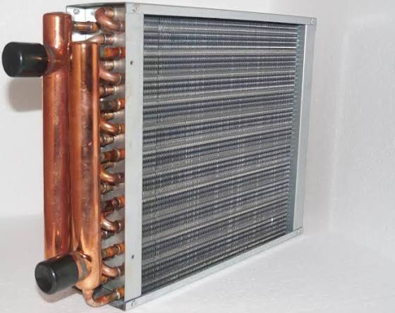

    Has anyone thought about running the air through an automotive AC evaporator submersed in a water tank? Seems like you could get several of those for the cost of large diameter copper tubing.

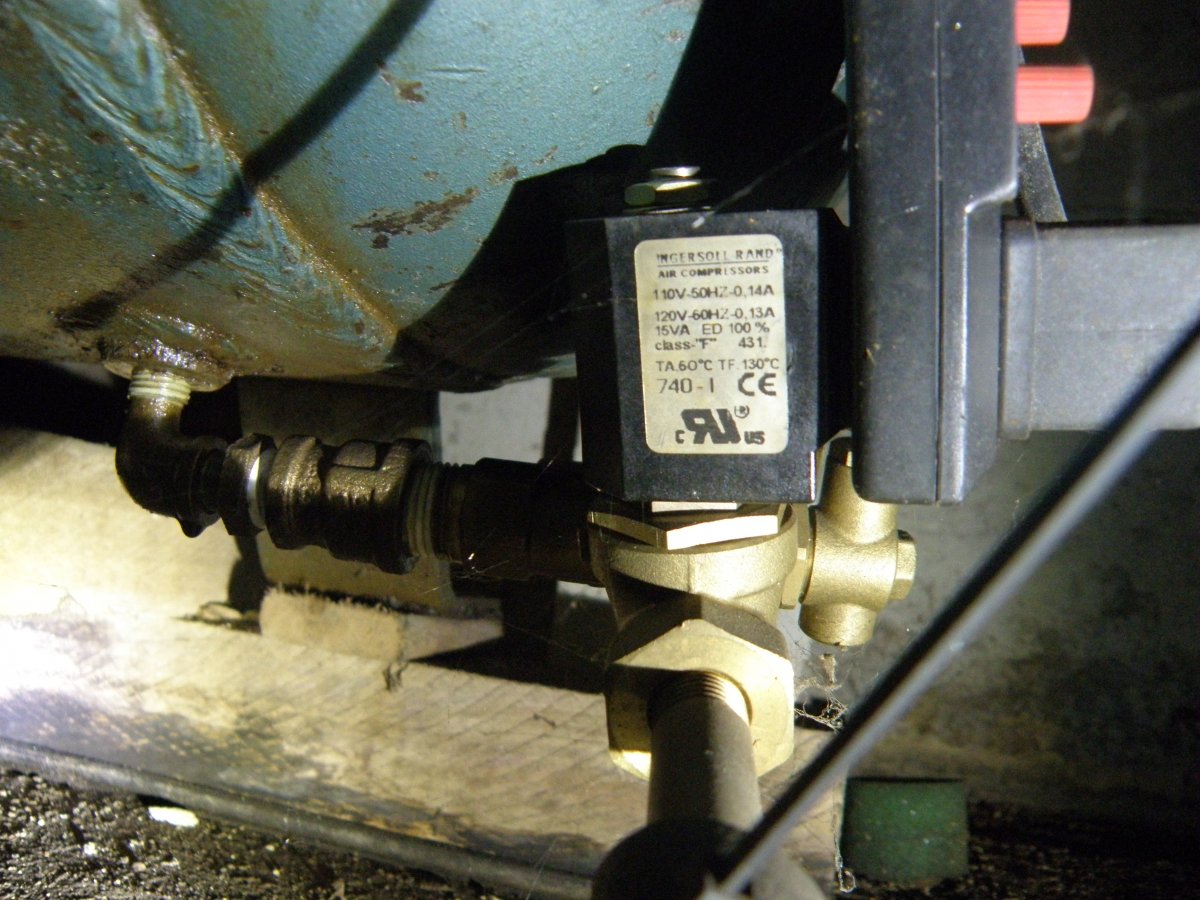

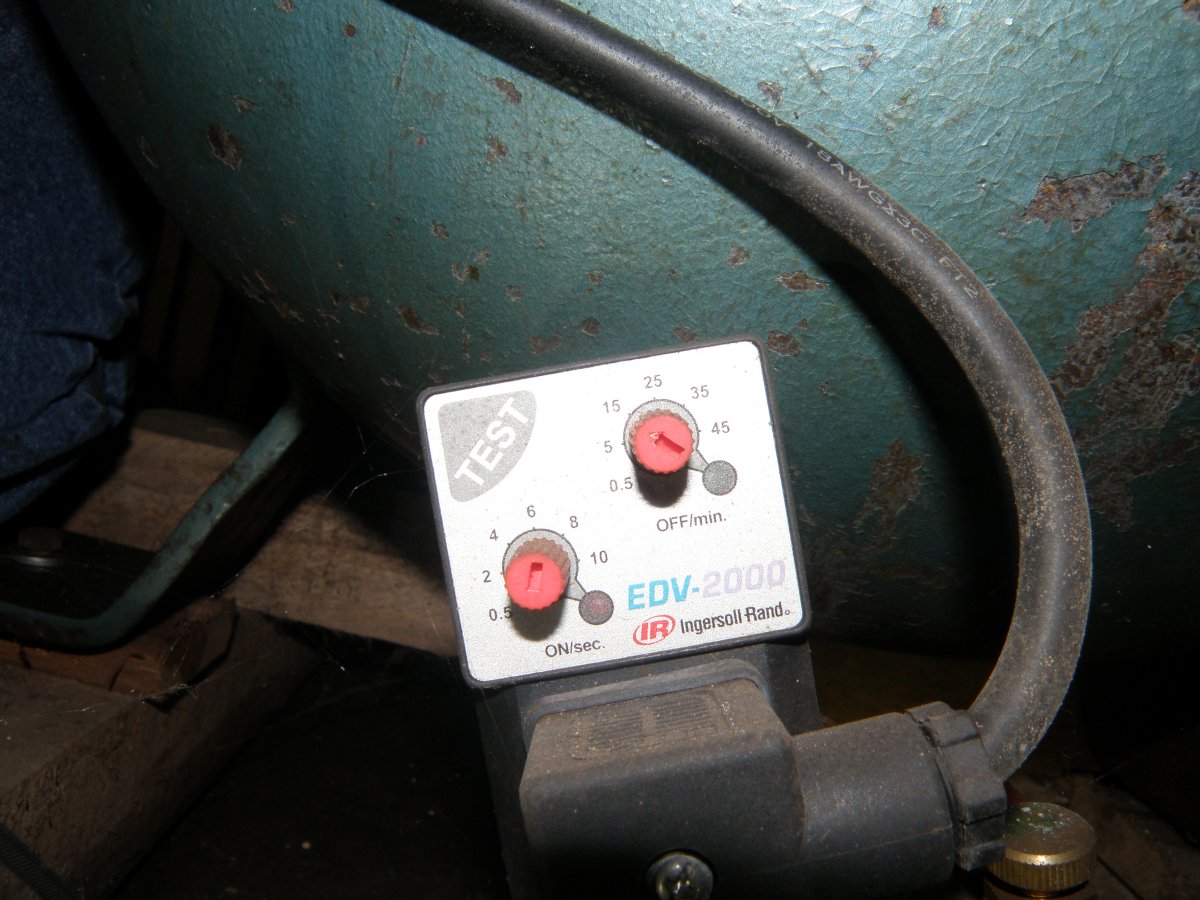

    Here are some pictures of my automatic drain valve. It is electric and drains every time the compressor starts. It makes quite a bit of noise when it drains so I put a crude muffler on it. I recommend this system and hope the pictures help. Gary P1120002.JPG P1120007.JPG P1120008.JPG P1120016.JPG

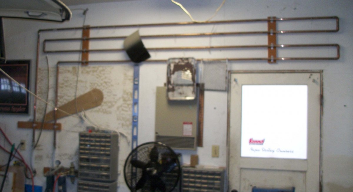

    I am gonna look into one of those ^^^^^^^ Good idier. Heres pics of my contraption. Only had a nut lose leak. Better grade copper.The tubing was warm after testing leaving me to believe that thats my problem. Hopefully the trap helps me out. Air system 002.JPG
  20. I like this idea, A134 runs at way higher system pressure than a normal shop air system. I think you mean using the condensing coil from the front of the system, not the evaporator coil, but if you had parts to pipe 3-4 condensing coils in series, properly oriented to allow drainage, with a box fan on a thermostat, and that fancy drain valve tied to the run circuit on the compressor you could really dry a lot of air for very little money. New copper is way more money than junk car parts, usually.
  21. You can pic one of these up for around $60 bucks. Nice sizes available and 20x20 is perfect to Stick a box fan on it or mount it so the compressor fans hit it. The better the fan connection the better the cooling. Watch the pressure rating because they range from 150
    Psi up to 350 psi.

  23. [​IMG]
    I just now spotted this.
    This is a perfect example of a well planned, well executed home made water trap.
    The air with the cooled water vapor dropping out is flowing downward, then the moisture droplets cannot make the sharp 90° bend as easily as the air can, so the bottle-catcher is the only place the water can go - straight down.
    That TEE CONNECTION makes the
    best design for forcing the water out of the air stream in the sharp bend.
    If you want to copy a system like this, pay close attention to how the TEE and the pathway is arranged.
    This is the best layout for making your own water trap.

    I've got an automatic drain as well, it can be adjusted to drain at various times and durations. It works well and saves having to get under the tank and drain it. Check ebay for kits, they are reasonable and easy to install.

    I made sure the tee was positioned like that so the water would flow down the straight side.I put the blue unit on too as a 2nd catch thingy. The 1/2" after the large steel tubes runs back towards it from the compressor at an angle .Doesnt look like it in the picture but there is a slope

    I meant evaporator but the condenser could work as well. A racer friend of mine used 3 GM evaporators plumbed in parallel as the radiator on an oval track car. I have them now and could make more.
    I did a water to water cooler for an engine dyno several years ago. Just put a radiator in a tank of water. When the engine got hot enough cold water was added to the tank. The tank had a drain line and when the water level got that high it would just spill out into the floor drain. This kept the engine temp much more stable than trying to use a conventional radiator and blowing air across it. Also, that kept the air temp in the cell in check. Burn air was ducted from outside the cell.
