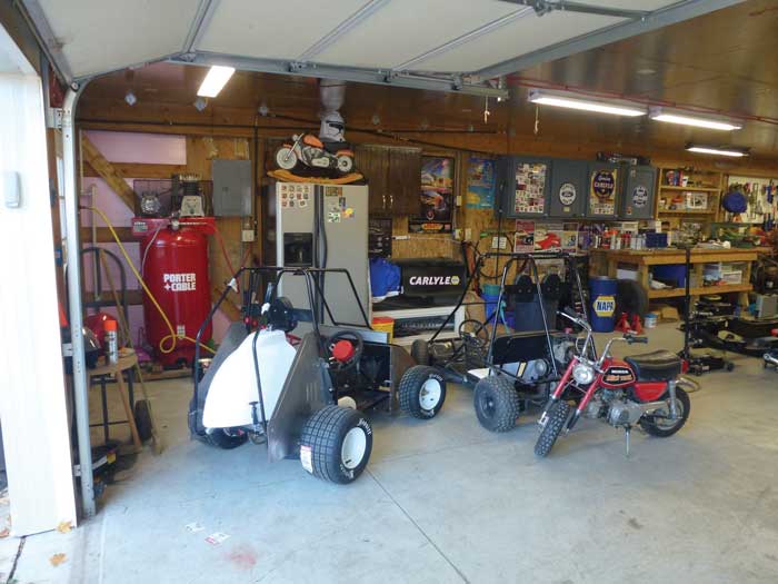

  8. What I do in my garage/shop is to take a long length of copper tubing, either the rigid plumbing, or the tubing unrolled from a coil, then starting at the top of the garage wall, zig zag it downward to the bottom of the wall.
    That makes a very efficient cooler/condenser/dryer for the hot, moisture laden air coming out of the compressor pump.
    I run the compressor pump directly to the top of the copper line. As the air follows the pipe downward, the air cools a bit and lets the water vapor "drop out" as a liquid. At the bottom end of the cooling lines I fastened to the wall, I connect a larger diam water pipe, only slightly slanted, continuing the downward slope as a pathway for the air & the water that has dropped out during the cooling process in the long copper pipe.
    That foot or two of larger pipe lets the air flow along slowly for a bit without reducing flow or pressure. That is where I put in my extra drain valve to periodically drain off the condensed water.
    Then the cooled dry air goes to my tank, where the usual drain valve is located.
    When your air tank feeds the normal hoses in the normal manner, you will have the driest cleanest air you can get.
    When I drain my tank, there is almost always no water. When I drain my "cooling pipe" I get a lot.
    Another advantage is that the oil vapor from a worn compressor never seems to get to the air tank anymore. No more occasional fish-eye in paint jobs!
    Dry air.
    Air tools such as die grinders, which used to spit water after a couple hours of heavy use, do not dribble water any more.
    Oh my, I didn't realize how ugly my rig has gotten with the dust, the cobwebs, and extra extension cords draped over the cabinets.
    sorry for the ugly mess.
    It was all hidden behind cabinets about 3 inches from the wall for many years :)
    I added a few extra home made water traps at every low spot to collect at every low spot in the system. Some homemade traps near the beginning collect quite a bit.
    The homemade traps farther down the line collect almost nothing, since the air has been dried so well during the first few feet of cooling line.
    I also plug in a couple high pressure propane tanks in the line to give myself a huge capacity for painting and air tools without needing a huge compressor.
    I have painted many cars since the 1970's with this rig. (no commercial use)
    Before anyone jumps in and declares that I will explode and blow flames because of re-used propane tanks that have been hydro-tested past 1,000 lbs - I fill a tank completely full of water, rinse, fill again, then when the water is poured out, the only thing entering the bottle is clear clean atmosphere air. over 38 years in service. I may take the two heavy heavy thickwall bottles to have them hydro tested again soon.

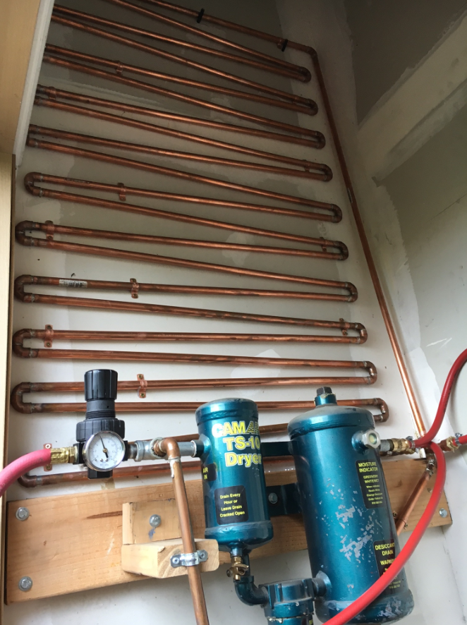

  25. I had the same problem when I first moved into my garage. With a line directly from tank, my water/oil traps would fill quickly and bypass. I did basically the same as mention above only I used black pipe because I had some available to use.
    If you can see past the clutter... rubber line from tank to a black steel pipe, runs to ceiling and then about 15 ft. downhill to the blue cabinet, drop pipe to floor with a ball valve for draining, the T joint is higher up on the drop pipe so condensed water stays at bottom of the drop pipe. A run of another pipe back 25 ft downhill to another drop pipe with ball valve. An above T then runs through my traps.
    Works well... I can sandblast all day and only need to drain once or twice depending on humidity... most times the final water/oil traps do not have much. Drain at end of work so water doesn't sit in steel pipping.
