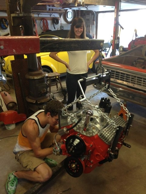

    We got the engine in today. I got some pretty good help from my son Jesse and his girl Hannah.
