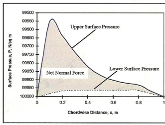

    I'm sorry but Bernouilli is right! What Bernouilli's law says is that, in a fluid flow, the sum of potential, kinetic and pressure energy is constant. Since our air particle will see a minimal difference in height when it approaches the wing, potential energy is constant, meaning that kinetic energy, speed, will be converted in pressure.
    What causes a flat plate, or your hand, to create lift is the fact that you give it a positive angle of attack, therefore reducing speed of air under the surface and increasing the speed of air over it. This has the effect of reducing the pressure on top of the surface and increasing it under it, creating lift, all in accordance with Bernouilli! Of course, increasing the angle of attack will increase the lift, but only to the stall point! At this point, you can add angle as much as you want, the plane is going down!
    Just look at the picture I added. It is the typical pressure distribution on an aircraft wing (the vertical scale decreases as you get higher in the graph). You will notice that the pressure on top is smaller and it's effect is greater than the pressure on the bottom. the grey zone represents the net normal force, the difference between pressure on the two sides.
    Lots of wing profiles create lift at 0 degree of angle of attack by the way. I have NACA data that shows that some profiles still create lift even with a negative angle of attack! that means that I could choose a profile and set it upside down with a positive angle of attack and it would still go down, all because of the curvature.

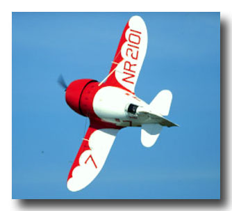

    These guys (The Granvilles, out of Springfield, MA) knew a little about aero shapes back in the early thirties. As you can see, the teardrop shape was prevalent in their designs. I believe this one was good for over 325+ in the air. Looked cool as hell too.

    Ah, the GeeBee model Z. The R1/R2 were faster (and deadlier). Teardrop shape to the extreme.
