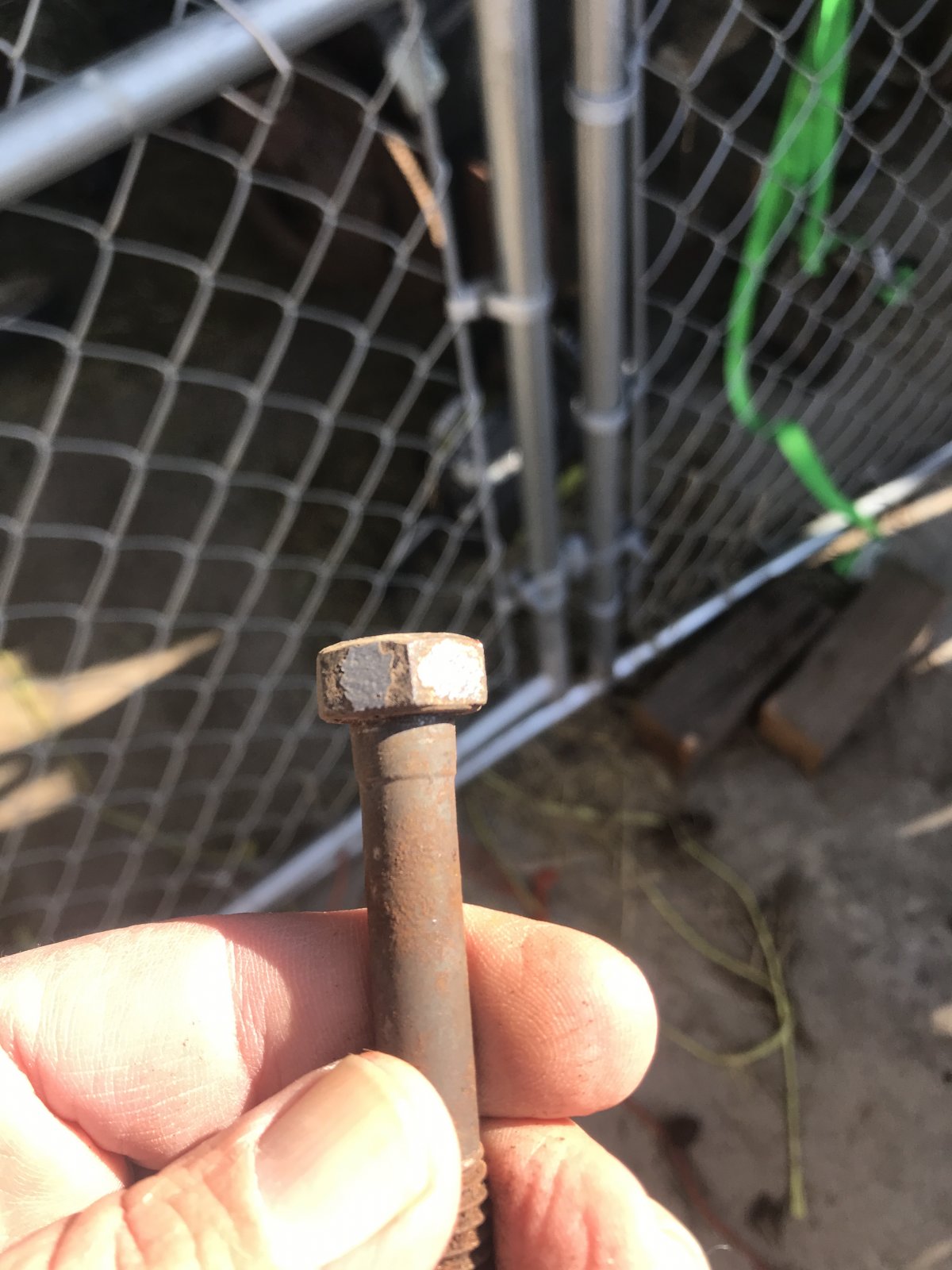

    They were pretty corroded along the shanks and the bolt heads were not a very true octagon any more. I bought same size standard black oxide grade eights...not designated headbolts, so I doubt they're torque to yield.

    image.jpg Compare the bolts you bought to the head bolts you want to change. Above is a 218 head bolt. Notice the extra “meat” below the hex.

    pictures of the old head bolts?

    Ah ha. I see what you mean. Well, should I just re-use my old ones? 20211123_131003.jpg
