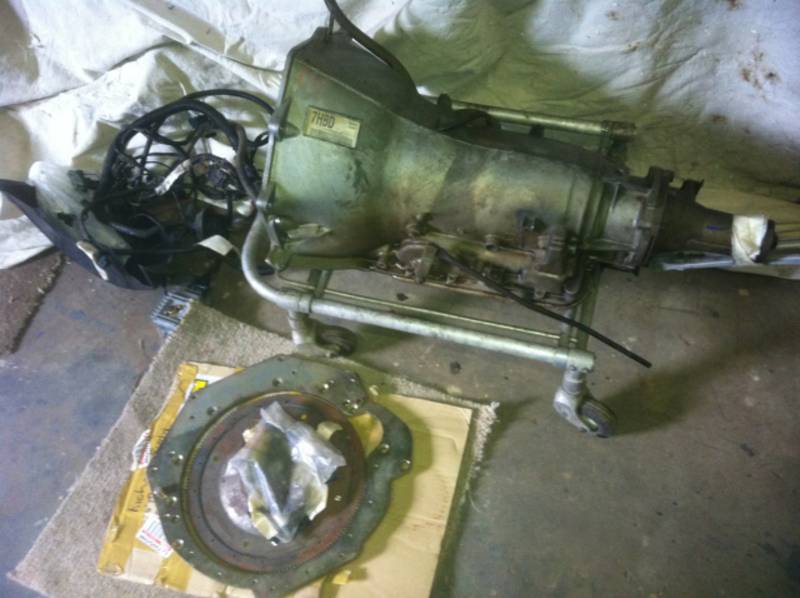

    The Rover V8, as they are down here, were very popular swaps in the UK. Pops or Anglia loved them due to compact size. I suspect UK members would be better informed that me. There is UK hot rod site that may assist. Rovers had 3sp autos behind them which I believe were Borg Warner 66s?
    A friend recently sold his warmed up Rover with an Australian Dellow brand kit to allow a GM automatic transmission.
    http://www.p6club.com/content/borg-warner-automatic-gearbox
    http://www.britishv8.org/British-V8-Current-Issue.htm
    Here is the kit with a 700R, too much auto IMHO, a 200R would be better as smaller with less reciprocating mass. Later 3.5lt Rover V8s (3 speed) used a GM 180 auto
