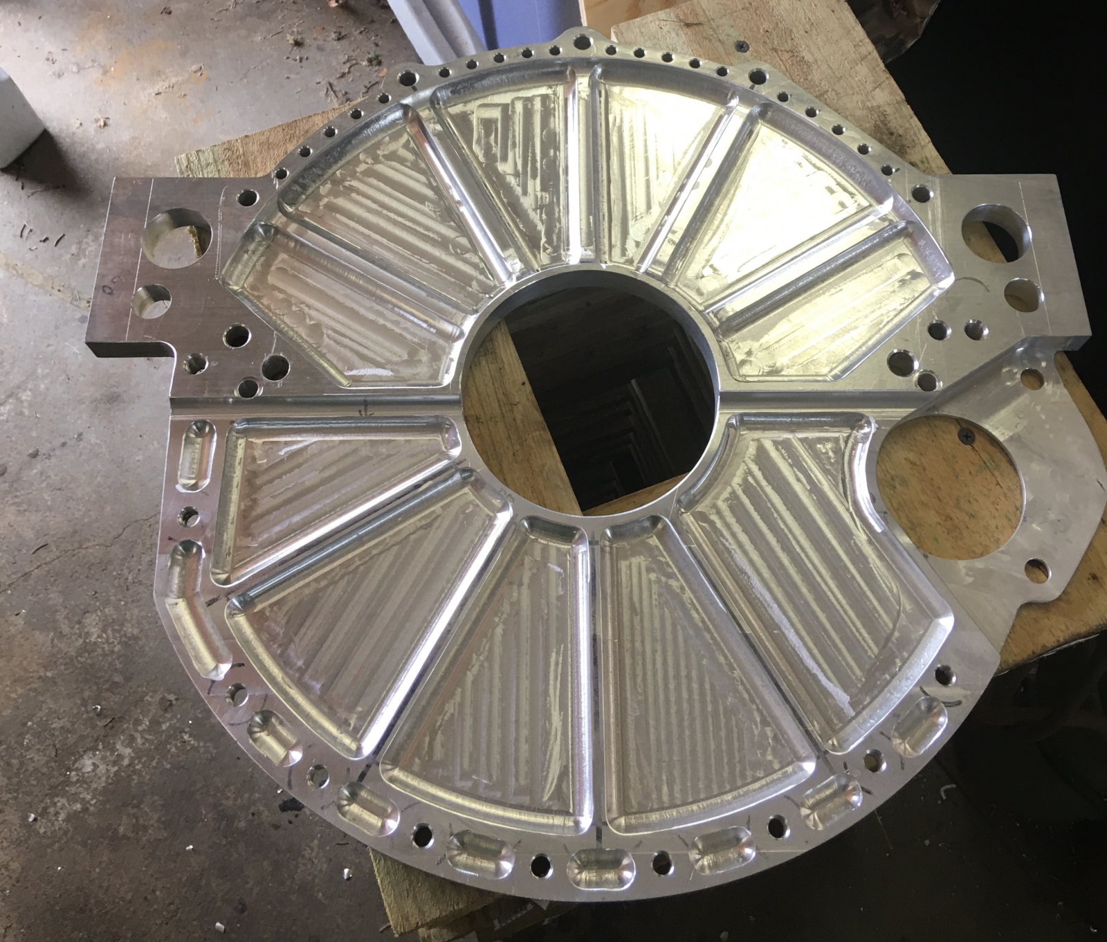

    8347DE8D-6105-4B21-AB38-1B54EC360332.jpeg I never updated this. Here is a “mostly” finished adapter for early hemi to lakewood scattershield meant for small block mopar.

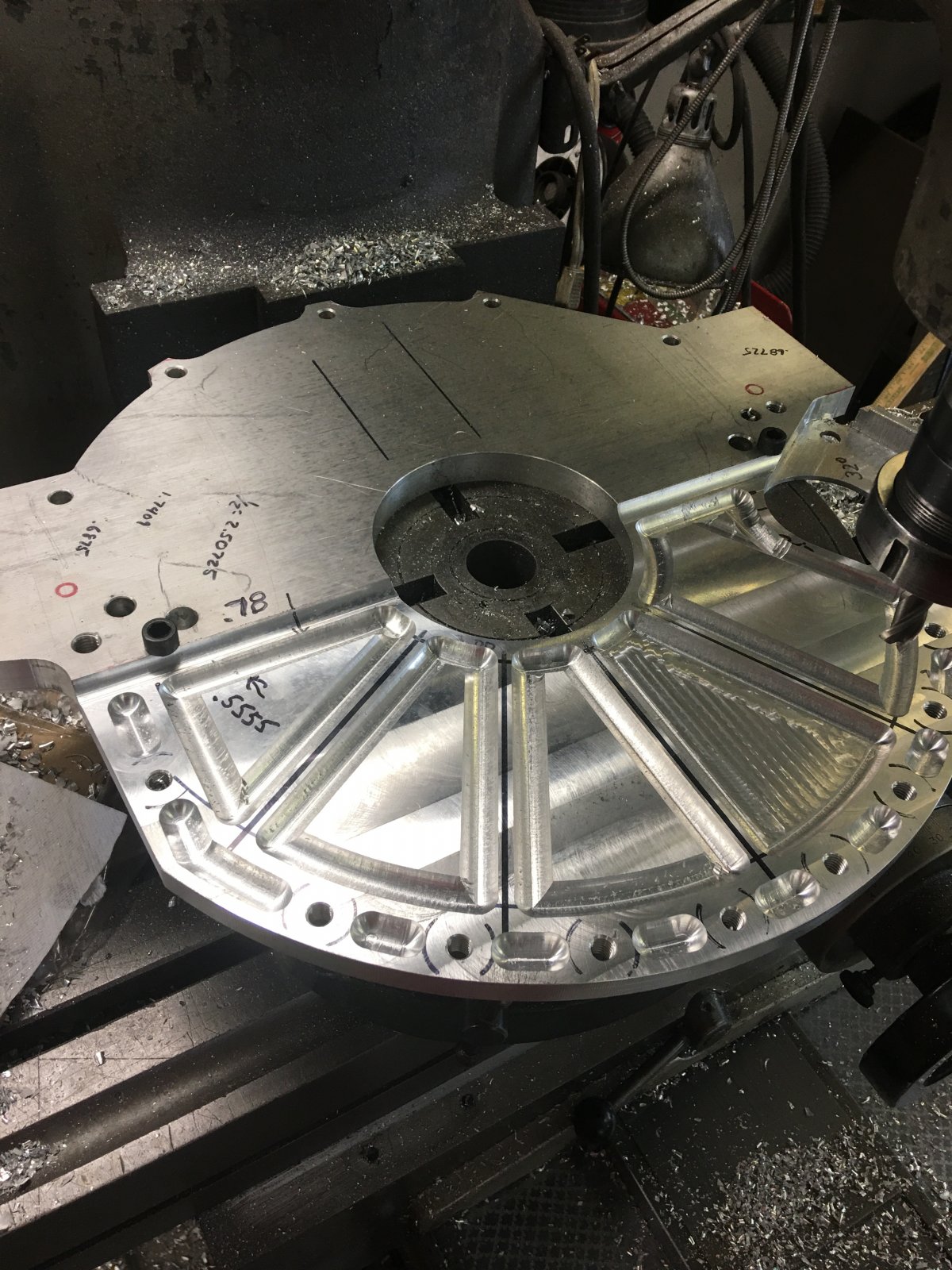

    Done on a manual bridgport with a rotary table. Included side engine mount area. 90373037-5374-4E60-BB31-776701C6E091.jpeg

    I’ve put quite a few Lakewood and now Quick-Time housings on. The first thing I do is check with stock dowels. If off over .005” I take them out, set it where I want at .000” to .001” and drill my own. Usually 1/8” due available space. Anything can be done. The most important this doing correct, check 2 time before cutting as my dad said..

    Agreed. That’s my “almost finished” comment.
    The block to adapter is done and fitted, but the dowels for the scattersheild wont be drilled until I zero the location.

    Awesome work and please share more pictures. What size is your rotary table thanks

    The rotary table was from a high school equipment auction. At least it didn’t go to scrap. $140.00 with minimal use.
    14” diameter. Very heavy!
