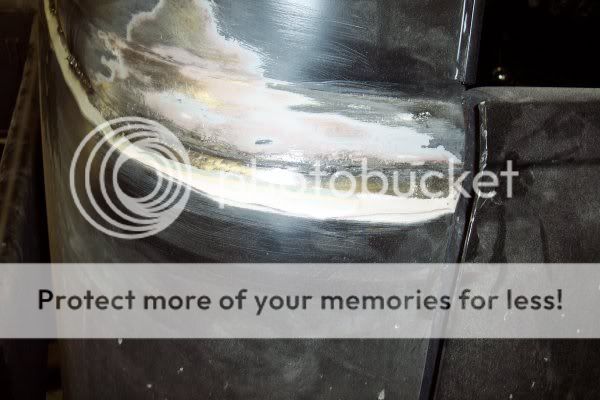

    Tony you have no idea how long i have been searching for pics of this. Thanks for posting them in one of your build thread. It looks like you ran short continuous beads which surprised me. Did you have any warping problems. Any more tips?
    Here are the pics, for anyone else interested!

    Purdue, i didn't run a a solid weld along the back, there's probably 500 tack welds along the seem. I just made sure they were tight and i had good penetration when i did it.
    And once i dressed the welds it looked like it was a solid bead.
    There was no warping. I jumped around quite a bit and took my time when i tacked it together. I also made sure that when i ground it down that it didn't get too hot either. That'll warp the hell out of it too.
    Glad you found the pics. I hadn't checked back to see you asked before..sorry about that.
