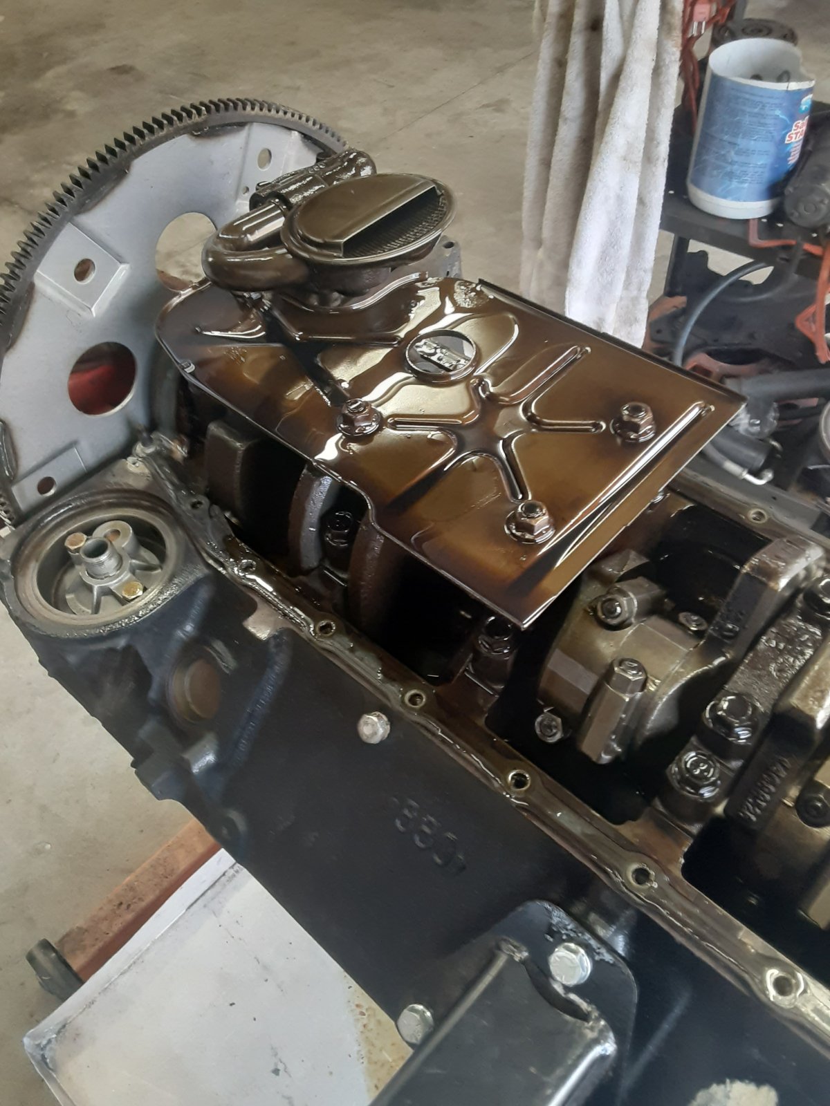

    20220708_164423.jpg I need to torque some SBC four bolt main bearing cap bolts and can't get a straight shot on them. I'll need to use my 1/2" drive torque wrench with a 1/2" to 3/8" adapter, a 3" extension, and a 5/8" crowsfoot.
    Torque specs are 67" lbs & 77" lbs.
    What do the math experts say I should be reading on the wrench? o_O

    20220708_170311.jpg 20220203_112739.jpg The block I'm using for the 39 Poncho came with a splash tray held by three of the bearing cap bolts that have and extra couple inches of shaft added.. hence the issue. I plan on using the splash tray... cuz..it must be there for a reason...
    First pic is current situation.
    Second pic is how I found it.

    Remove the windage tray and use a deep socket and reinstall the windage tray. If I remember correctly I had to cut a socket and tig weld a piece of tubing in between to make it deep enough

    Problem solved! All my "good" sockets won't drop all the way down over the stud. My junk drawer yielded an old 5/8 socket that drops all the way on, but the stud sticks up onto the drive 3/8 hole. But I also found a scrap 1/2 drive socket which I can weld to the back end which gives me length and drive needed.
    Screw the math! Thanx guys.
