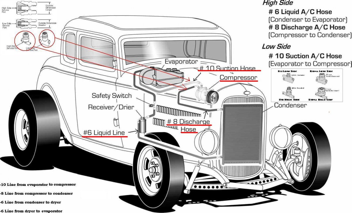

    Being a suction hose, have you thought about using hard line in this area with o-ring ends, aluminum or SS? Not sure how you run the lines through the firewall however either can be bent and fit into tighter areas than larger OD flexible hose. AC LINES1.jpg

    Check Vintage Air. That have new smaller hose and crimping is done with pliers. Hose is much more pliable and crimp bands look very clean.
