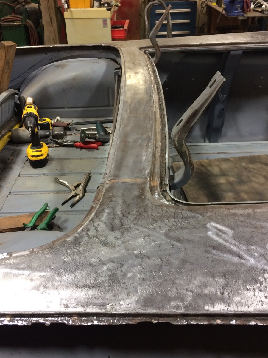

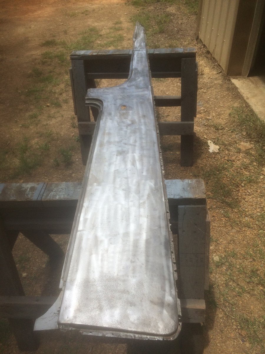

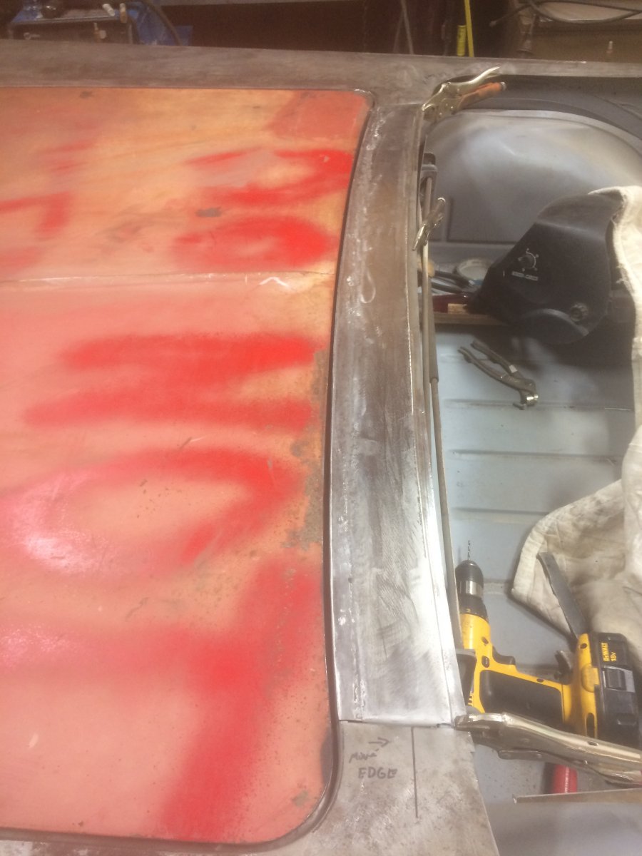

  4. If you ever wondered what a 59 fin looks like off the car, here ya go

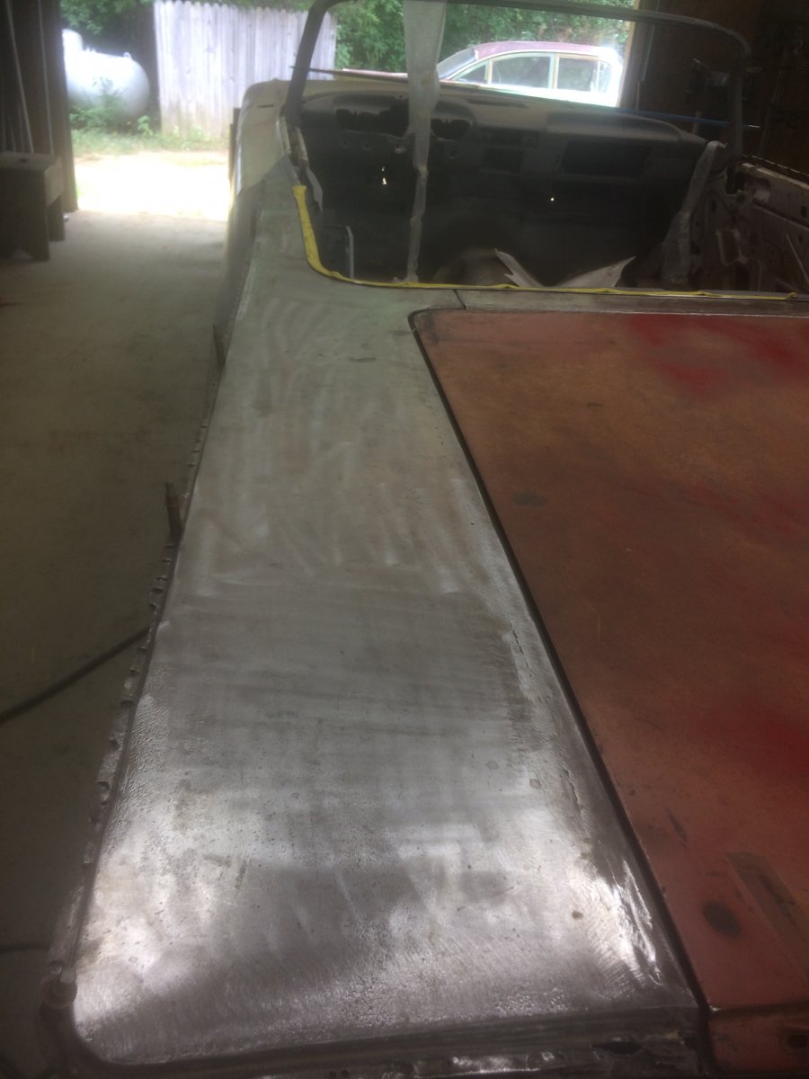

  5. Tops of fins ready to weld
    Top boot trim fits
    Gettin closer

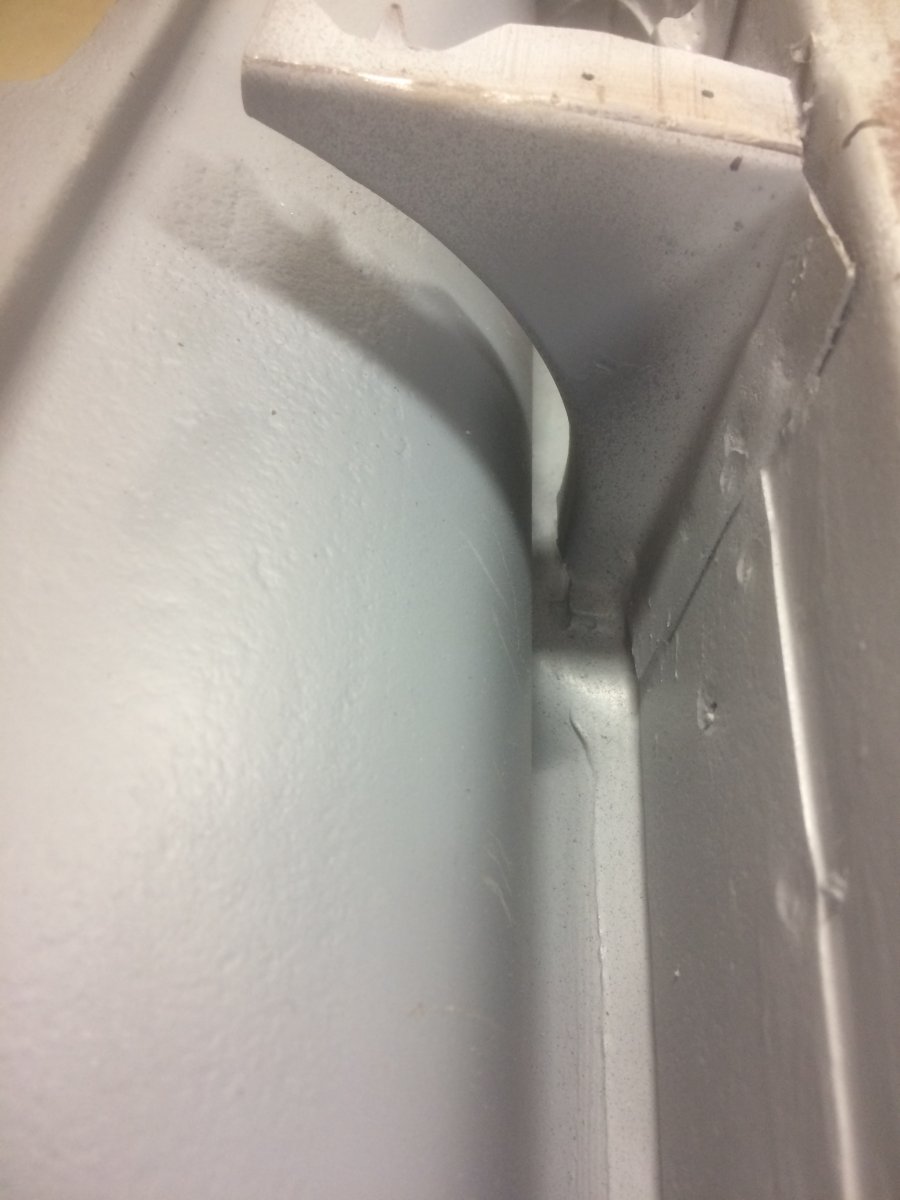

  6. Details
    This little baffle is unseen
    It will hold some foam to seal the fin area
    Just because no one will see it doesn’t mean it shouldn’t be replaced
    The original one on the left
    The newly fabed one on the right

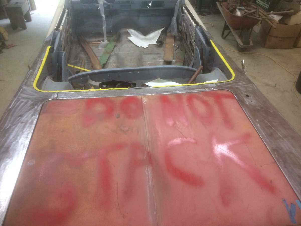

  7. Rebuilt and epoxied fin tops ready to go back on for the last time
  8. Getting closer

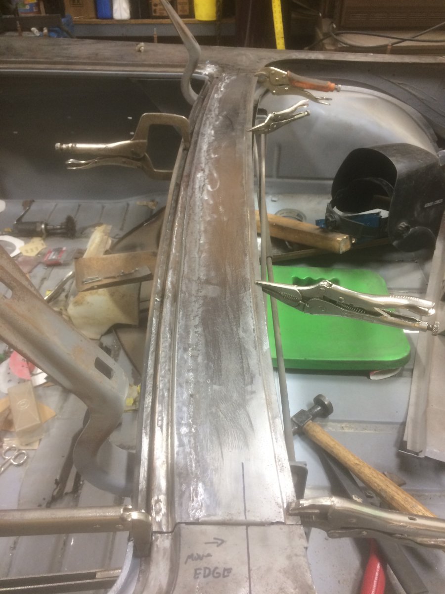

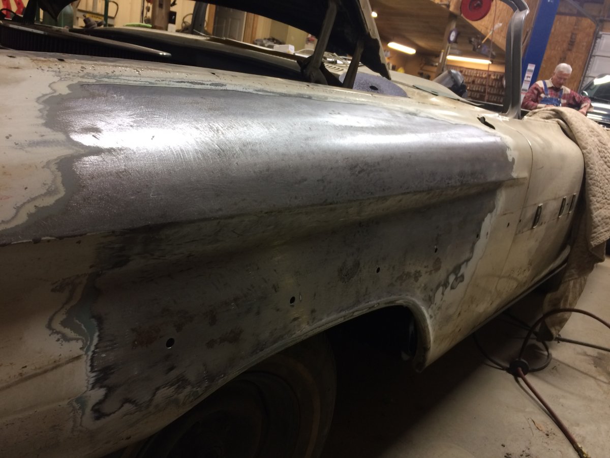

  10. Unbelievable amount of shrinking was done on this. I think I have worn out a shrinking disc
    It needs a little more fine tuning and it will be ready to epoxy.

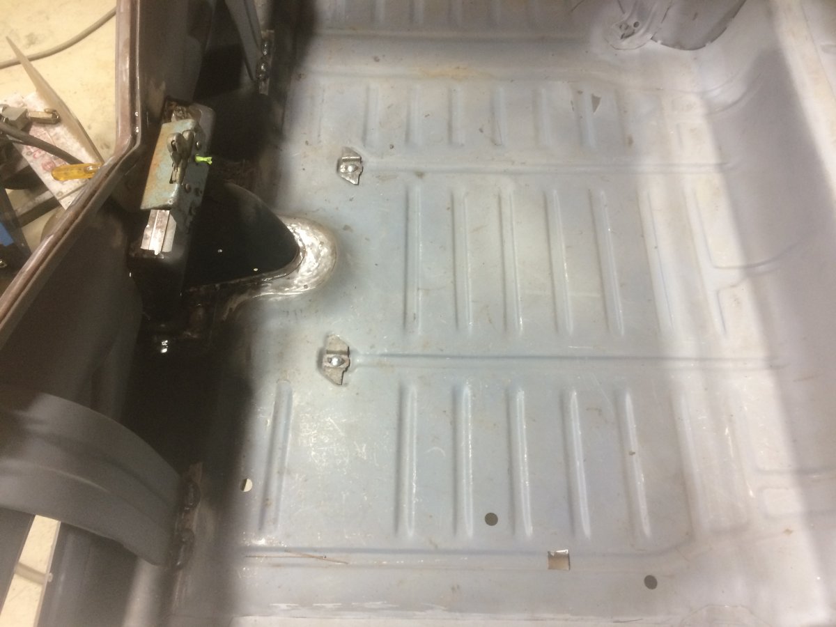

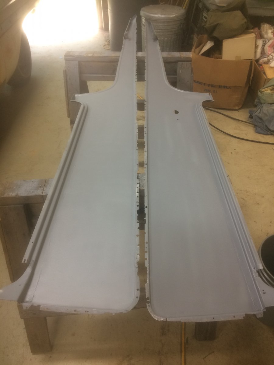

  11. Trunk floor looks a lot better now

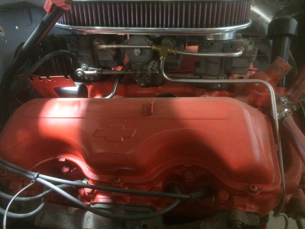

    here is an engine hint

    Try as I might, it's impossible to tell if there's a dipstick on the passenger side. The suspense...

    Fifth post in this thread says it's a 348.

  17. Can’t remember. It is a 59 block

    @anthony myrick -Don't want to de-rail this thread, but I have heard about those shrinking discs exploding. Wanted to try them but never have. What's your thoughts on them, and what kind do you use?
    Stogy and loudbang like this.
  22. I think it came from autobodytoolmart.com
    It is the flat version. I don’t think it works as quickly the wavy versions.
    I prefer the sun chaser version better but it works ok.
    chryslerfan55, Stogy and belair like this.

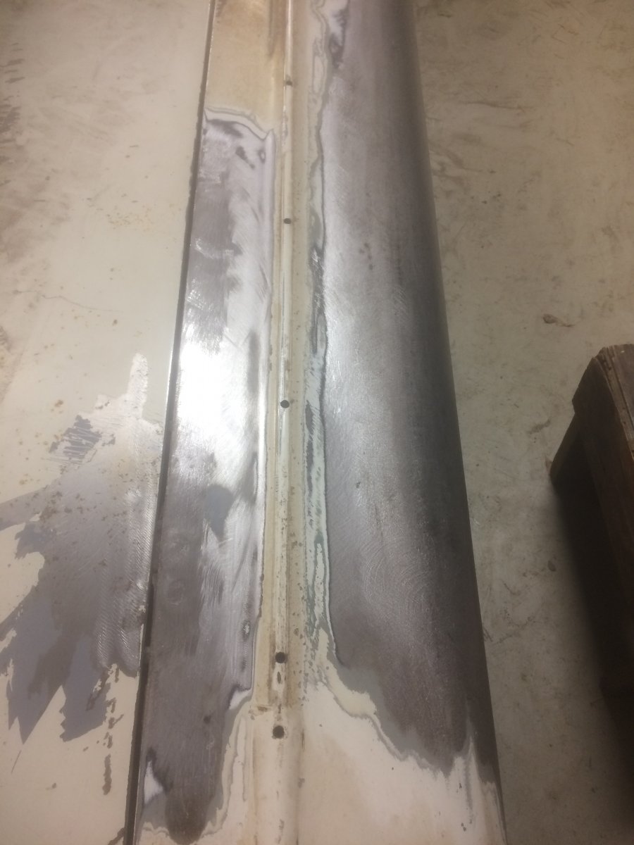

    The front sheet metal was s lot better than the rest. This is the worst spot on the front
    The styl line was all Bondo and below it was some serious balll peen hammer pounding. I lot of shrinking and dolly work later and it will have a lot less of that 1/2 inch of filler
    Still needs a little more. But very close. The rust colored areas is from the cracked bondo and will be blasted

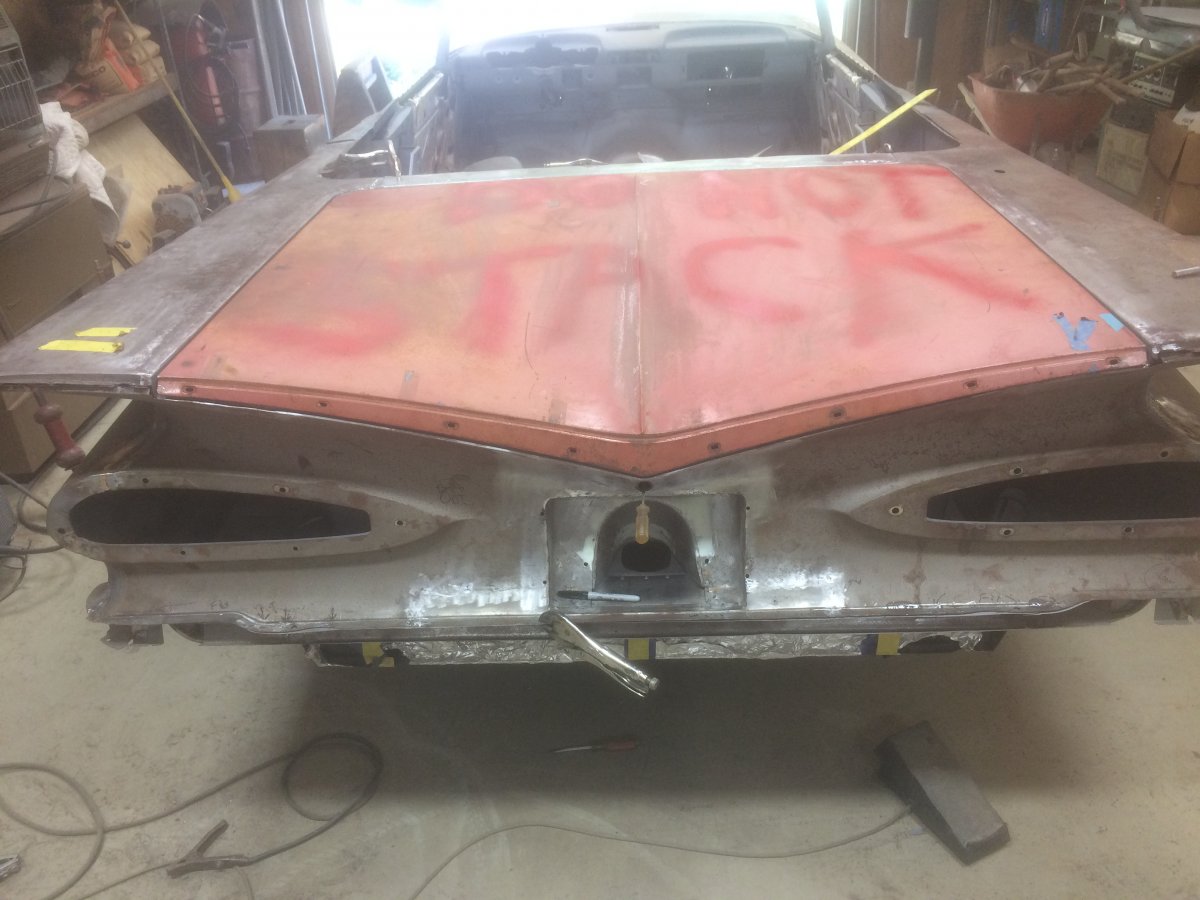

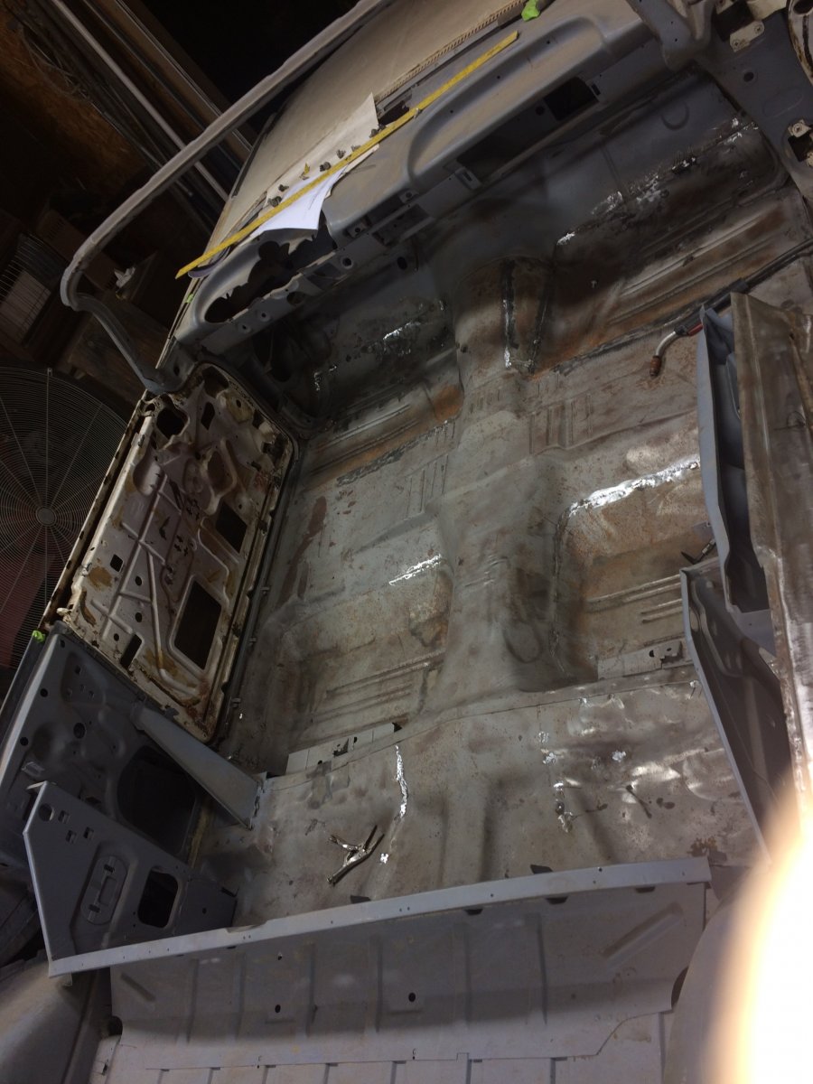

  24. Milestone tonight
    The major work is done
    Time for the owner to fit his AC then back on the rotisserie to refinish the bottom of the car
    This one got all 6 avalible floor patches fit and but welded in place. These were the first pieces I put in but finished up the welding tonight where I couldn’t when the braces were installed due to it being on a rotisserie in the beginning plus I like finishing things while bolted to its chassis.

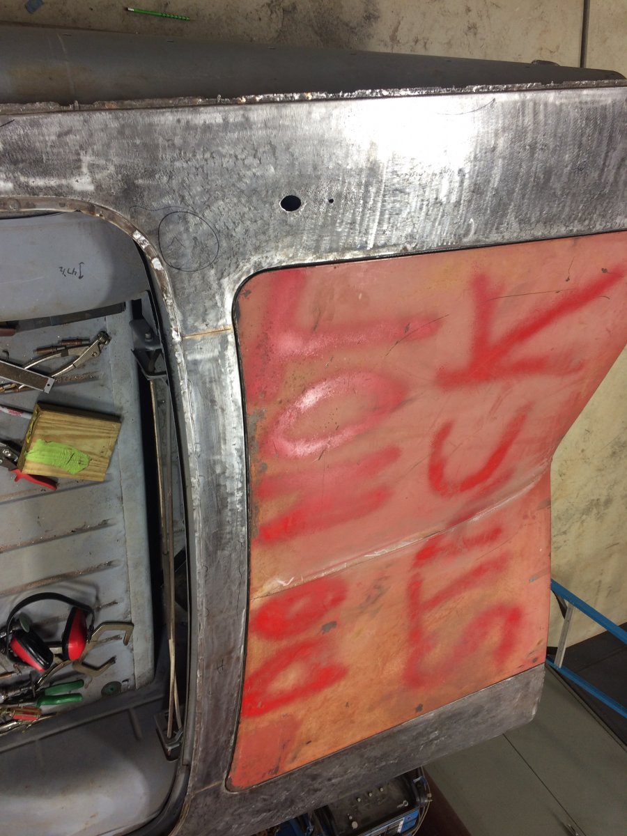

  25. Also fixed where the truck horns used to be
    Apparently this car sported a pair of big truck horns at one time
