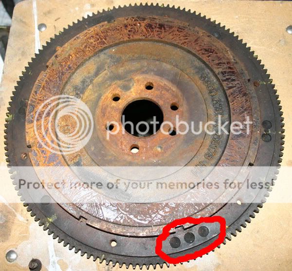

    If you have an internal (or neutral) balance flywheel, you can also drill it to make it an external balance flywheel, like so...

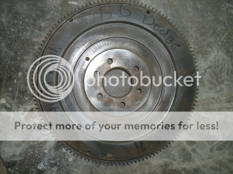

    You can do this yourself, but a machinist would probably be a better choice. Its pretty simple, but you need to be precise. You also need to make sure you actually have a neutral balance flywheel to start with.
    This is a neutral balance, 130 tooth flywheel for a forged crank 318 or 340. All the holes in the outer part of the flywheel go all the way through.
    Typically (but not always) an external balance flywheel will have a pattern of 3 holes drilled next to each other, partially into the flywheel. But obviously one modified using the template above will only have 1. This is an external balance flywheel (although this is a 143 tooth flywheel, for big blocks (383, 440, etc) or trucks with a granny 4 speed).

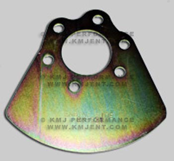

    KMJ sells a plate that fits between the crank and the flywheel to provide an external balance, allowing you to use a neutral balance flywheel (which I am now almost completely positive is what you have). The neutral balance fly does nothing for the engine balance, and the plate provides the external balance you need for the 360.
    http://www.kmjent.com/cart/product.php?productid=2077
    Now, that said- I haven't ever used one, or done business with this company before. But for 17.95, I'd say its worth a try.
    Searching on Moparts is where I came up with this. I also ran into a few folks that claim to have sandwiched a 360 flex plate between the crank and flywheel, which if you could make it fit would also solve your balance issue. The KMJ plate seems like a more elegant solution (definitely smaller). But again, this is all internet research, I'm not going to say that any of it works for sure.
