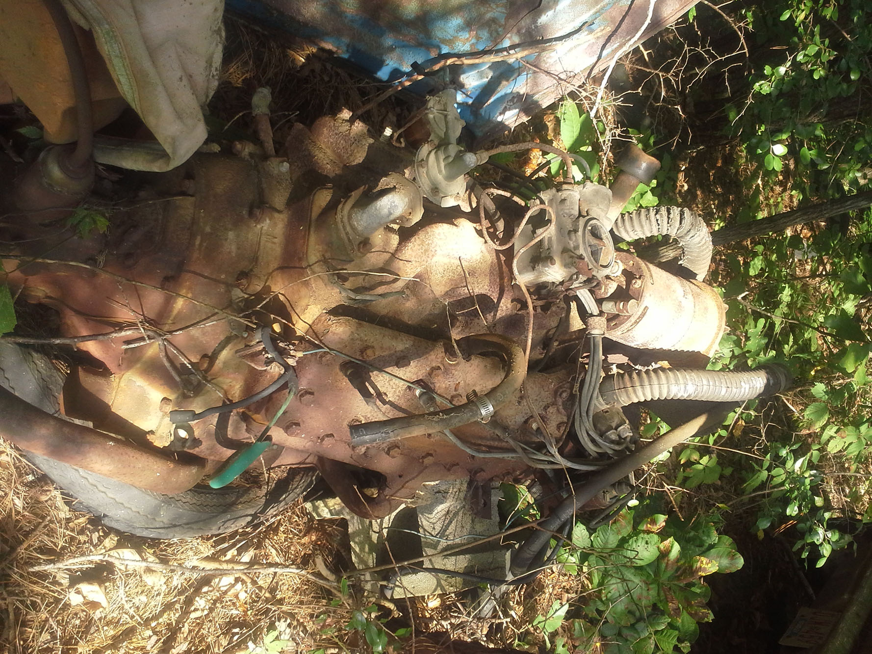

  1. I have a 1950 ford custom and I would like to put a merc motor in it for the extra horse power. That is the way I have it figured in my head anyway. I found a motor that a man has had setting in his yard since 1971. It has been covered but still I worry. I know it will need to be gone through even though the man said it ran fine when he sat it there. I need opinions on this motor, what it is and what it might be worth. what will I need to do to keep my 3 speed w/od trans. I believe it is a 1952-3 motor it is stamped EAC A29 2 on the heads also says Mercury usa on the heads. I am being serious about this and need some real answers. Thanks in advance, Jim
  2. anything that has been sitting outdoors since the 70's should be rebuilt..although it has value and I would like to snatch it up --you would have to consider it a core....I purchased a 51 merc car one time, it ran good but the block was cracked, you won't know what you have until you open the engine up! my 2cents

    It last ran 43 years ago. It has been open to the air through the carb & crankcase vent all this time.
    It will need a complete rebuild as most of the inside will be rusty. It'll be a miracle if it comes apart without snapping any bolts & you know what that means.
    The oil will have turned to acidic sludge & etched the metal mercilessly.
    Hopefully you won't need expensive crank repair or cylinder sleeving, but I'd provide for that in the budget if you buy this engine.
  4. taking it apart is probably the worst part of it. I have seen threads on the hamb where guys have twisted half the bolts off just tearing it down not to mention getting the pistons and lifters out. I am figuring on lots of trouble. Just dont know what it,s worth or if there is a better deal somewhere else

    If it cannot be turned with a wrench on the front crank bolt (7/8" socket), and I'll bet money that it can't...you are facing a hard job at best. It is also quite likely, regardless of cover, that it has gotten in enough water to crack from freezing.
    Consider it junk until you have it completely stripped and have verified block is savable!
    If it is indeed a Merc (heads could be on any flathead block) there is a very good chance cam and crankshaft, the significant differences between your Ford motor and a Merc, are savable so you can just build your block into a Merc.
    I would STRONGLY advise against paying much...it is almost certainly rusted to the point it will need complete overhaul, and I would consider it to be cracked until PROVEN otherwise. Outside storage for any length of time is usually a disaster.

    100 dollar bill or less seems fair to me as the trans, bellhousings and nick knack housings are worth something. Trouble is, most old farts think this stuff is gold. In old fart world, he may actually believe all it needs is a splash of gas and a battery.
    It could simply be a 239 with Mercury heads. Like Mine:rolleyes:
    If your car has a 239 or even the 226, I'd enjoy it for what it is. Now compared to a 60s era hot rods/factory muscle the flat heads were not much. Compared to a 50 stovebolt Chevy, The Ford is a race car.
    They are what they are and remember what era performance really was.

  11. What should you pay? I wouldnt pay more than $300., that'd because the parts off the engine are worth it!

    The only components in the Merc that are different are the crankshaft, pistons, intake manifold and carburetor, which can all be swapped into your 239 Ford engine to turn it into a 255 Merc engine (keep the smaller Ford heads for better compression, regardless of the "status" EAC badge). Oh, the EAC has the best stock flathead cam, too.
    Moneywise? As cheap as you can for a yard-find that's been in the weather for 40+ years. That's not an engine anymore, it's a chunk of scrap iron.

    This motors last home obviously wasnt a mercury as its got the torque tube drive.
    unless you need a bunch of frustration I would heed others advise and resist temptation . Freshen what you have .

    The engine you are looking at MIGHT be a good crank donor for future reference. After decades outside, it is certainly not a runner without total rebuild, and it is VERY likely block is scrap. There is however a good chance its crank is savable.

    i agree--you don't know what you're getting with that old mill. i've bought merc engines that were cracked in the main webs, through valve seats and cylinder walls. even "rescued" one which had sat so long with water in it that it was rusting through from inside the decks--and that wasn't worth fixing.

    I pieced a flathead engine together from two older engines that had been sitting and I can tell you it was alot of work. I guess it was a good experience, but I am not sure I would do it again. You can find the things you need "on sale" so to speak if you are patient, and often they are in better shape that an old rust pile.
    As far as your plans, I would do the distributor conversion and see how that goes. Bubba is a great guy to deal with and does a great job on the distributors.
    Then search the classifieds for the crank and other merc parts. You can compare the cost of buying known good parts that way versus taking a gamble on what is pictured above. My .02 is that is worth about $200.

    Back to the original question, if the "Merc" engine is really a Merc, the 4" crank alone is worth at least $250 all day long. And you could scrap the rest if it's a rusty cracked up mess. Put the Merc crank in your current block, a new set of pistons, and you have a "Merc" engine. You'll need to pull the pan or head to verify it's a 4" crank though.
