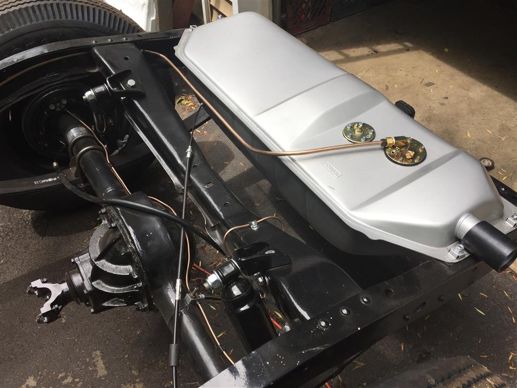

    Brake lines ran.
    Fuel lines ran.
    Gas tank installed.
    Rear shocks installed.
    Motor mounts installed.

  24. typo41
    Joined: Jul 8, 2011
    Posts: 2,571
    typo41
    Did I miss something, is this a modified tank or a new one??
    neilswheels likes this.
  25. the-rodster
    Joined: Jul 2, 2003
    Posts: 6,945
    the-rodster
    Brand new.
    I just couldn't get all the rust out of the stock tank, and a new one
    was only 199 bucks.
    Rich
    Dan Hay likes this.
