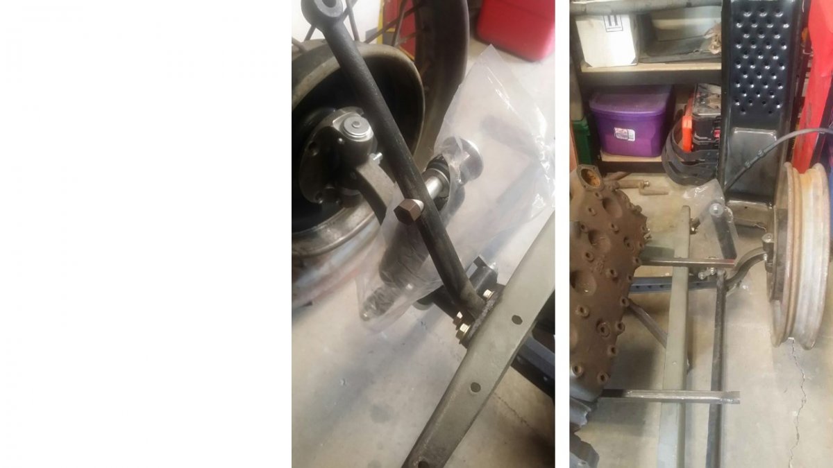

    Wish I would have saw this sooner. Had a similar idea that now seems to be more work, but same concept. Slide50.JPG Slide54.JPG
