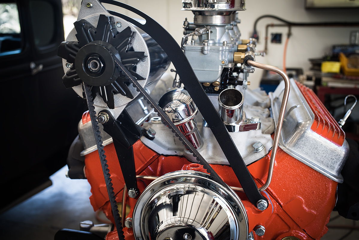

  1. This is such a fun little hot rod project! You guys took a little different approach than Bob did with mine. Curious about your reasoning to run the powergen on the passenger side. Looks great there! I'm running a water pump riser because i didn't want to raise the engine resulting in a hump in the floor pan. I don't think you've shown the engine mocked up, maybe I missed it. Will you have to clearance the floors? Did you guys consider a riser? Just curious of the thought process and result. Looking good!

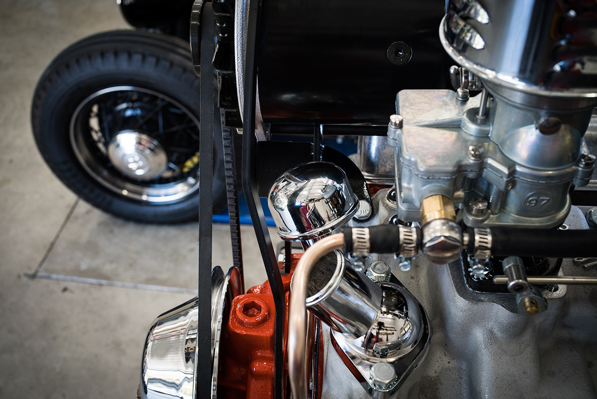

    Ok... oil fill... Took the simple approach... just cut her down and stick her on. Hard to tell from the photos, but there is plenty of hand room in there to get the cap off. A funnel is required for filling though. Looks clean. Simple.
  3. slowmotion
    Joined: Nov 21, 2011
    Posts: 3,553
    slowmotion
    I was wonderin' about the oil tube. Good, clean solution.

    You guys are way braver than me. I have a similar alternator unit (not PowerGen) and tried to simply run a thickwall tube to the rear mount and felt like it was definitely not strong enough so I made a support down to one of the intake bolts. A simple addition that adds a ton of piece of mind.

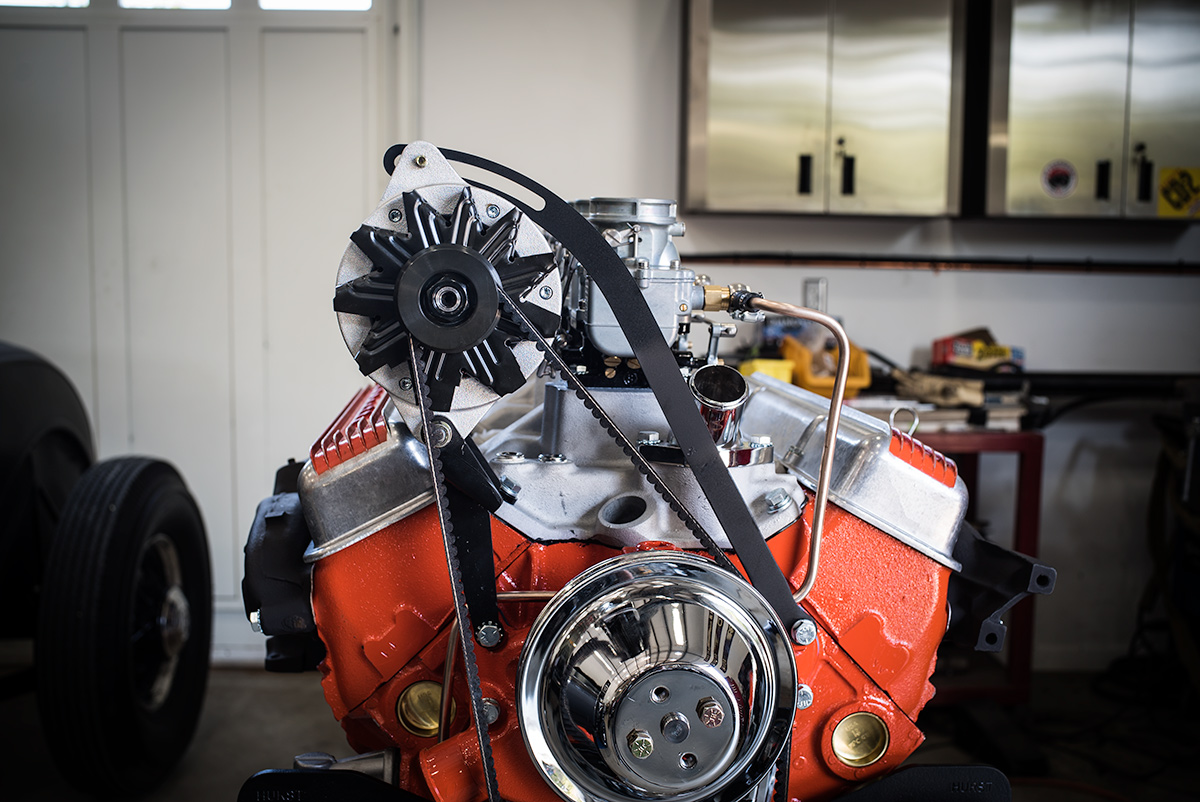

    Great looking 327!! My favorite engine. I have cut down the oil fill on several as well-looks great. As to the road draft tube you can get the fitting that takes a hose instead-they are designed for an inline PVC. Always have to do this for firewall clearance on 40's, Love the build-Keith is a wizard!!
