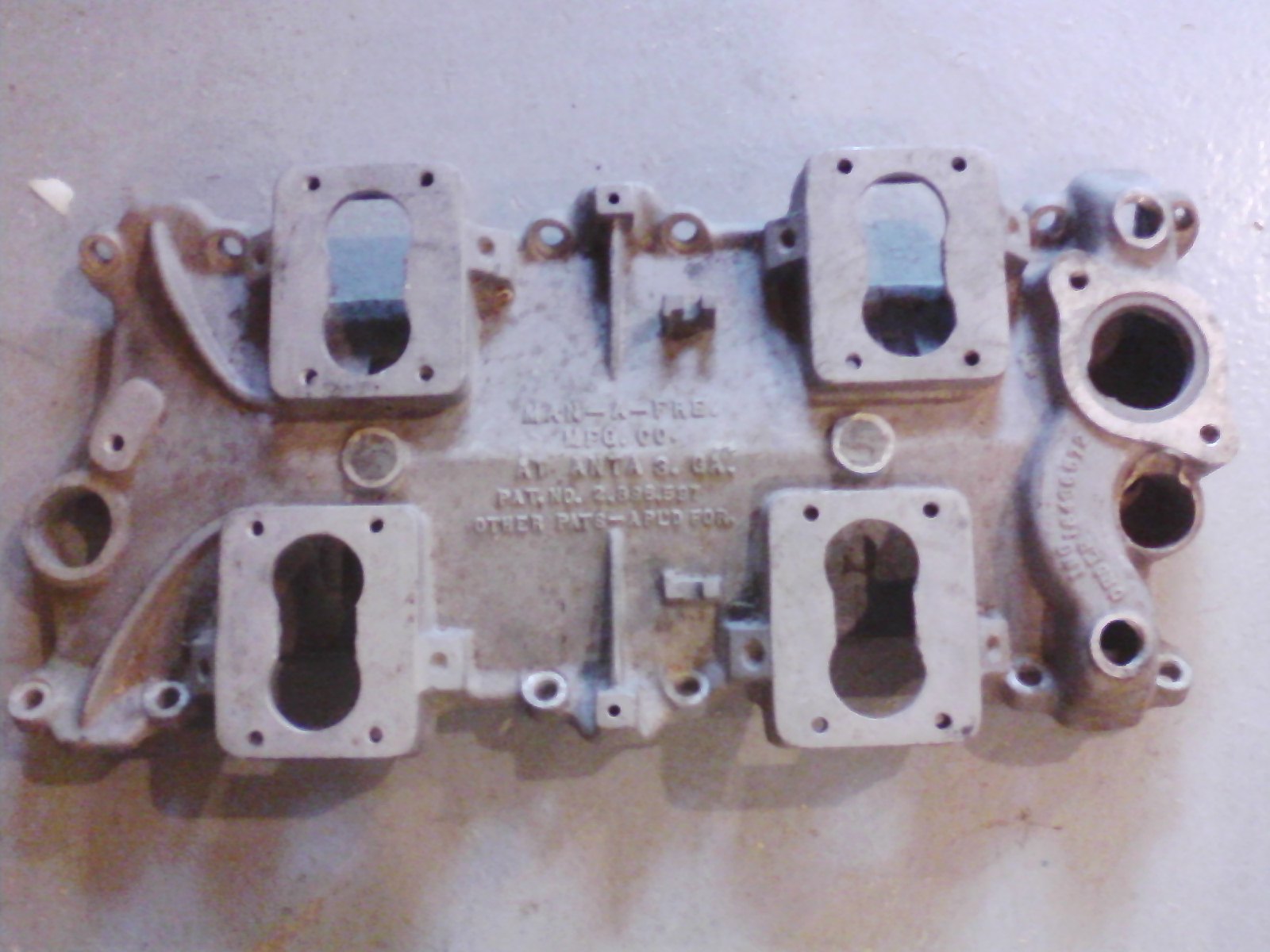

    Taking apart the heads so I can clean them up and start porting. Went to my dads to get the spring compressor and burrs. Was thinking about carb/manifold I should run. I was going to use my Torker and 650 holley I have but I forgot this was on the shelf. Should I talk my dad out of it ? Before he retired a guy gave it to him because he said it needed a good home. It has never been put on an engine ! It is the better one with the pre-marked bosses for fuel injectors.

  22. I would not sell it too tough to replace, save it for now, maybe once motor is broken in and running nice, swap it on!

    As long as the ports on the Man-A-Free intake are't too large, use it. I believe it will have the ports "combined", without a separator wall between them. Port match the heads to the intake, it probably won't work the other way around (port matching the intake to the heads). Shades of American Graffiti, that's the intake used on Milners Yellow Coupe. Butch/56sedandelivery.

    I agree with the get it running and then swap it out. It will take me a while to drum up all the carbs and parts. I am glad you said to match ports that way 56sedandelivery. I was going to ask just that question. I also wondered, what will happen with the intake gasket since there won't be a piece of metal pressed on it. Will it be ok ? does it need a little silicone under neath it to keep it from coming off and going down an in the heads ?

    Heat crossover? Don't worry about it. The stock gaskets will have a separation between ports, while the Man-A-Free has each of two ports combined into one (the entire intake is just one big single plenum manifold); just remove the separation from the gaskets with a sharp chisel and hammer on a block of hardwood. I think that's what you're asking? Use as small 2 barrel Rochesters as you can find ("some" tri-five 2 barrels were actually Carters). How well will a 265 handle 4 times as much carburetion as it was intended for? I do like that intake. Butch/56sedandelivery.
