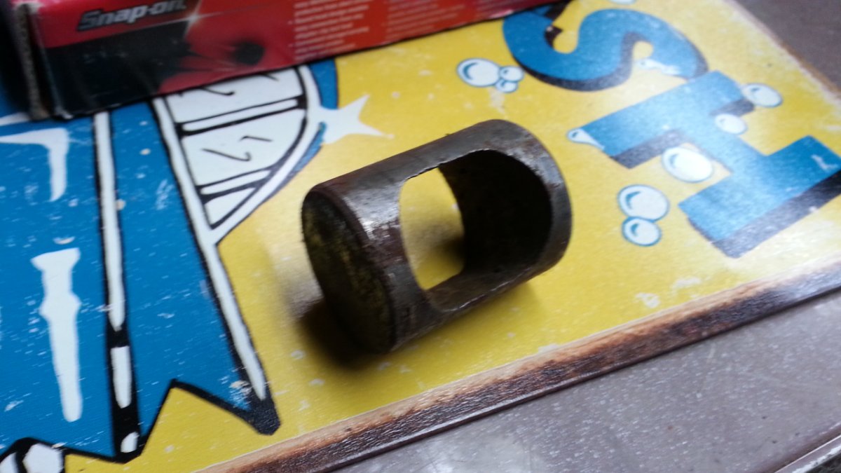

    If you have one of these in the center of your diff or spool you can still use your adjuster.
    Those green bearings are costly.
