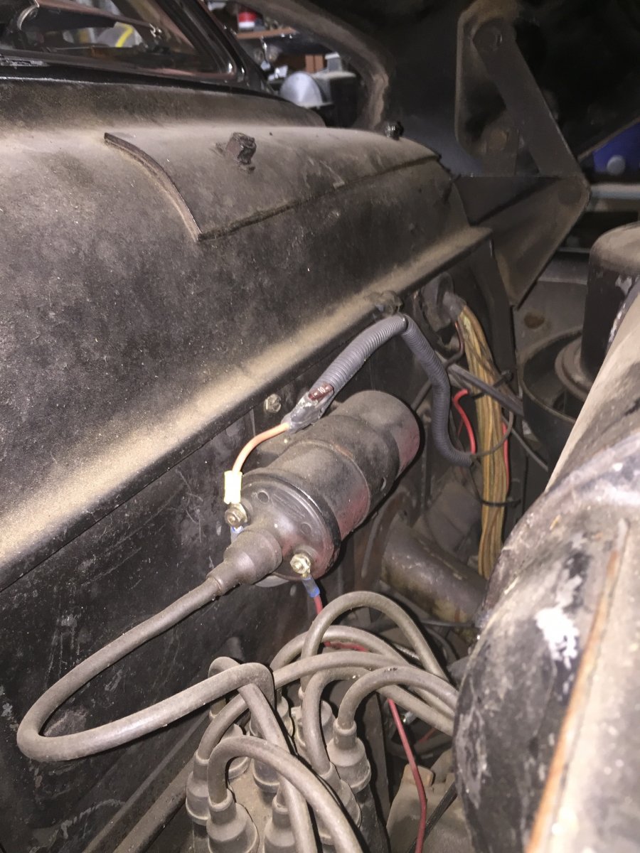

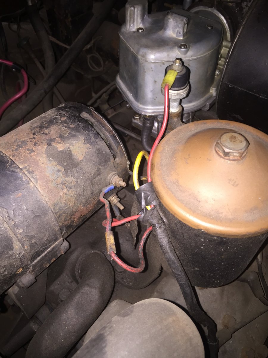

    There are some added wires, I had assumed he hadn't just replaced them because the wires were worn but maybe he converted it to negative ground then.
  8. Which side of the coil has the power wire to it? (Not the one that goes to the Distributor)?
